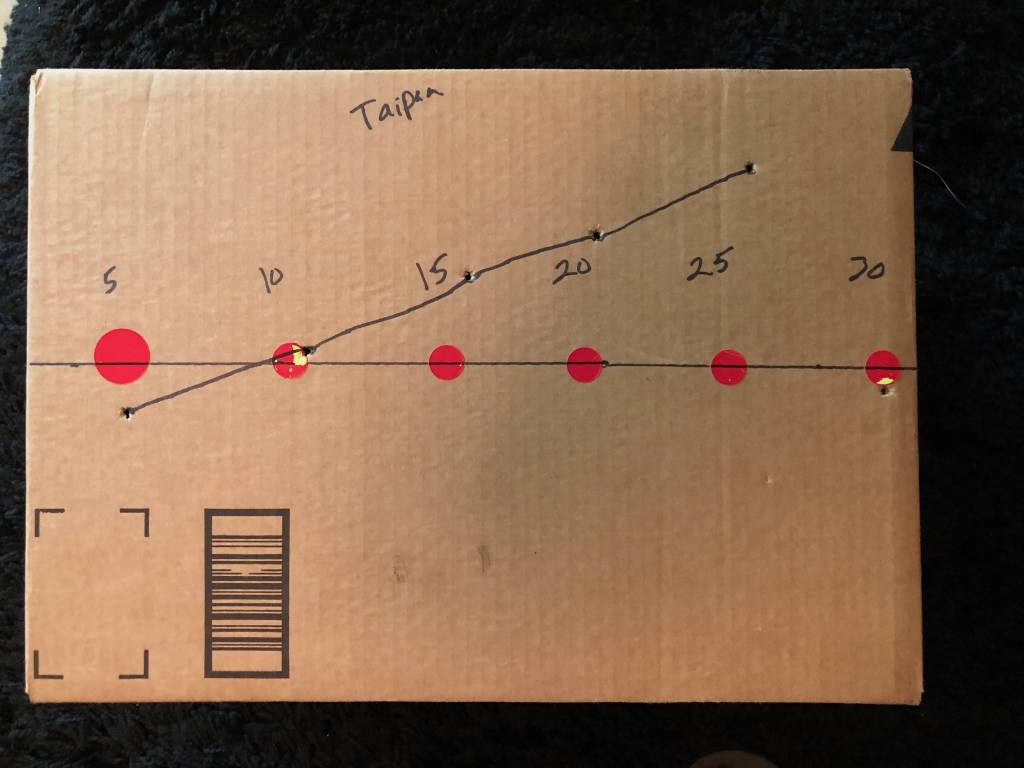

(attached pictures for reference of the shot trajectory at close ranges)
(@25 yards the shot is 4 inches off from where I aimed)

What is the orientation of the target pictured? With a 10 yard zero, assuming an 18 grain pellet at 880 fps, you should be really high at 25 and 30 yards. A 10 yard zero is really not practical. Zero at 20, it will hit a little low at closer range, but will be relatively flat out to 35 or so. I don't shoot much beyond 50 yards, and I find a 20-22 yard zero about perfect in most rifles.
Thanks a lot! Sorry I fixed the uploaded picture to be the correct orientation. In that picture the shot is off by 4 inches @ 25 yards (I was aiming at the red dot below). I will try doing what you said and zero at 20-22 yards before I mess with the adjustable scope mounts

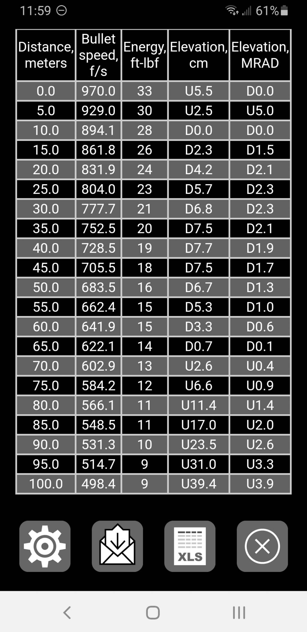

Assuming your scope height is similar to what my Veteran was with medium rings..about2.4”.. when you zero at such a close distance, it’s the same as if you were to zero for a really long distance..like 85 yards.
If you take the advice above to zero at 20 yards that will put you really close to a good spot
If you sight in to be about 1” low at 10 yards, you will be within -0.3 at 15 yards and +0.3 at 33 yards and -0.3 again at 46 yards so your “hit window” of 0.6” covers roughly 30 yards
Having the same platform gun (Taipan Veteran long), I entered your zero distance data in Strelok Pro and the chart it generated almost completely match your off shots at 5, 15, 20, and 25 yards. Obviously I'm just eyeballing the measurements from your photos but it looks close. I can't confirm your 30 yards hole because I have no idea what power your gun is shooting at.
Please note the chart is in meters. I know you use yards but I didn't really want to change the application settings just for this quick check. Focus your attention on the column "Elevation, cm".
