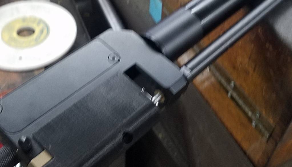

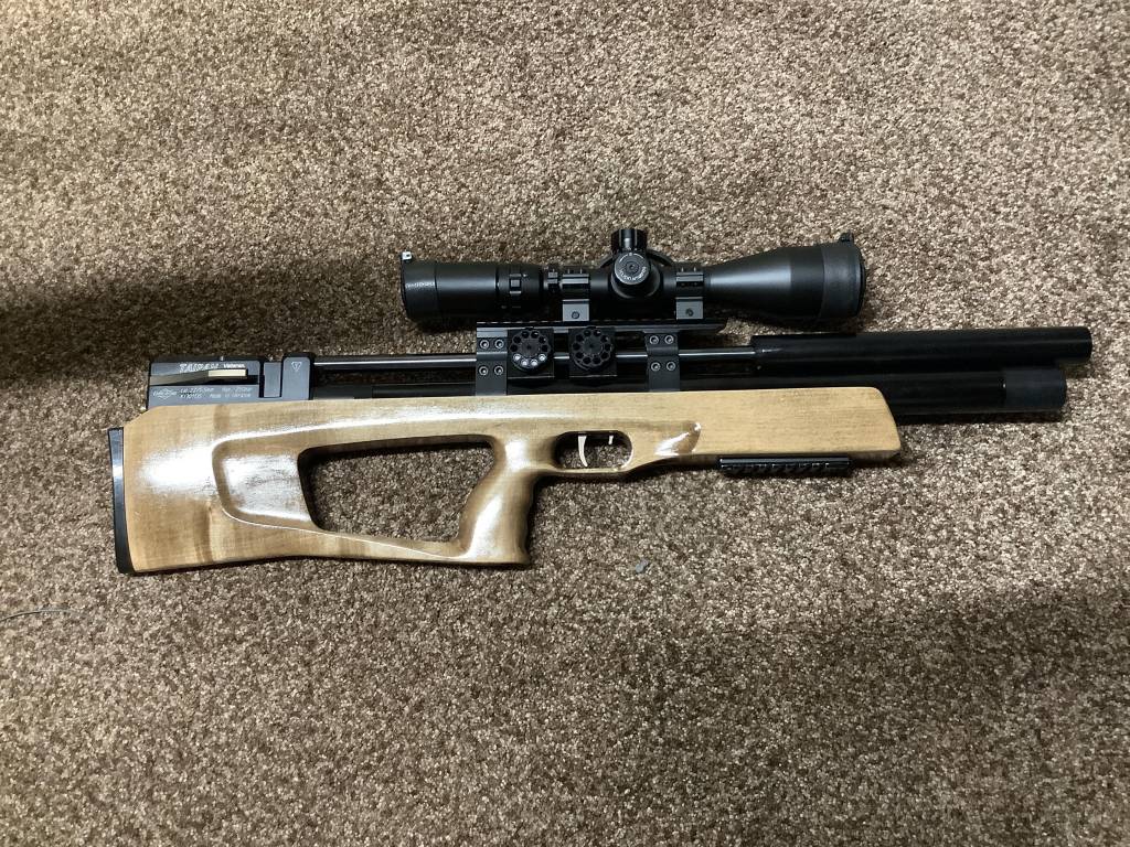

I have a new Taipan Veteran standard in .22 that I added the Huma Reg and Power Plenum extension to it.
Well I was able to add the Huma Reg, and not the power plenum, as I try to screw it into the back of my air tube, it locks up. I know not to force things, I was told by a member that they had to use a strap wrench at one time, but this is locking in hard, and I'm positive the strap wrench would do more harm than good. So I ordered another power plenum from 910 this time, and first thing I did was to screw one into the backside of the other. This shows no issue with the threads, or size of the dia. at the front. Both of these would screw onto my receiver block, where my air tube fastens, but once again, neither of these Plenums would screw onto my air tube. The 910 was .001 larger than the previous plenum, but when I measured the same area on the part on the receiver it was the same size.

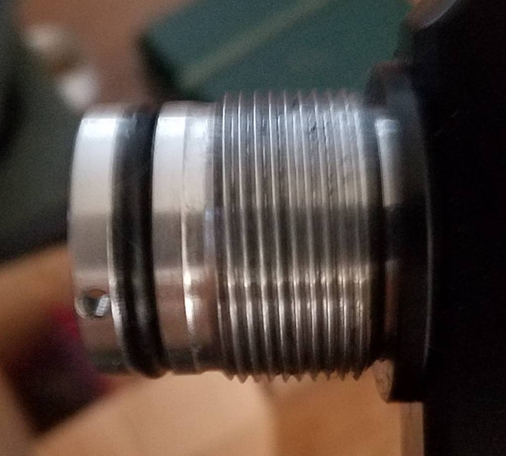

NEW Discovery, The threaded portion which is mounted to the receiver, right between the back side of the o ring and the start of the threads, there is a relief groove, which is where my tube is binding with the new plenum extensions. Apparently when the machine the threads, there is some stock being left at the front part of the threads, not allowing them to screw into my tube.

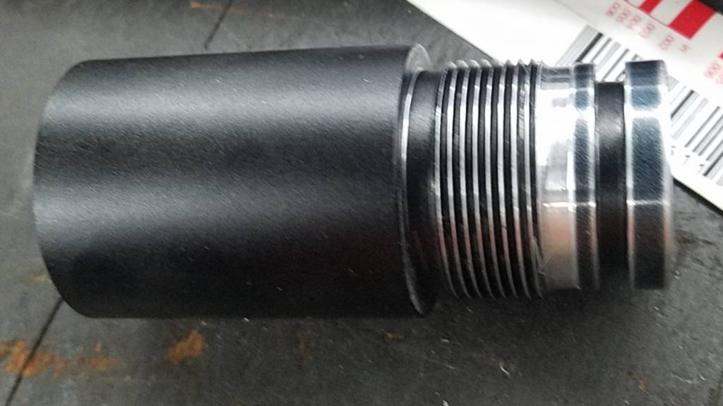

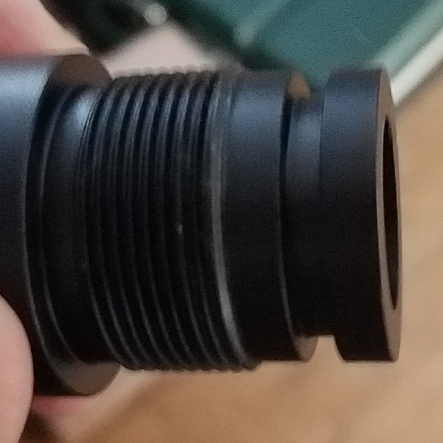

This is what I had to do to my Stock plenum from 910 Air Guns, and the same thing I did to the one from Talon Tunes. The relief slot did not solve my problems, it only made it more obvious what the real issue was. If I measured my Air tube, where the plenum screws in, I found it to be smaller than the back side of the plenum that screws on to my valve body. By .005 P/S. or .010 total. This is a lot and makes threading them together easy. I ended up polishing down the threads with a piece of fine wet or dry paper, you will also notice I had to hit the main body dia. and put a nice radius on the front corner. It's important to take a small sharp file that will allow you to clean up the threads after you polish them down and add the clearance slot. Loose shards of the aluminum will only cause more problems if you try screwing them together before getting things cleaned up. I had adjusted the length of the spacer tube for my new Huma Regulator, without the plenum, now that I could screw the plenum on, I had to remove even more stock, than if it was just being screwed back on the Valve body. Ernest comments on this procedure in one of his videos. I now have my Veteran back together, and have fired a few magazines through it, I have to get my Chrono out, and see where things are at. But for now it sounds great, and I need to get my barrel shroud extended 5/8 to 3/4 of an inch , so its slightly ahead of my air tube.
