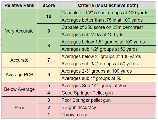

Accuracy: Most of my opinions of a rifle start and end with accuracy, which is why I award 10 points to the category in the chart above. After extensive testing the compact has proven to have above average shot range accuracy (out to 50 yards) but average accuracy at greater distances (100 yards).
25m Bench results: The compact averages a 25m benchrest card score in the 230s. This is good enough for the close range pesting I bought the rifle for, but is not the hole-in-hole accuracy of the Veteran Long .22 I had hoped for.
50 yard Bench results: When shooting groups out to 50 yards, the compact can manage sub 1/2" groups but averages 7/8" groups. I didn't buy the gun to shoot at 100 yards and don't have enough data to make a valid conclusion for accuracy at that distance. 50 yard results give the gun an accuracy score of 6.
