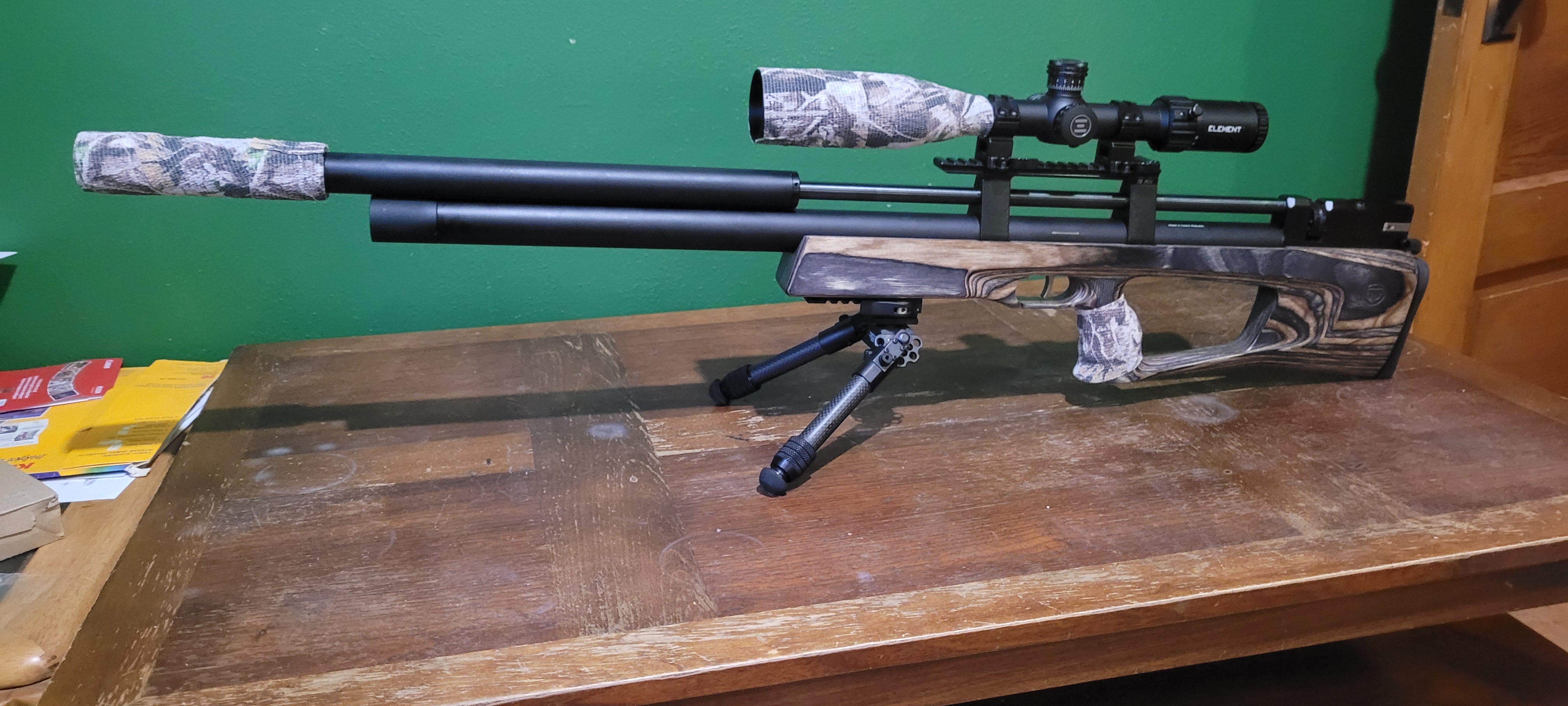

I'm working towards building a dedicated .22 slug gun out of my Veteran Taipan Long. There is a 700mm CZ barrel available from Talon Tunes that looks like it might be the ticket for flinging 25 grain slugs around 950 fps. I'm curious if people have experience with this barrel and how it has performed? It seems really long but I guess that gives me more fpe potential.
I have that barrel on my Taipan veteran long. It shoots the 25 grain H&N slugs great at 930 fps and can shoot them faster if I want. Also have the power plenum on it.

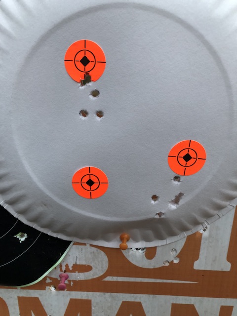

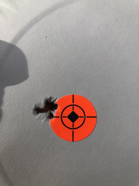

I just bought a vet 2 not the tactical with the 700mm barrel and only tried the JSB knockouts so far with the factory tune. They shot ok with factory tune. It came tuned from Utah for the JSB monster redesigneds 25.4 shooting 930. I shot two 5shot groups at 100yds with them at around 1”. The other group is 50yds and it shoots like that or better all day. Just got it last week so still playing with it. You can always get a vet 2:)
