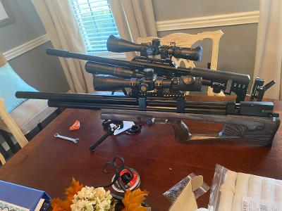

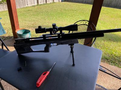

Got my .22 Taipan Vet long from TT Saturday. Pleasantly surprised. It is a lot quieter than I thought it would be, even without the Koi. I wasn't sure how I would like the rear cocking lever, but I got used to it after a mag or two. Here are a couple of pics. They don't do it justice.

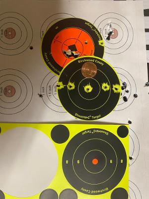

I have only been able to shoot it about 30yds so far. But it is dead on. Here is something different. Instead of showing a 5 shot group, I shot the numbers and bulleye of the target with five shots. I am not the greatest of shots either.
