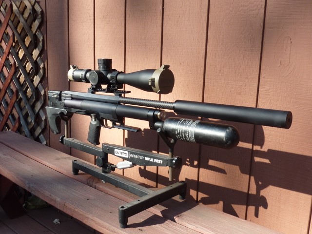

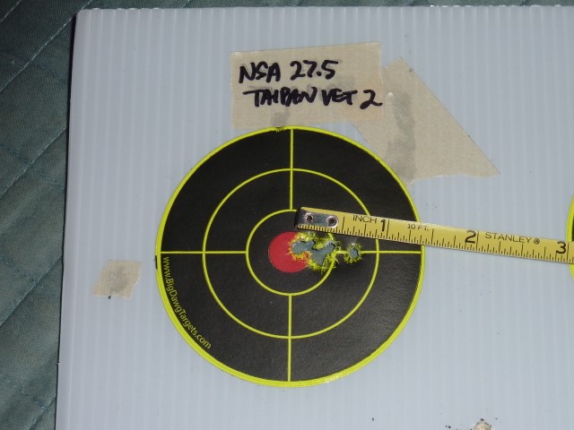

I have only had mine for a few months. So far I've had good luck with the NSA 27.5 slugs. It's definitely possible to get 1/2 inch or better groups at 50 yards. I had one shot I pulled to the right on this 50 yd. group and messed it up.

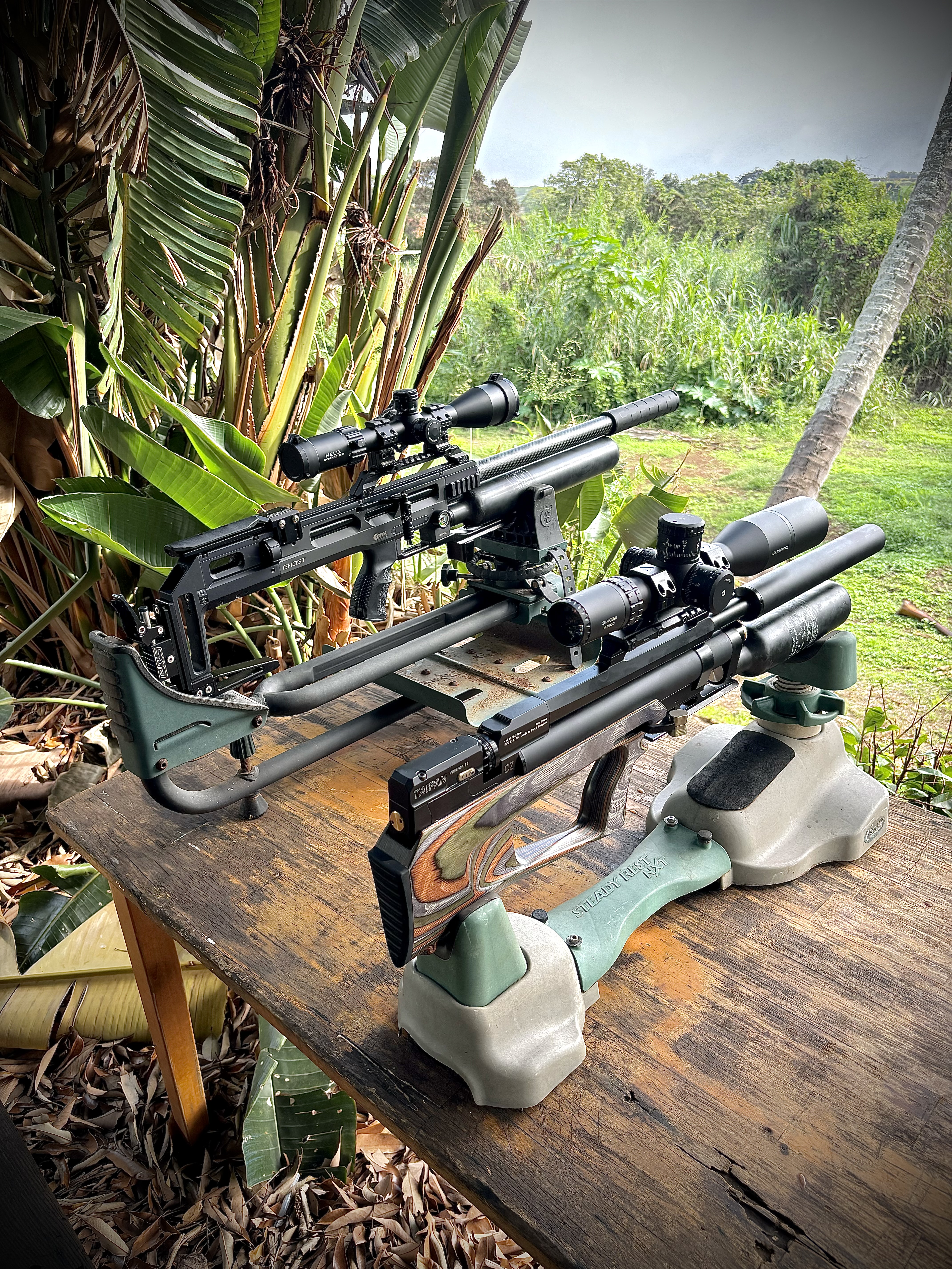

Sorry I’m not too sure how much power it gets but my BRKghost in 30 caliber hits hard up to 90 ft lbs. and my taipan veteran 2 hits just as hard! Super accurate, too

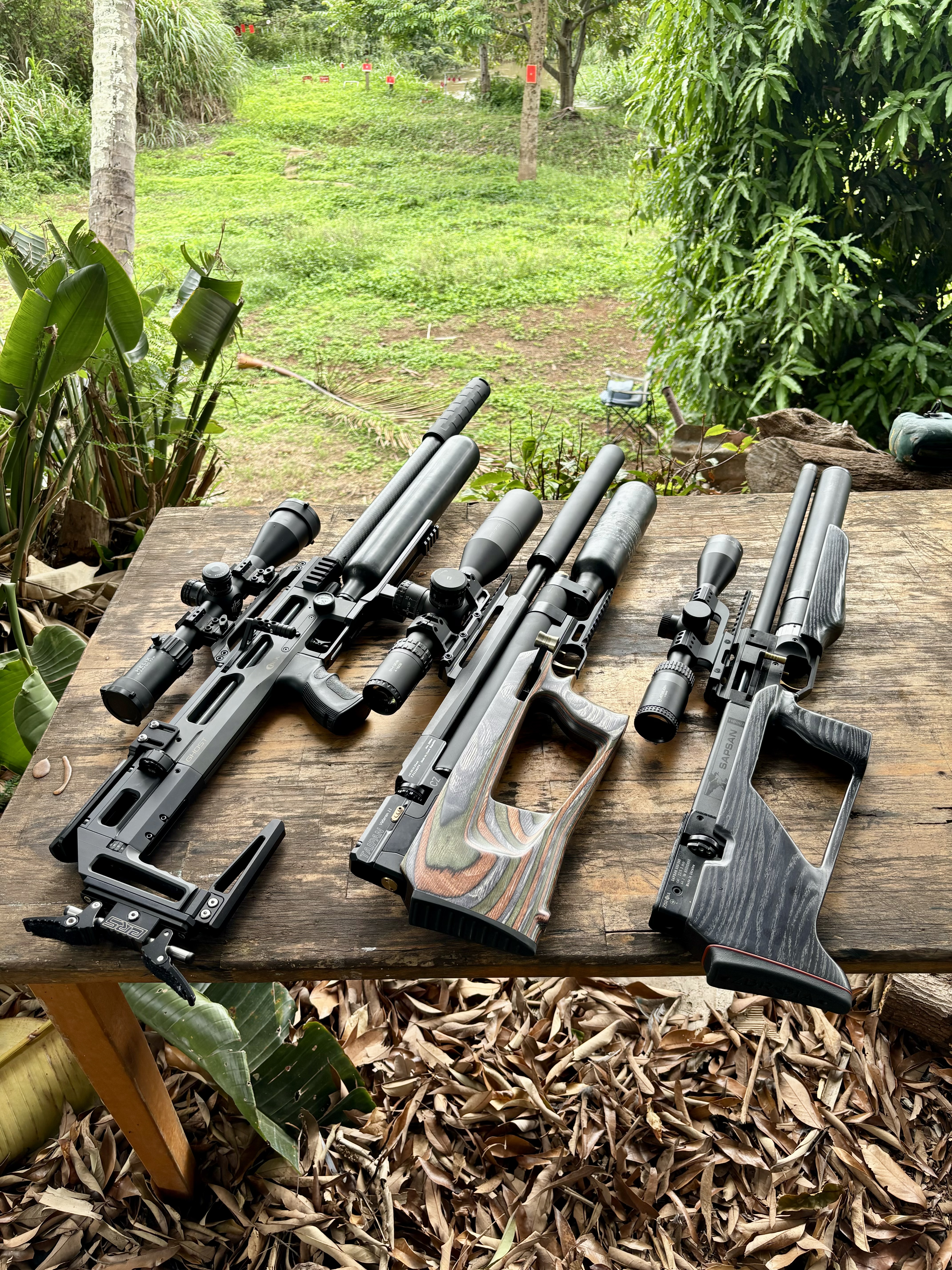

These are my two favorites, I can’t seem to choose which one is better, they both are very stunning rifles, and I can’t believe how accurate both of them are
Even 80 to 100 yards out not a problem with pest birds !!!

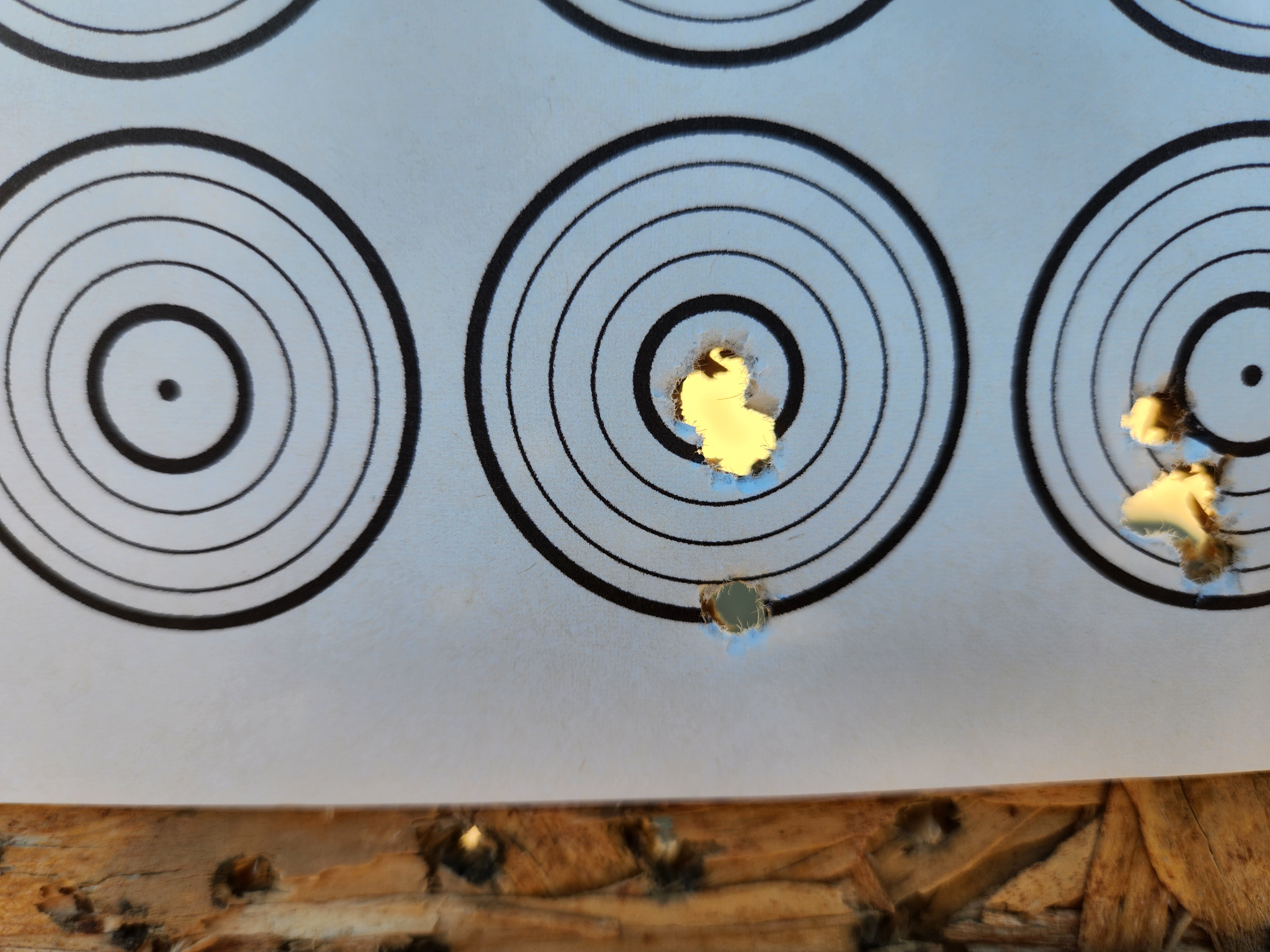

I've had it for two weeks and I still can't get it to shoot decently, I had acceptable results with jsb of 18.13 at 825 fps. I also shot some 25 grain slugs and the grouping was decent but not good.
