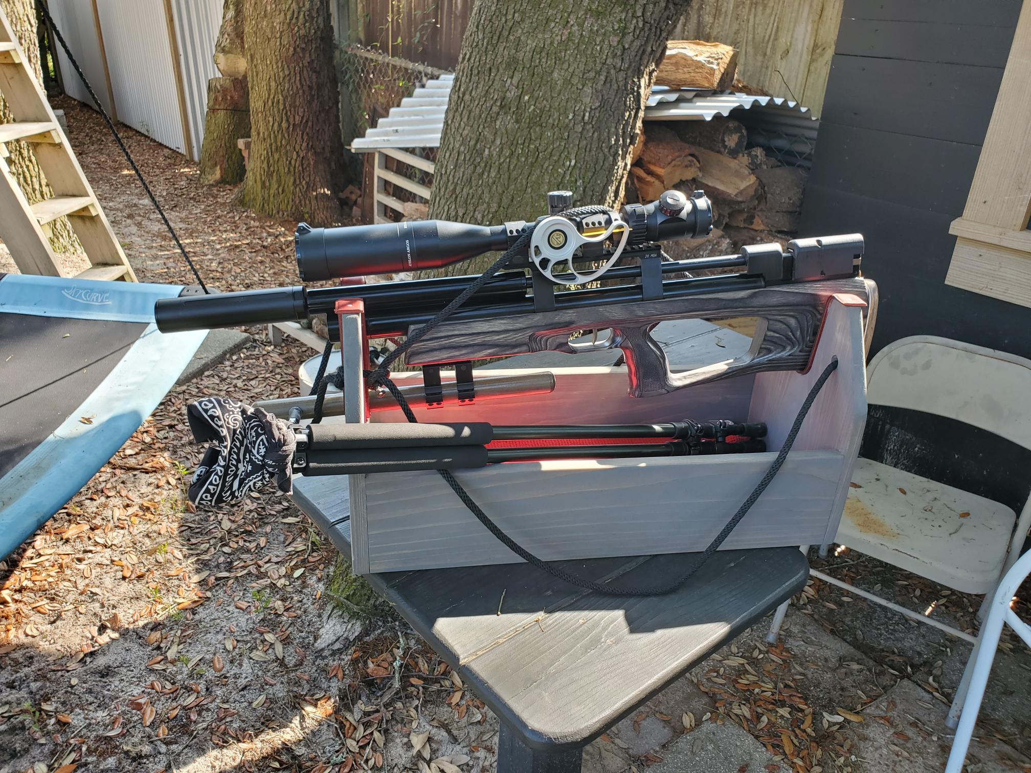

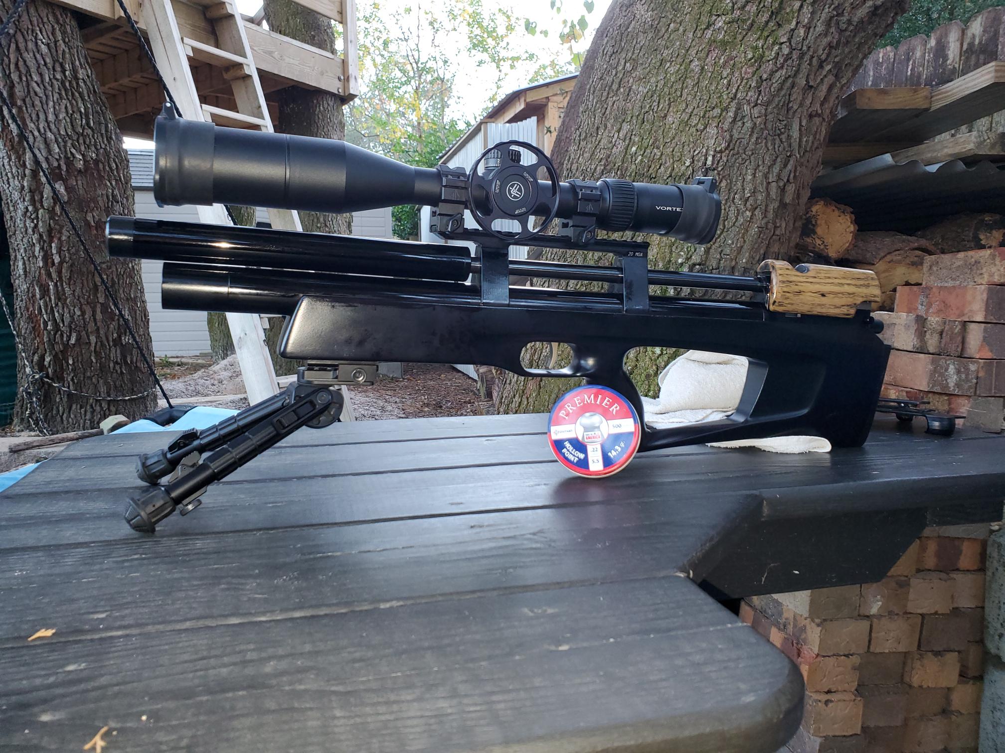

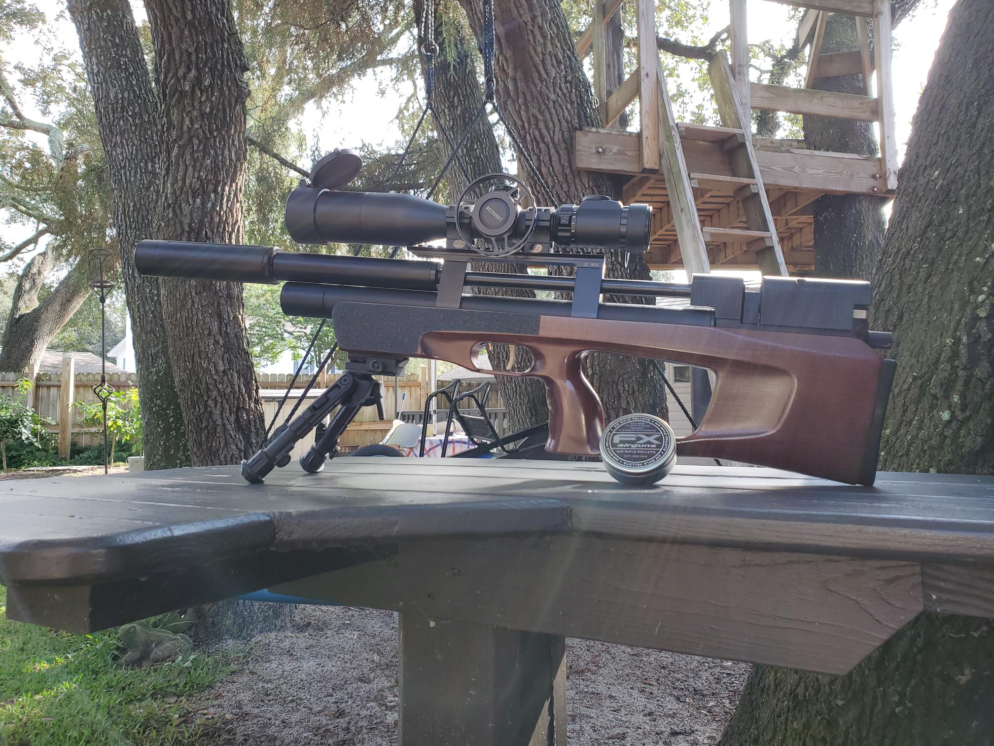

Would love to see a family picture of your Taipans :love:
Here is a family photo

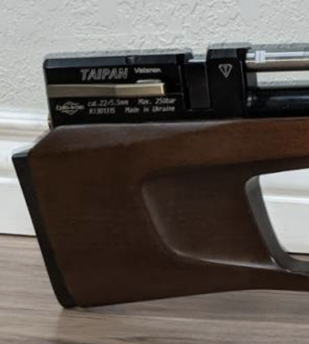

The Ukraine versus Czech-made Vets have very different breech block markings....(Sorry bout the blurry)
The two Vets that I purchased new are a Ukraine Shorty and a Czech Long, both in .22. Both of them had the factory reg pressure written in red marker on the reg itself. The years have fuzzied the memory, but I'm pretty sure the Short said 126 and the Long said 128 bar for the OEM reg pressures.
I converted a bought-used .22 Standard into a .177. It needed a Huma as the factory reg only performed when at higher settings. So the Huma is at 90ish bar for a .177 Standard @ 19fpe.
My best guess on when they switched to being made in Czech instead of Ukraine would be 2019. Also, as far as I know, all the Ukraine guns had black or brown stocks. The brown stocks from Ukraine didn't have any checkering nor the Taipan shield logo stamped into it like the brown Czech stocks have.
