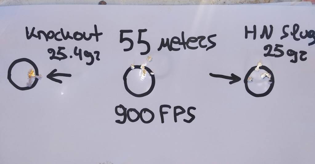

I used to have a taipan veteran long .22 it shoot slugs great if they were below 22g why barrel is tight lo anything longer than that it shoot horrible...that was until I decided to try boat tail slugs I tested some 28g and it shoot awesome but it was lacking of the power to push them at the ideal speed at that time they were no plenums available yet..boat tails are heavy but that design have less drag in the barrel...now I have a old standard .22 cricket it shoot great the 17.5 -- n 20g slugs..but since the knock outs are soft lead or at least softer than the NSA ..it shoot those great to..

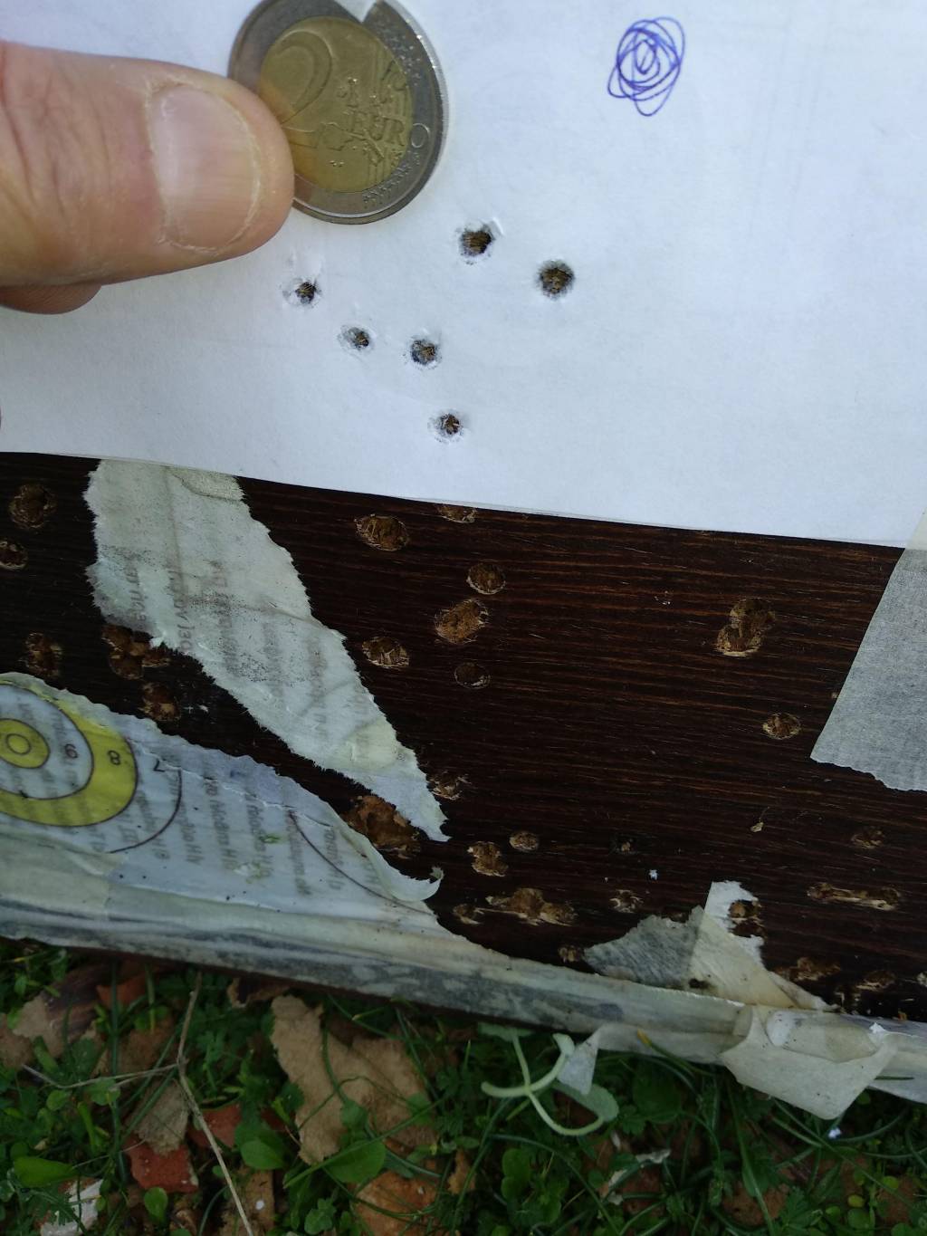

The speed is 800 NOT 900 fps
CZ barrel, Taipan Mutant 5.5, the good old one OEM use the same from CZ 200

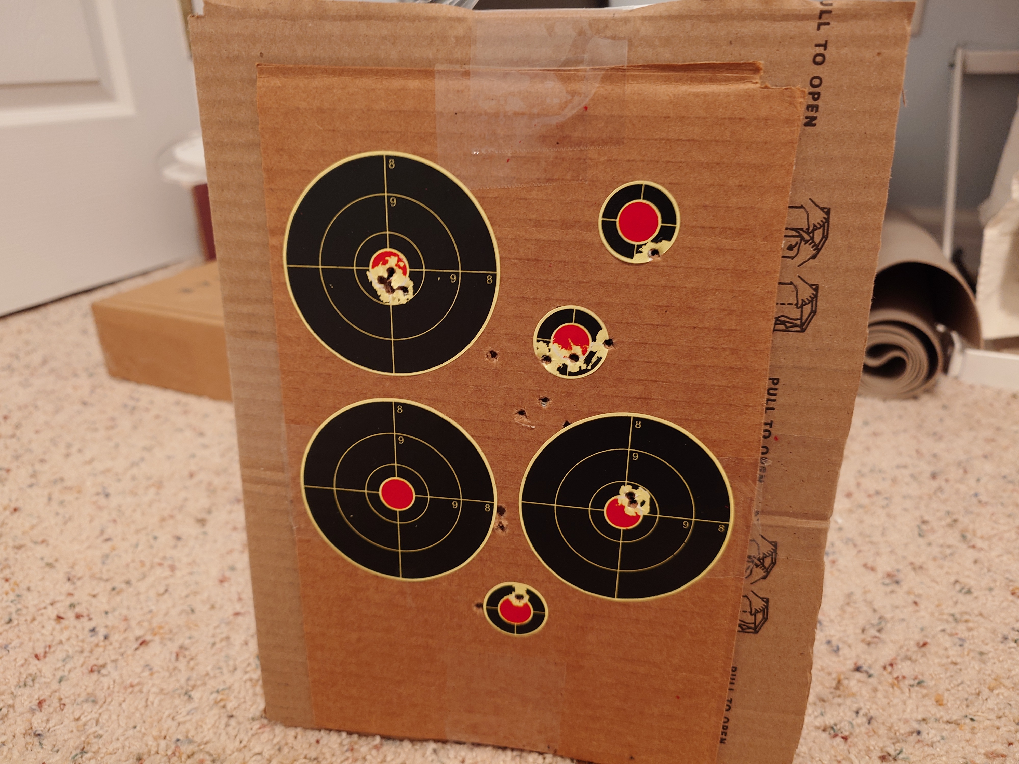

I went out tonight and zeroed the scope for the NSA 17.5gr .2165 caliber. This is with the Taipan Veteran Long with LW barrel. Distance is at 27 meters. The smaller targets are sighters. The big target on the top left is a 5 shot group measuring 0.265" center-to-center. The big target on the lower right is 2 shots 0.1 mil up from the other target. As you can see, my scope is in between clicks.
This session is 12 shots (FPS= 906, 899, 899, 900, 900, 900, 898, 902, 900, 901, 903, 900).
This was done outside, at night so there was no wind.
I must say that I'm quite happy with the performance of this slug. I only have a sampler of 40 slugs, so time to buy some more! This is definitely hunting accurate for my purposes.

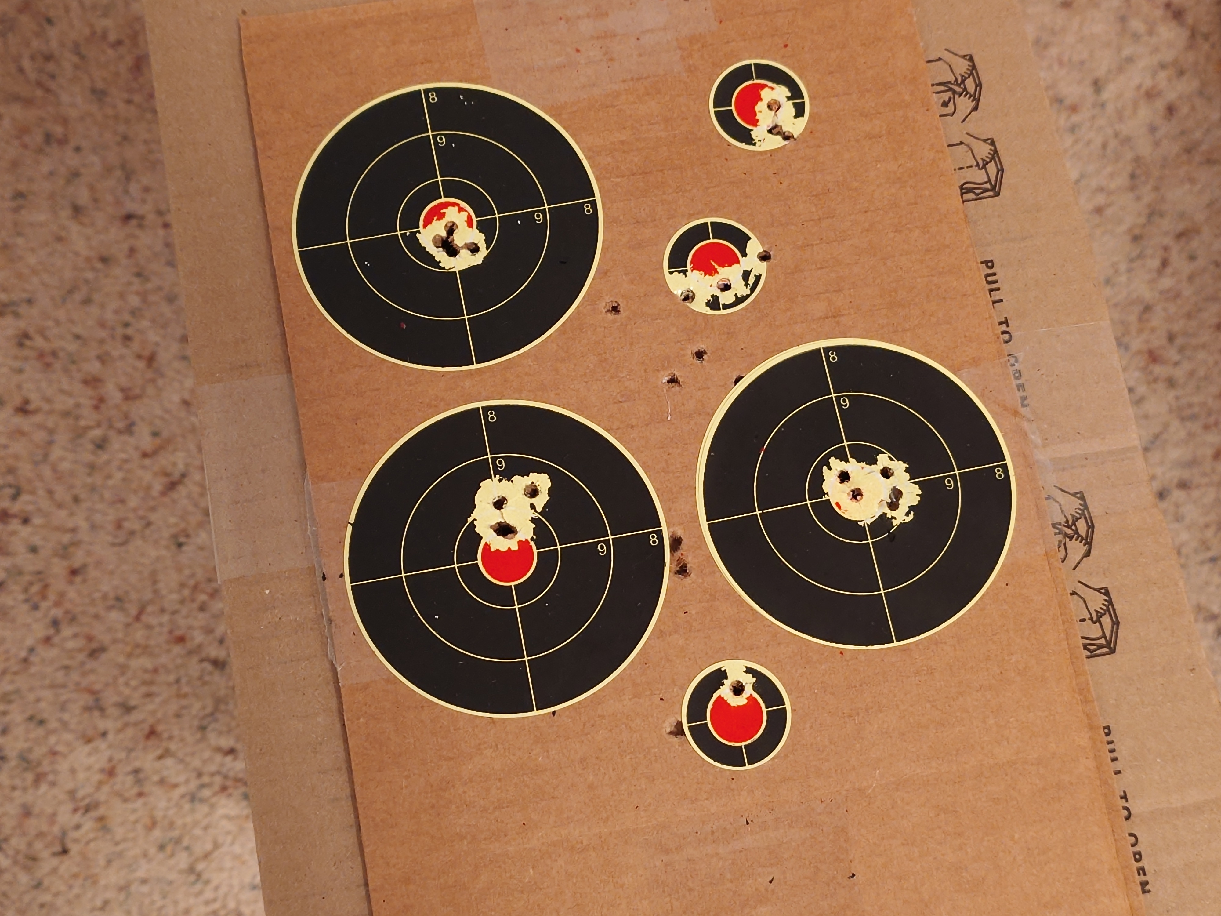

I've been doing some more testing on the 3 NSA slugs that I currently have. I did ordered more of the 0.2165 17.5gr since it seems to shoot the best in my gun. I decided to do more testing just to make sure that I'm not wasting my money.
Tonight, I tried out the 0.216 17.5gr (as can be seen in lower right target). The first shot was right on the red because I was practically shooting where I zeroed the 0.2165s at. The more shots I did though, the more the slugs started to scatter. 0.42" center-to-center.
The next group on the lower left target is the 0.2155 17.5gr. The shots were about 10 FPS lower than the 0.216 which I thought at first I was off regulator. I checked it and reg was good so I chocked it up to the smaller diameter not having a complete seal on the barrel. (I did shot two of the 0.2165 after this group just to make sure that it is indeed what I think it is, and the 0.2165 shot at my expected velocity of around 900 FPS.) This is a 5 shot group. Three went into the lower hole. This would have been very good if it weren't for the top two holes. 0.38" center-to-center.
Overall, the 0.2165 is still the most accurate of the three I've tried. The 0.2155 is 13 FPS slower than the 0.216 on average, which is another 4 FPS slower than the 0.2165. These were shot at 32 meters. One thing I noticed is that the 0.2155 was about half a click higher than the other two even though it is the slowest of the three.
The top left target is the one I shot a few nights ago with the 0.2165s at 28 meters (I said in the above post that it's 27 meters but it was actually 28 meters. I measured from the windowsill then and didn't take into account that I am inside the window). I was in between clicks on my scope for the 28 meter zero, so I re-zeroed at 31 meters to get it spot on.
