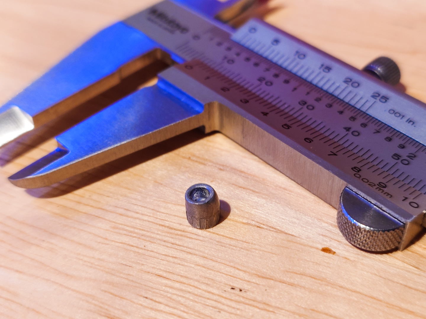

Now, I'm not doing all these measurements to compare to what the spec sheet says. I'm trying to measure as precisely as I can (without having to buying a micrometer) so that I can compare that to my barrel's dimensions.
I recovered a Hades pellet shot through water and measured it. According to that, the grooves of my barrel is a smidge over 0.216". This was confirmed with measurements from a recovered NSA slug having the exact same measurement. The Hades' skirt started out at 0.226" and the NSA started out at 0.218" at their widest, so I am 100% sure that with the 0.216" measurements after being shot, they are touching the grooves in the barrel at the choke.
Again, I know that I'm only using a vernier caliper but I have measured, re-measured, and measured some more and reading with magnification, I am quite confident of my measurements as best as my calipers will offer.

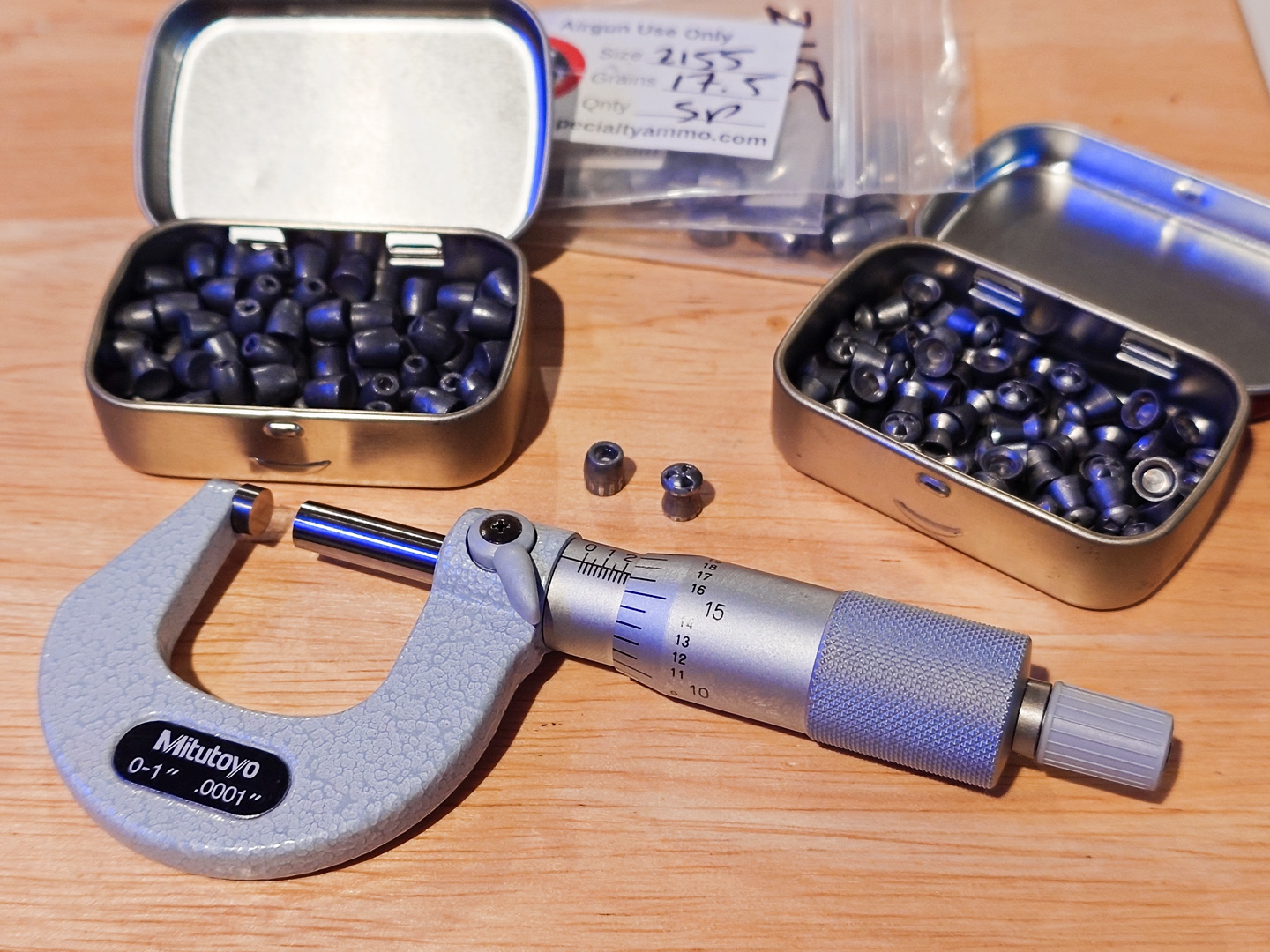

Thank you for the suggestions everyone. A few hours ago I caved in and ordered a micrometer. 😭 I'll get it tomorrow but we'll see how close my measurements were with the caliper.
I think my next order from NSA will be the 17.5gr 0.217, 20.2gr in 0.2165 and 0.217. I'm not too sure I want to go with the next heavier 23gr as I really don't want to go much over 30 FPE. I might go to 33 or maybe 35 FPE max, depending on how well the 20.2gr shoots in my gun. My gun can be tuned to 40 FPE with all stock parts but I really want to stay below 35 FPE for a backyard varmint rifle and I want to stay with the Hades 15.89gr on the pellet side.
I got my micrometer earlier this morning and spent a few hours playing with it and practicing. It is not easy to get a very precise measurement from it and it definitely takes a certain feel for it. It was very hard to measure especially the pellets as it's so easy to "fall" off the high diameter that I'm trying to measure.
It's also amazing how precise this instrument is. At first, I will make my measurements and when I check zero, it was always returning about 0.0005 off zero. I thought it might be body heat, but that's not it. I then realized that with the caliper, I am in a habit of wiping the surfaces regularly. Sure enough, that was the issue with the micrometer. As I'm measuring the pellets and slugs, lead dust is collecting on the surfaces. A quick wipe and it was back to zero.
On to the projectiles, I noticed that the NSA 17.5gr 0.2165 slugs that I bought in 2021 and the ones I received a few days ago have different diameters. I'm quite certain that they're using different dies. The one from 2021 was measuring 0.2164" which is very close to the spec but the 2024 ones are measuring 0.2169". I've measured many of them and opened all 3 boxes I have and the measurements are consistent. I haven't shot these newer slugs yet but I'm sure it will be ok with my gun. I'm just documenting it for consistency's sake if I ever decide to load up on these slugs. It also makes me wonder if I step a size up to the 0.217 caliber if it will have the same tolerances.
Anyways, I measured the 2021 NSA 17.5gr 0.2165 caliber slug that I shot a few night ago. I measured many times as I know how important this measurement is in regards to barrel sizing and how difficult it is to measure. These are the numbers I got; 0.21625" 0.216" 0.21542" 0.21565" 0.2156" 0.2158" 0.2153" 0.2152" for an average of 0.21565". I am quite certain that this is the groove diameter of my LW barrel at the choke. Looking back when I tested the 2021 NSA 0.2155 caliber (which actually measured true to spec), it was shooting quite a bit slower which tells me that even though It's practically the same size as the barrel's grooves at the choke, it is quite loose and not sealing well before getting to the choke.
The Hades pellet as I mentioned was very difficult to measure but it definitely has more variations in the measurements most likely because of how thin the edge of the skirt is. I measured the skirt of the shot pellet and these are the numbers I got; 0.2102", 0.21085", 0.2104", 0.2117", 0.2133", 0.2113" for an average of 0.2113". It is smaller than the slug and I'm not sure exactly what is going on but I'm just reporting my findings. One reason I can think of is the high points on the pellet's skirts are more pinpoints compared to the slug and I think it makes such a tiny area much easier to compress when taking the readings. I looked at how small the difference is between the pellet and the slug by opening the micrometer to the same amount and I can barely see it with my eyes.
I also tried measuring the head of the pellet but I'm getting wildly inconsistent measurements likely because the Hades has started to deform at the hollow point.
The general recommendation of sizing the slug by about 0.001" larger than the barrel's groove diamter at the choke is definitely in effect here. I know I'm a sample of one but it shows me it's sound advice because the slug that shot best out of my gun is within this recommended range.
