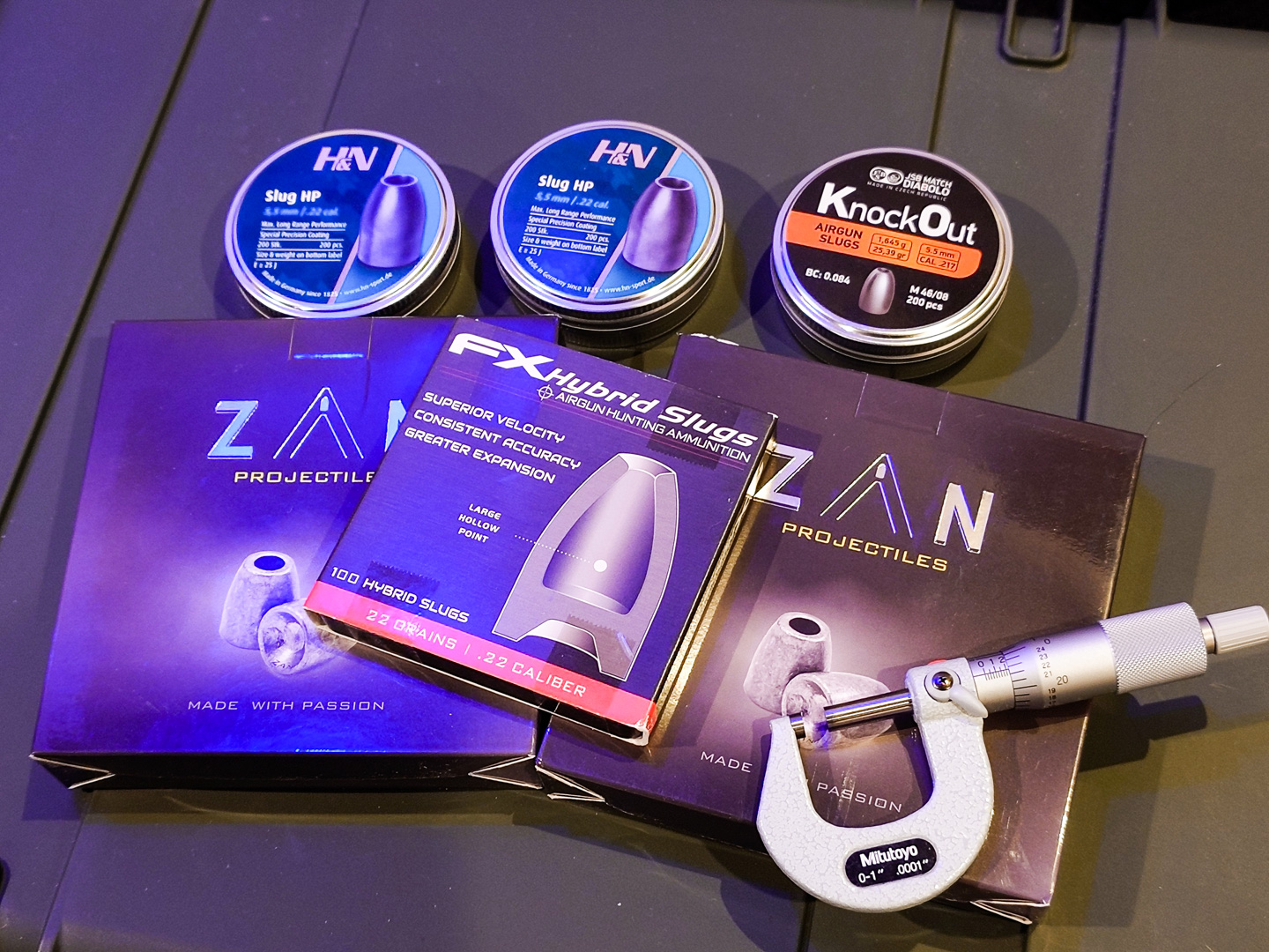

Earlier today, I received the slugs that I ordered a few days ago. I tested them earlier tonight.
31.8 meters, 5 shot groups
JSB Knockouts 0.217" diameter - This was the worst of the ones I tested tonight. 1" CTC groups. The spec says it's supposed to be 0.217" but they measure 0.2181" for most of them. Certainly not even close to 0.217"
Zan 20gr 0.217 - These were a little better than the JSB Knockouts but still unacceptable. 0.73" CTC.
Zan 23gr 0.217 - I didn't test these yet based on what I saw with the 20gr version.
H&N 21gr 0.217 - These shot ok but nothing spectacular. 0.48" CTC group that includes 2 flyers.
FX Hybrids - These actually had the same 0.48" CTC as the H&N 21gr but I feel it's more accurate. I felt that I pulled 2 of the shots. I will continue testing this one. 32 FPE with my gun.
H&N 23gr 0.217 - This is by far the most accurate in my gun. 0.155" CTC group averaging 801 FPS (32.78 FPE) in my gun. I'm very surprised that my gun likes the H&N slugs at all as I've never had any luck with their pellets in my TX200 nor my Taipan Veteran. I'm glad though because these are relatively easy to get and much cheaper than the FX Hybrids. Now, I don't know yet how these will perform at longer distances, but as I said previously, I'm really only planning on shooting up to 75 meters. If these remain sub-MOA at that distances, I will be very happy.
Interesting to note that the H&N 23gr is also the closest in diameter to the most accurate NSA 17.5gr slug. The NSA slug that was most accurate with my gun has a diameter of 0.2167". The H&N 23gr is 0.2168". Incidentally, the less accurate H&N 21gr were measuring below 0.2165" with some closer to 0.216".
In my testings tonight, I noticed that slugs seem to be far more sensitive to the way I pull the trigger than pellets. I'm not sure if it's because my gun has a 550mm barrel and the lock time between a 950 FPS Hades and an 801 FPS H&N 23gr slugs makes that huge a difference but I can't think of anything else. I have set up my Taipan's trigger weight to what I feel comfortable for a hunting rifle; not too heavy and not too light. I set it up completely by feel so I don't have any idea of its weight. If I had to guess though, probably around 15 oz. All I can say is that it's still heavy enough that sometimes I feel that I want to slightly jerk the trigger rather than letting it break smoothly. For the distances I'm shooting at, I've never really had too much issues doing that with pellets.
With the slugs however, I find that it's super sensitive to that bad habit. I really have to concentrate on applying a constant pressure until the sear breaks for the slugs to hit their targets.
Case in point, the H&N 23gr practically did a 1 ragged hole at 31.8 meters on the first group I shot with it. I did a few more shots with the other projectiles in between and I came back to the H&N again with a totally different mindset. I don't know if I was getting tired but I noticed that I was slightly jerking the trigger and the group really opened up. I didn't measure it but it looks to be 0.75" CTC. I concentrated again on the proper trigger pull and the accuracy of that particular slug came back.
Also, this is why I said above that I feel that the FX Hybrids can be a bit more accurate. It's because that was the first group I shot so I wasn't fully aware yet of how I was pulling the trigger and just how sensitive the slugs are to improper trigger pull.

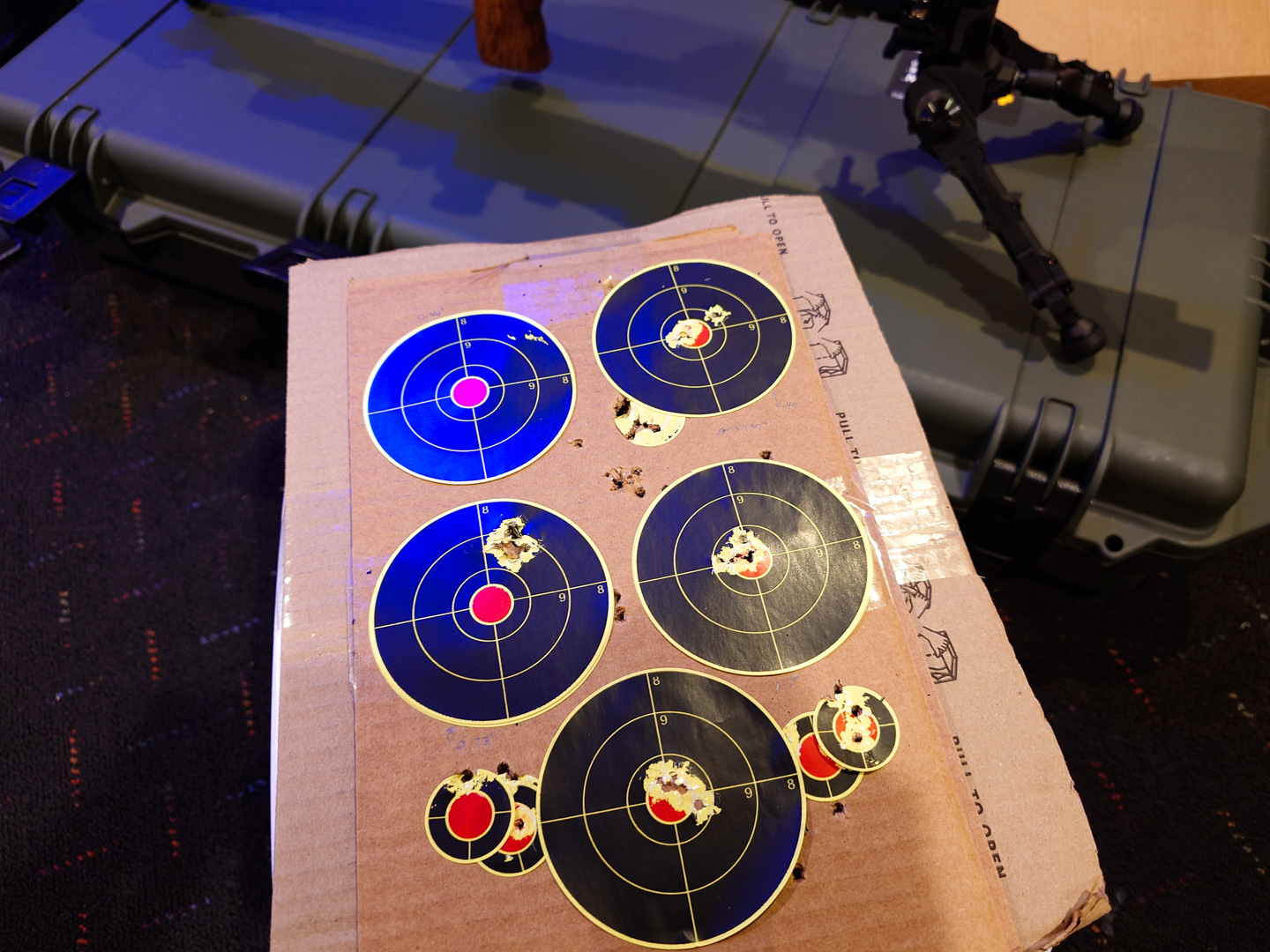

I did another quick test tonight just to make sure that the results I got last night were consistent. I don't want to go about thinking I have accurate projectiles and turns out it was just a fluke. Also, remembering what I learned last night regarding the trigger pull, I was very aware this time of how I was squeezing the trigger and making sure that I am not jerking it to break the shot. It makes such a huge difference in consistency and groupings! I retested the H&N 21gr that I didn't like last night before I had the revelation regarding the trigger pull and it shot very well this time around now that I know how to properly shoot my gun.
31.8 meters
Top right target - H&N 23gr 0.217 - 0.58" CTC (0.155" CTC without the pulled shot on the right) (FPS = 805, 803, 802, 800, 801)
Middle right target - H&N 23gr 0.217 - 0.35" CTC (FPS = 802, 800, 800, 798, 798)
Middle left target - H&N 21gr 0.217 - 0.255" CTC (FPS = 838, 836, 836, 836, 837)
Zeroed H&N 21gr on the small targets below (FPS = 837, 838, 837, 837, 835)
Because of this latest finding, I think I'm going to go with the H&N 21gr HP Slugs just based on the fact that it's about 35 FPS faster than the 23gr with my gun's tune.

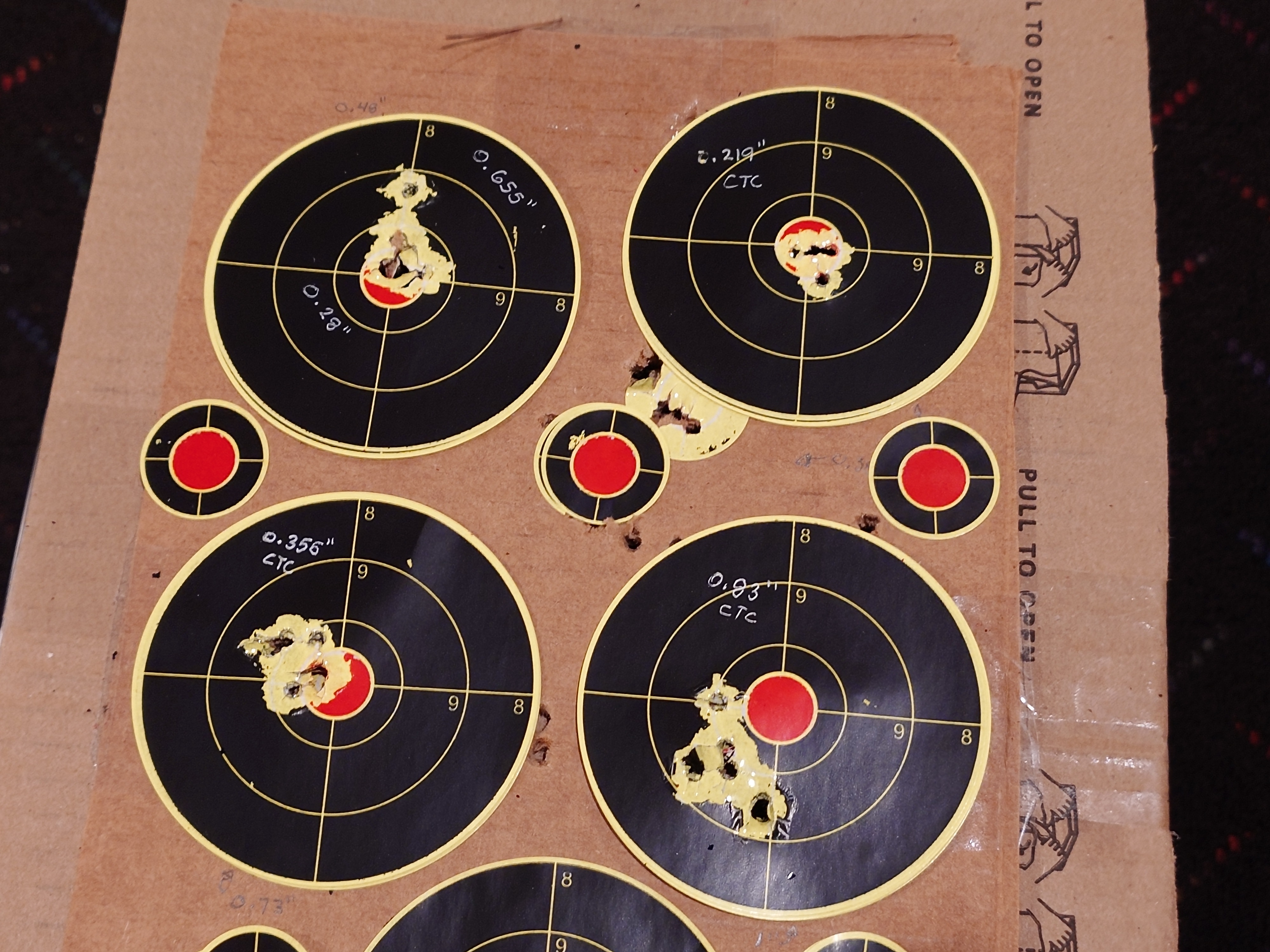

I re-shot the Zan 20gr along with the 23gr.
31.5 meter distance. I put the average velocities along with the extreme spread so you can better judge yourself.
Zan 23gr (lower right target) 0.83" CTC avg 819, ES 5
Zan 20gr (upper left target) 0.655" CTC (0.28" CTC for 4) avg 867.8, ES 2. The third shot was a flyer. I felt that I pulled it a little but I didn't feel that I pulled it that much. This was a similar experience that I have with the H&N 23gr. Very tight group and then there is that one that ruins the group big time. This is why I picked the H&N 21gr over the 23gr version.
FX Hybrids (lower left target) 0.356" CTC avg 829.4 ES 3. This slug was very tight going into to the chamber.
H&N 21gr (upper right target) 0.219" CTC avg 855.4 ES 3. I re-shot this again as a control. This is actually the tightest group I've shot with these so far but just by a slim margin.
I also noticed that for the past 2 shooting sessions now, all my velocities are faster by about 20 FPS for each slug from when I first started testing the slugs. I don't know what's going on so please enlighten me if you do, but I think maybe the barrel could be leading/seasoning with more slugs I shoot through it. I haven't cleaned it yet. During the last session, I thought it might be the angle of my chronograph since it's an optical Caldwell, but when I set it up tonight, I made sure it was as parallel to the barrel as I can get it.
I can't wait to take the H&N 21gr to longer distances to see what they can do.
