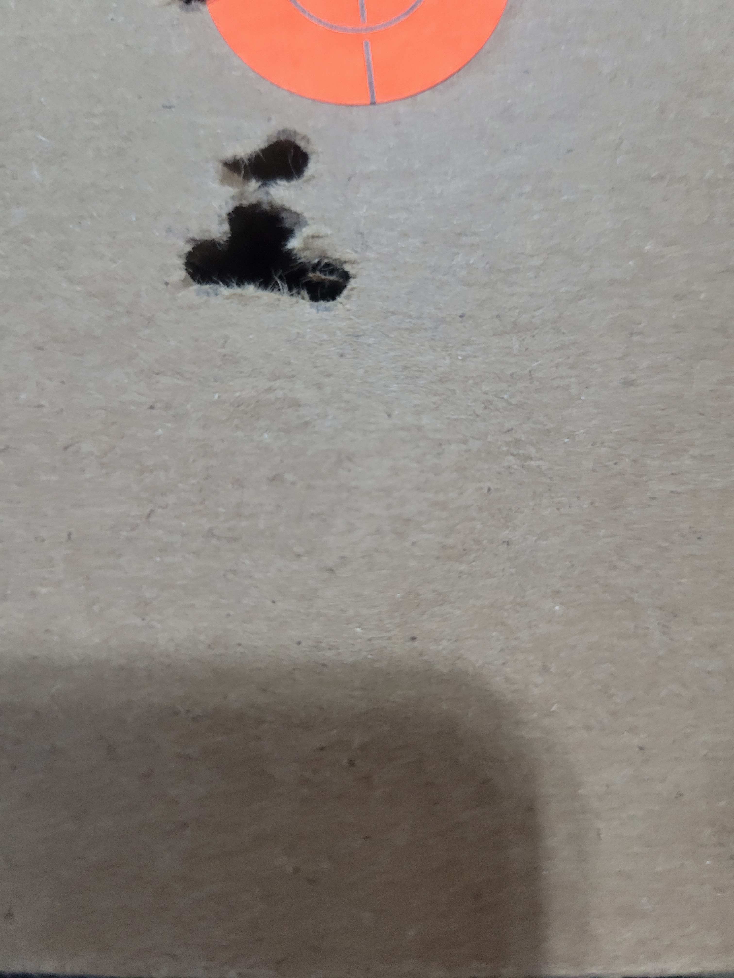

Decided to try my luck. Had 21gr .217 and .218. From slugging my barrel previously wasn't even gonna mess with .218. Spritzed some gunzilla on the slugs and went at it. Not sure the speed. Likely around 800-830fps. Just a guess. But this is 5 shots at 80yds just using a front bag shooting out of my truck. Slight breeze left to right. First shot was the left one then 4 in the small group to the right. We got some potential here!

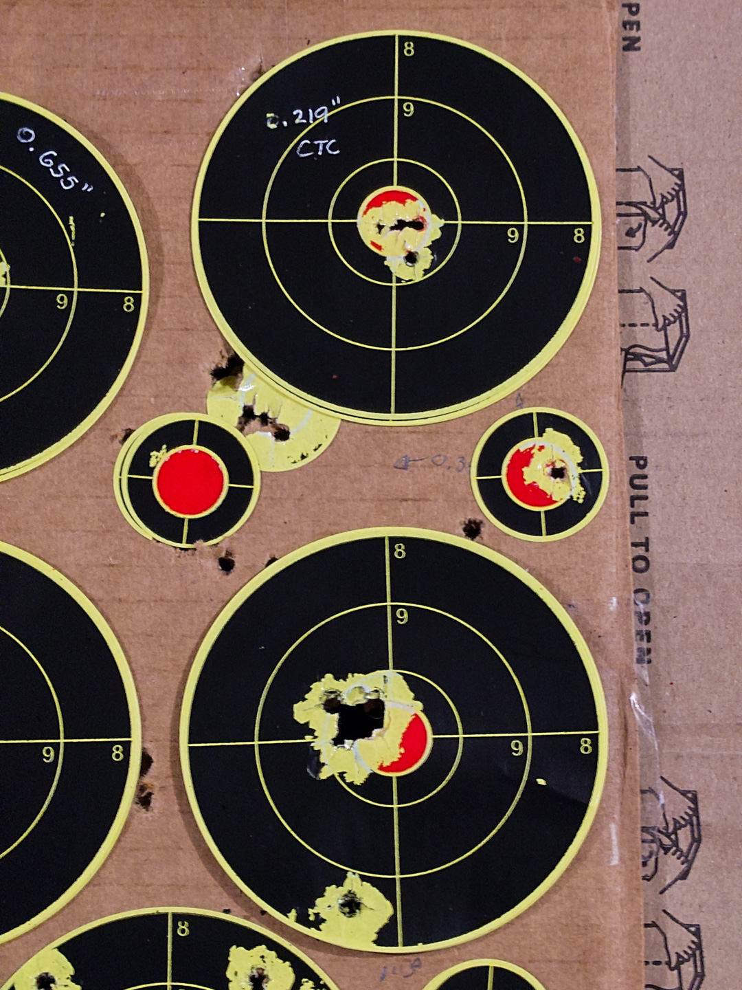

I shot some JSB Hades at the same distance (31.5 meters) tonight. I'm posting the photo just so I'm not cherry picking groups. The Hades 5-shot group is at the bottom target; 0.28" CTC. Disregard the hole at the very bottom as that is from an H&N Hunter Extreme that would not grouping at all. The target at the top was the H&N slug 21gr 0.217 that I shot the other night.
Many people in the forums claim "one hole groups all day long" at what ever distance... I believe that my skill as a shooter is the biggest hurdle for me in trying to asses a gun's accuracy as I don't find it easy at all shooting super tight groups. Short of just clamping down a gun to a vice, I am not going to eliminate my user error.

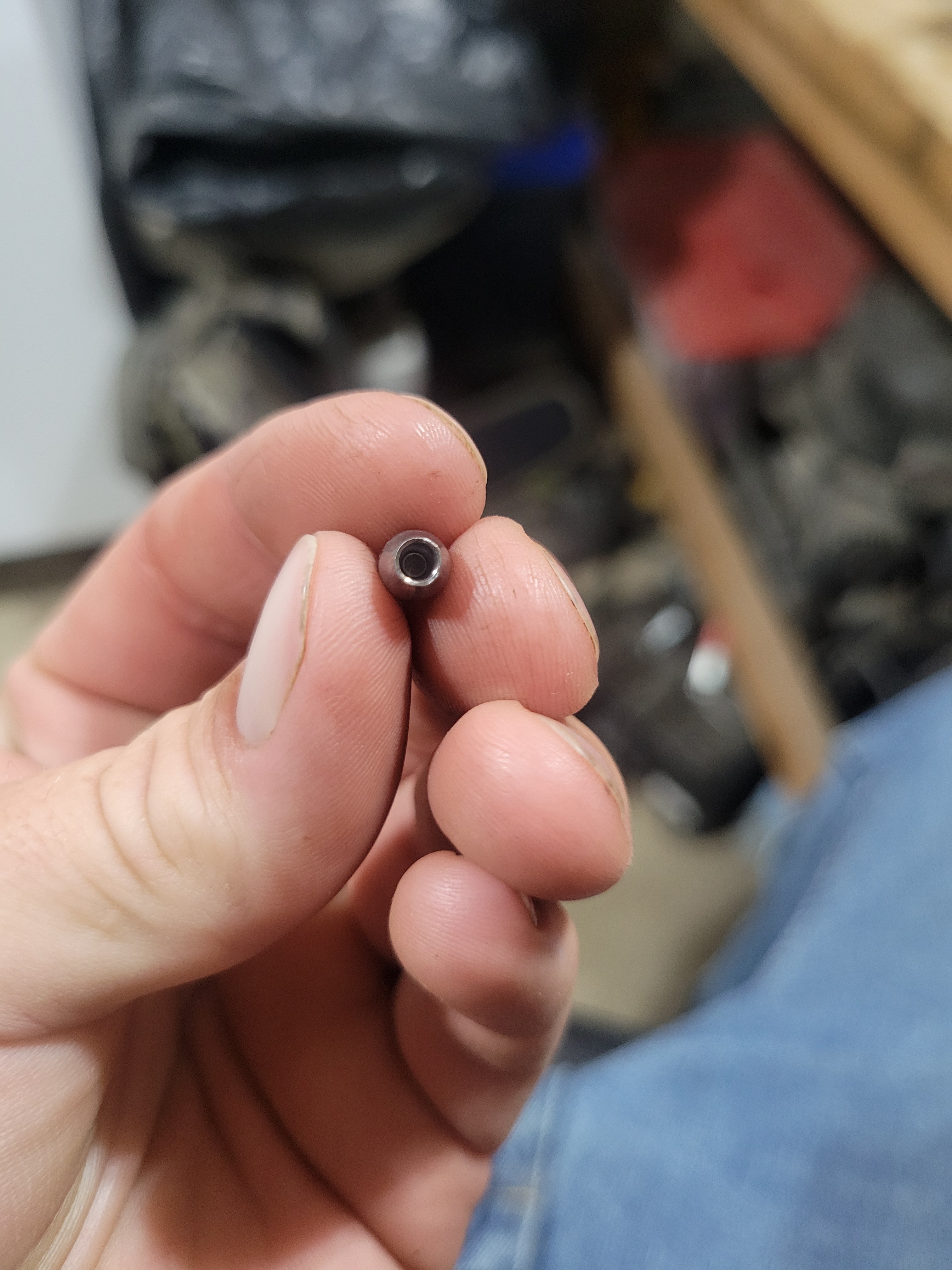

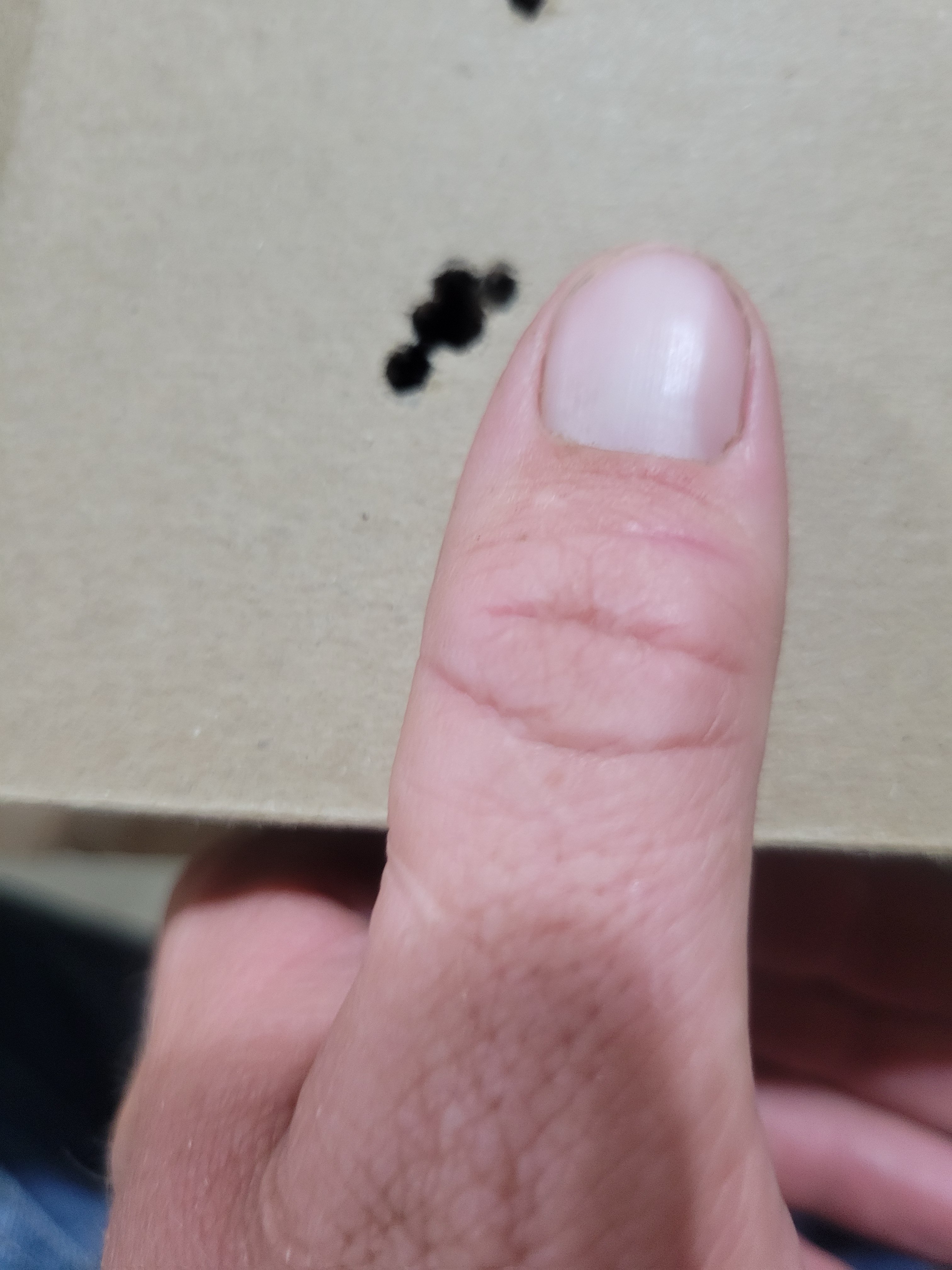

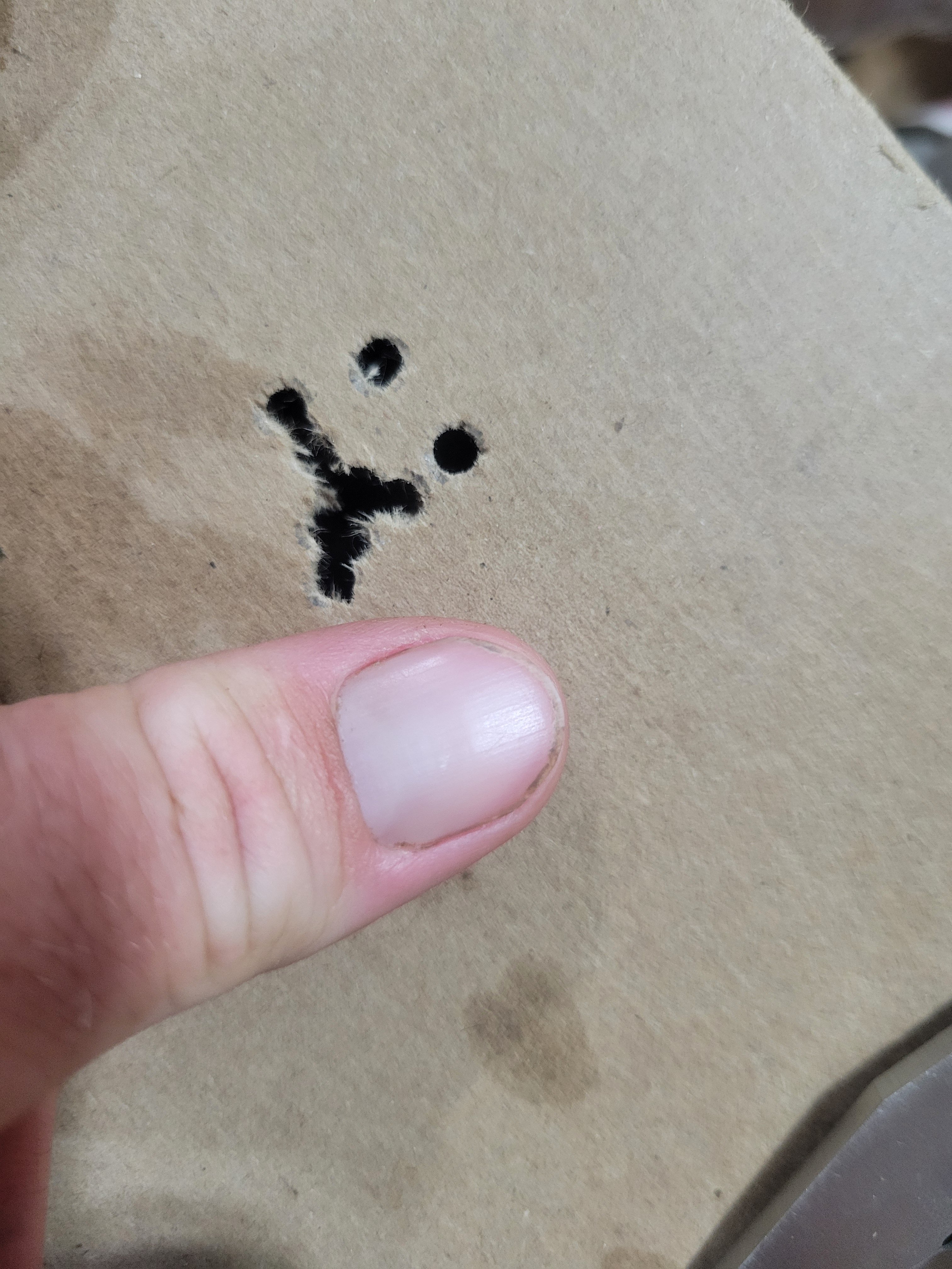

I tried some Varmint Knockers 22gr XLHPs and man these shoot very good! Around 815fps. Tried faster on multiple setting but always induced some wild flyers. This setting was very consistent. 3 5 shot groups in a row around .4" at 50yds. One 10 shot group around .68". And thats all i shot at that speed so no crazy flyers. By far the most consistent slug I've shot out of a gun to date. Also look at th
e HP on them. Gonna make a nice POP! I will be ordering more of these. Also I tried the H&N 21gr on paper at 50yds and they weren't even as tight of a group at 80yds on the spinner. Go figure.
