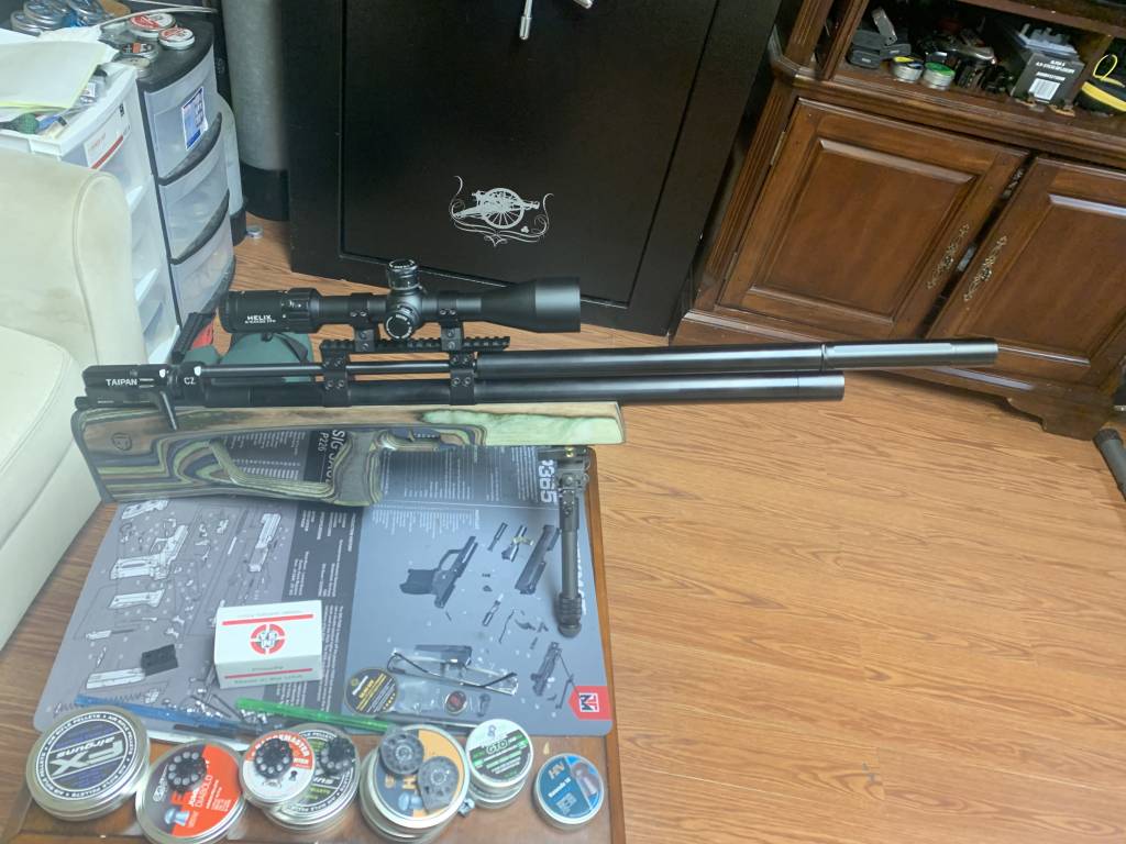

Took the Vet out for it's initial run and experienced TERRIBLE grouping; like 1.5 - 2.5" @ 25yds. NO consistency. I only fed 2 types or rounds through it for now, NSA .216" 23gr and H&N 21gr.
My Vet does have a Huma regulator, CZ 700mm barrel, power plenum, DFL adjuster, and power spring.
I will confirm regulator pressure later today (I think it's at 120bar). I was averaging 980 - 1016fps but like others have experienced, when I adjust the HS in, it won't cock. Actually, from where the HS just just allows the gun to cock to no tension on spring is almost nothing. So basically I can not adjust the power. I replaced the original spring with both DFL and original HS cap and no change. HS tension was same with both.
I assuming that the .216" is designed better to fit a choke and the CZ barrel doesn't have a choke? I have ordered NSA samples @ .218".
With the reputation of this rifle, I know I have something grossly out of sync. Any recommendations?
