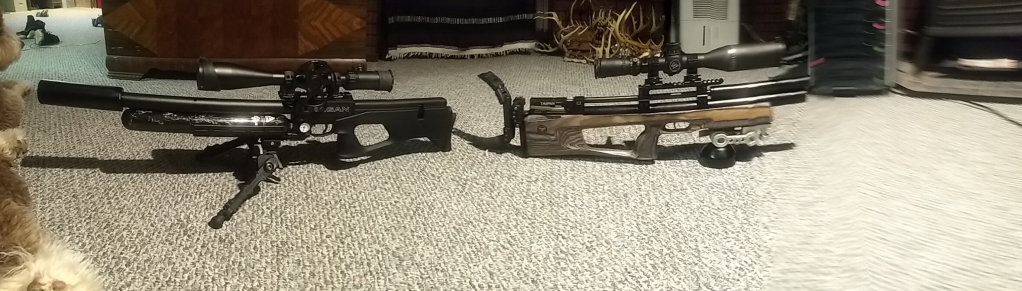

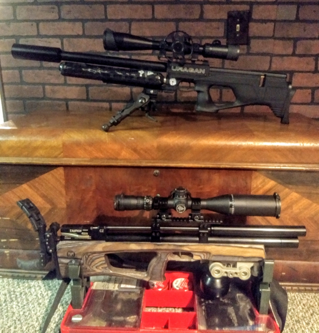

I have both and to me it would depend on what i I was useing it for. I have my Taipan Veteran .177 setup to do some Field Target work and for open class and WFTF I think it's suited rather nicely for this type of shooting. I luv the fact that it has a open breach and It comes with a single shot tray. I dislike magazines for the shooting I do and the Veteran is one of the only bullpups that has a.single shot tray. My .177 Veteran Standard is getting over 200 shots at 12ft lbs and 120 shots at 19ft lbs and is very easily adjusted with the exposed hammer spring. I luv the fact that this can be done so easily. The.trigger on the Vet is outstanding for a.bullpup...easily the best bullpup trigger I have ever pulled.
Now for the Uragan I believe it's better setup for a hunting/pesting rig. With the.big bottle it can get lots of shots in .25 and .30 calibers. It has a good trigger but I do not like that the trigger is.plastic...for.such a well built rifle it should be metal in my opinion. My regulator on the Uragan is phenomenal...I'm getting 40 shots at 83ft lbs...that's a 45grn pellet at 915fps and has a extreme spread of only 15 fps over that 40 shots. Shot to shot consistency is 2fps. The accuracy of my .30 Uragan is good but I really haven't had the chance to shoot much past 50yds so I can't comment on longer range accuracy. But at 50 yds mine will stack pellets about the.size of your fingernail. I love where the safety is on both these rifles which is forward of the trigger inside the trigger guard.
If I had to pick one platform I think I'd go with the Taipan Veteran just because to me it has the COOL ASS FUNKY factor going for it. I think it's the blocky forend and ole skool bullpup look that does it for me. Also the single shot tray and better trigger really nails it. So that's my opinion...really u can't go wrong with either rifles and I'm glad I have both.
