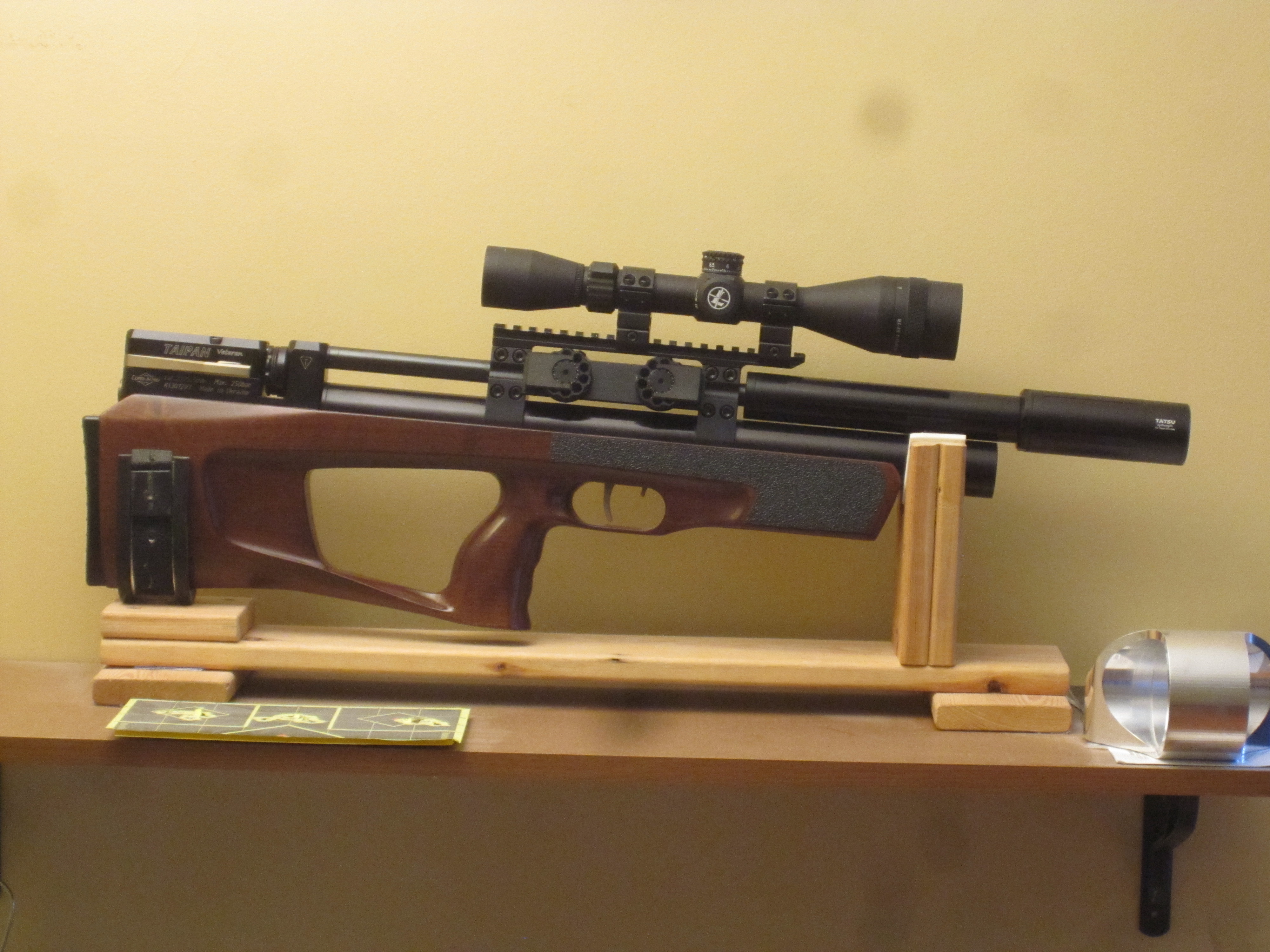

Taipan Veteran Range time
Weather was too bad for springers today so did a trifecta at my club. Shot the Taipan Veteran at 50 yards, PB pistols at 25 yards and Arrows at 20 yards. The Veteran has sat for a year and here is how they shoot off the bench. Not too shabby for a purpose built hunting PCP.

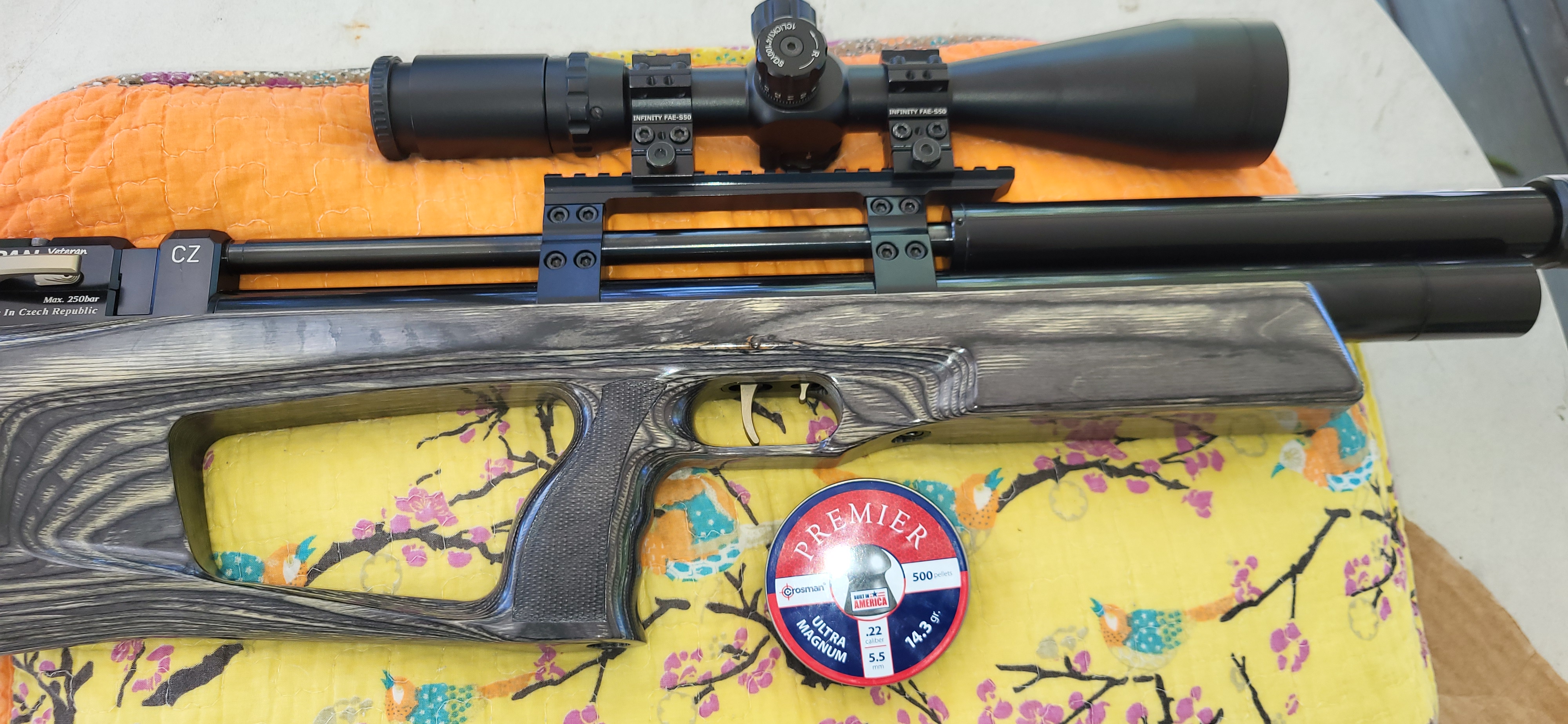

Here's a 5 shot group I just did with one of my .22 shorties.
14.35 JSBs at 870. The red square is 3/4" x 3/4".

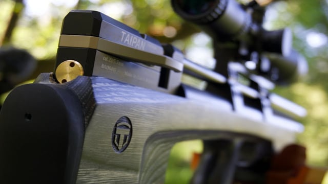

Mine arrived from Talon Tunes shooting 908 fps with 18 gr. I have since lowered the reg pressure closer to 80-90 bar and still plenty of juice to push 18s to 880-900.
How hard is it to adjust the factory regulator down? I realize you have to disassemble the gun to remove the regulator but then is it difficult to adjust it?
Well there are no lines on the reg that tell you what pressure you are adjusting too. There are small dots meant for referencing. Mine came set at 132 bar. I lowered it all the way down to just putting pressure on the washer stack. If you have calipers, I have a thread where someone else measured the piston sticking out and it matched up nicely with the same pressure his was shooting at. The reg adjusts really easily and it is easy to lose your factory setting.
Have you ran a shot string or have an idea at shot count with the lower reg pressure? I would be happy if it slings 18g lead at 960 fps or even if it's 880 plus. I want this one to be set it and forget it. I do have calipers. Are you adjusting the HS also? Thanks.
I adjust the hammer spring to find what my max speed is and then back it down to about 95% of that top speed. I do have my hammer spring adjuster marked for 18 gr, 16 gr and 14 gr pellets and also 17 gr NSA slugs. I turn them down to keep the lighter pellets in the 900 fps range, slugs in the 930 range. Feels like it is more efficient with the lower reg setting as it is still making speed. No real shot strings. Just boring stacking pellet on pellet in the basement range.
