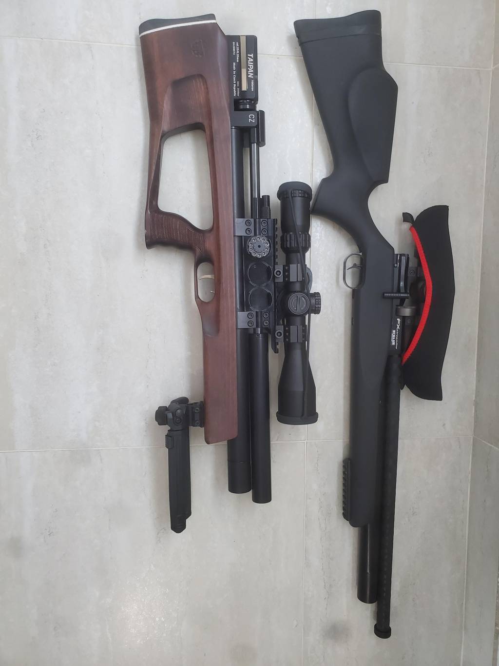

90% of my shooting is iguana head shots out of my kitchen window so the length does not matter too much for me. I really do like the taipan but I love my streamline. I think some of that preference is because a .25 is a little bit too much power for my yard.
As far as the taipan I think the standard is a happy medium. It has the same stock as the long so you have plenty of room for a picitinny rail and bipod and as you can see in the picture the whole gun is about as long as just the streamline stock. My buddy also has a standard 25 with a moderator on it and I don't think its necessary it makes about the same amount of noise as mine and most of the noise comes from the hammer. It's a great platform and from what you're saying I think it will be a good fit for you.
