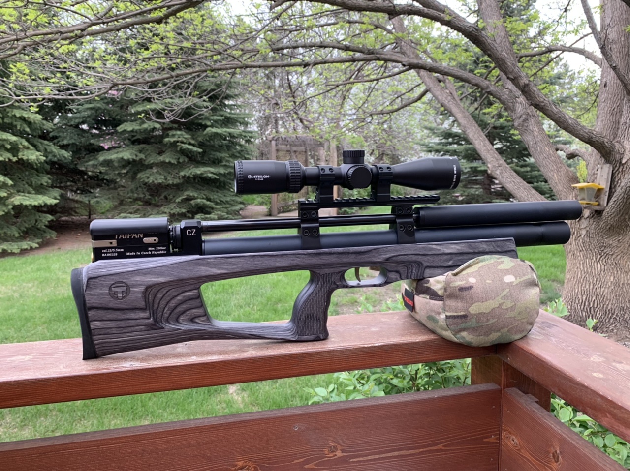

In all seriousness, if you haven't already and you decide to pick up the Taipan Veteran, you'll at least know what you're getting. With the P35, I think it's a gamble. If you're the type of person that likes to tinker and make something of lesser quality "better", them by all means, go for the P35.
