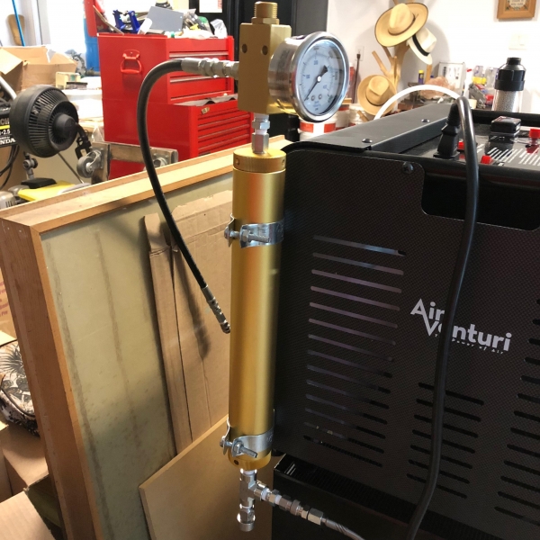

I purchased the Air Venturi Compressor, and I have been very happy with it. I did add a Chinese gold filter and an hour meter.
