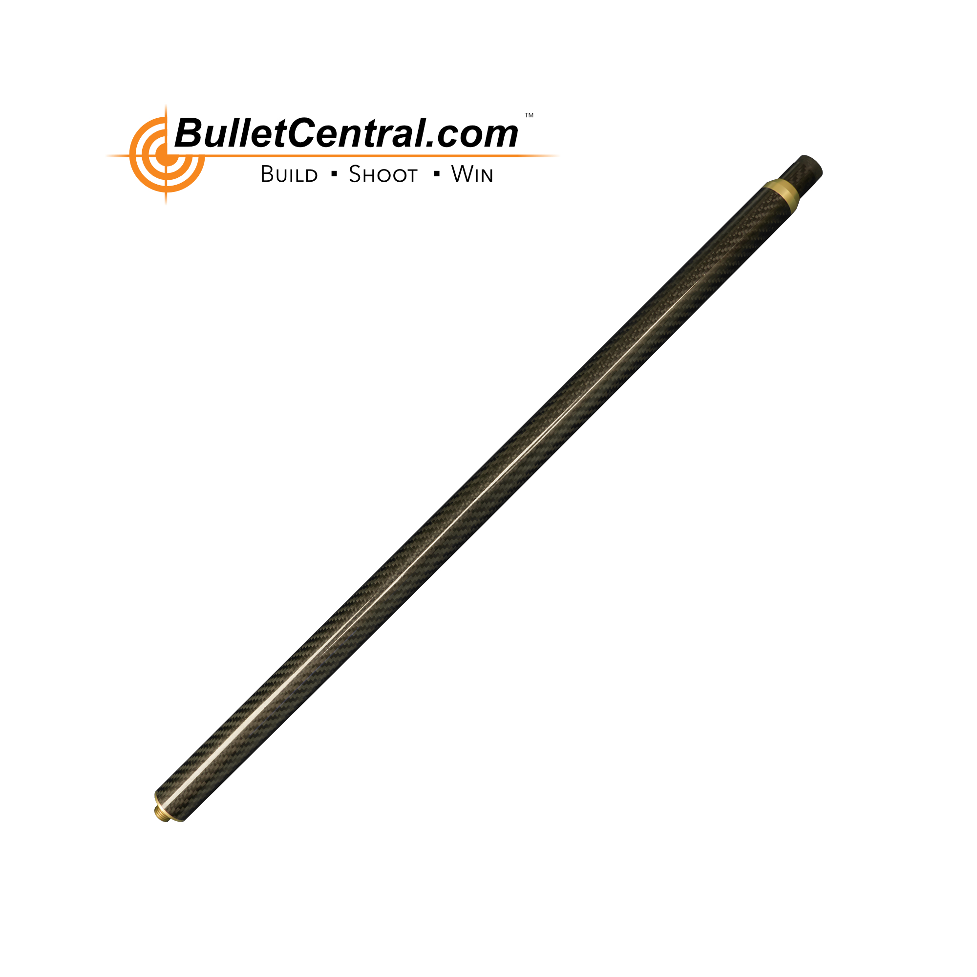

We are proud to introduce our line of Carbon Fiber Tension Shroud kits! These units will work on most FX rifles to create a tensioned barrel system. These units will help increase the stiffness of the barrels on many of the FX rifles as well as looking great!

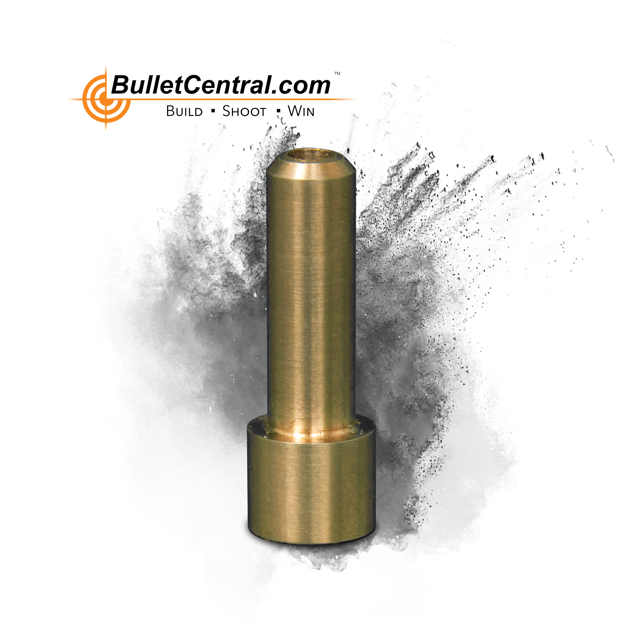

We are also excited to introduce the much anticipated Tungsten Hammer Weight! We will have two weights available to help with your tuning needs. There will be a Standard weight hammer weight of 223 grains, and a Heavy weight hammer of 254 grains! This will help push your rifles to new limits and achieve never seen before power. This will allow us the shooters to push heavier projectiles faster!
Does it have clamp on the back.
There is no clamp on the back end.
Will these work on wildcat mk3 bt?
Currently we are working on the models listed on the Website, Impact M3, Impact MK1/MKII, Maverick, and Crown. We are planning on adding more as we ramp up production.
Added myself to some waiting lists. Do you know if the tensioner/shroud will work with the barrelholder.com front supports?
Can not say for sure being as we don't have access to those units.
Will this make my rifle louder than with the factory shroud?
Shouldn't, though it will always depend on the power you are pushing the projectile.

The one major thing to remember is that you will need a 14mm outer barrel for this system to work. The Crown for instance has the option to use a light weight barrel. In this case you will have to order the Fx Impact M3 barrel kit to function properly. The tensioner system will not work with smaller barrels. Please make sure that your rifles have the 14mm OD before ordering.

@BulletCentral thanks for the reply! When can some items start to be available for purchase? For the heavy hammer, saw the note of your hammer spring--will it only work with that spring?
Glad we could help.
We are working right now to get enough of the Kits made so we can make them live all at once. We are trying our best to have the inventory so we are not slowly trickling them out a few at a time.
For the hammer spring, yes. If you are planning on running the heavy Tungsten weight , 254 grains, you will need the heavier spring as well.

An early version of the Crown that I have been playing with here in the shop. This particular Crown was set up with the light weight barrel. So I had to grab an M3 barrel kit for the correct diameter for the tension kit. Remember that you will need the 14mm outer diameter barrel for the system to work.
There is a fairly good sized gap between the two carbon tubes. It will secure on the threads on the retention nut with a built in air stripper. There are still the 1/2x20 threads to add an additional moderator as normal.
Thanks for the reply, really appreciate it. How would you compare the up and down flex of factory set up vs this design? Mine being a 600mm does have a lot of flex but it doesn't seem to affect the accuracy any just a little annoying.
Jking,
It does make a world of a difference, there is some flex there but nothing like the stock shroud. Your POI will be less susceptible to changing due to the added stiffness. This also has an added air stripper that will help with speed and accuracy.
BC
You are correct about that Mike.
The recommendation that we have been given is to tighten until you are tight, and then go a little further. If you really crank down on the system you will pull the barrel out of the receiver!
