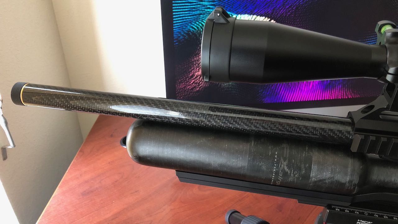

I rotated (indexing) the sleeve to 3, 6, 9, 12 o'clock positions and that does effect the POI much like rotating barrel liner, I put a small mark on the tip of the carbon sleeve to see what position it is at while I rotated it. It is at the 3 o'clock position while the barrel liner is at the 9 o'clock position.
I just remembered that if you remove the top rail and loosen the barrel block slightly before tensioning the barrel and then retightening the barrel block after tensioning you can minimize the big side to side poi shifts. That might help in your case with a 4inch shift.

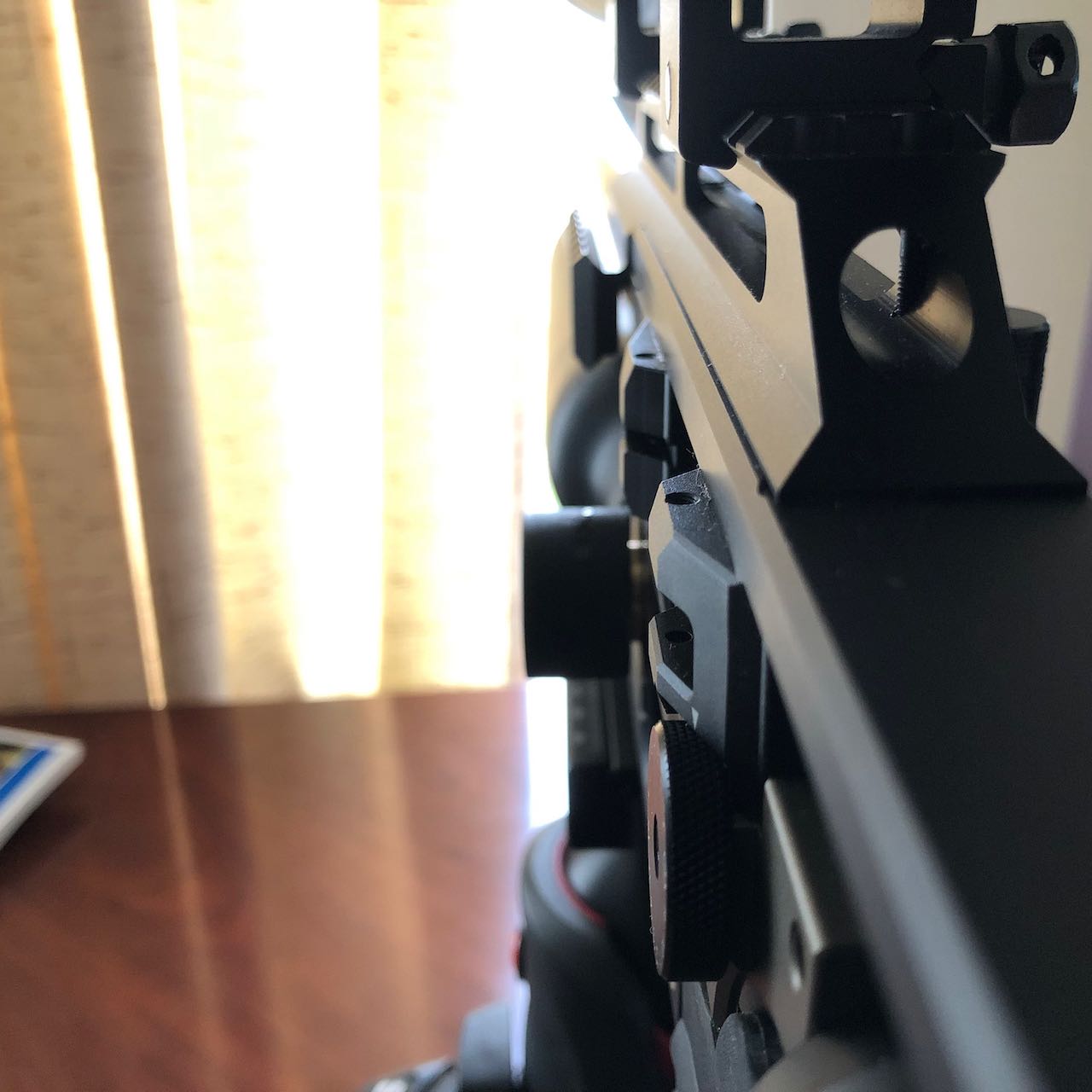

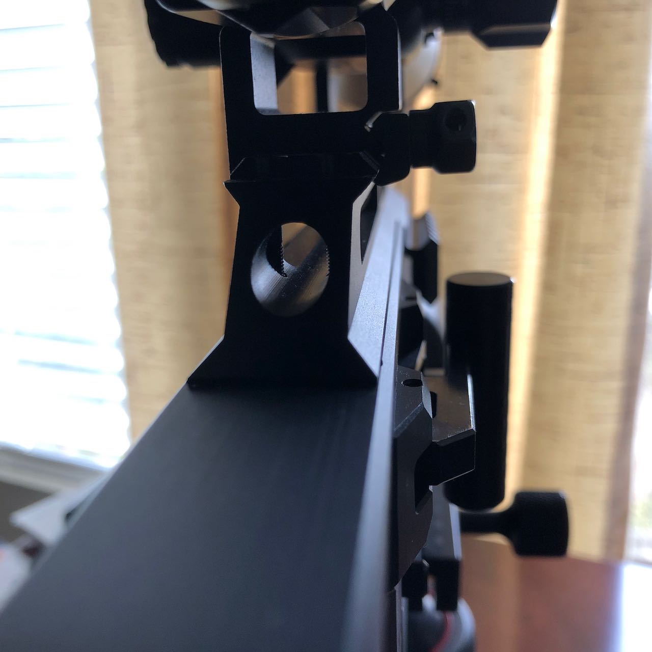

I didn't loosen the barrel block, but I decided to realign the scope rail ever so slightly. I loosened the front screw and the two rear screws, and shifted the back end of the scope rail to the right about half a milimeter. The front screw acting as a pivot point. That slight shift produced a 2.5 inch shift back to the right. The final shift to the left after indexing/rotating/tensioning the carbon tension sleeve and measuring with a caliper was 3.4 inches not 4 inches I stated before. So the net shift is slightly less than an inch now. I fine with that.
You can see from the photos, the rail is now slightly out of alignment on the left side but looks in alignment on the right side.
Third picture shows the sleeve and shroud installed.
I do wish Bullet Central offered the assembly in a matte finish rather than a glossy finish.
After all that work I got a half inch group with Predator GTO .25 16.5gr at 57 yards. Happy with that! (y)
