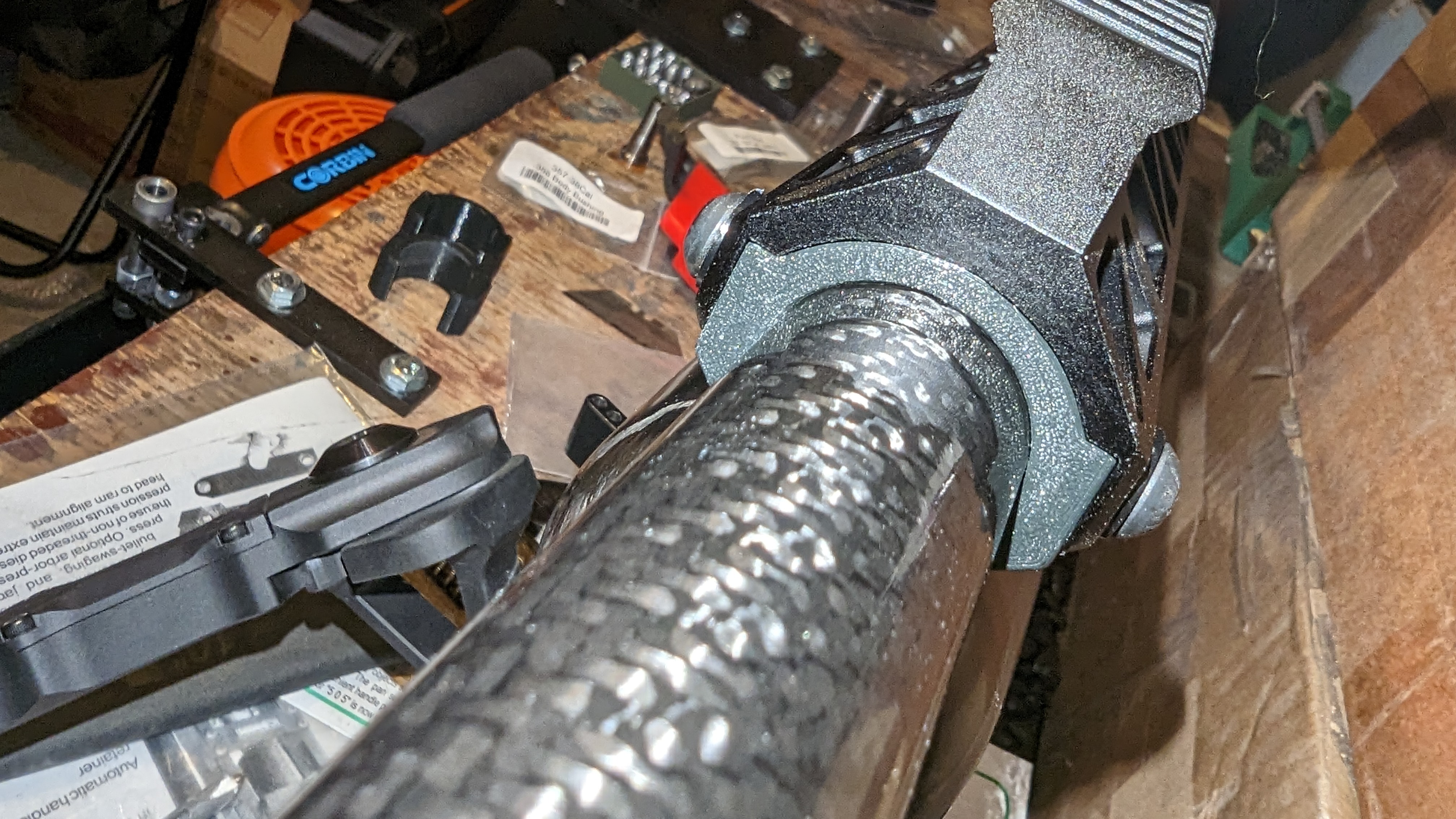

Got my tensioner. With the tensioner, Saber Tactical top rail, carbon liner sleeve (with a wrap of electrical tape over the carbon to make it extra snug), this thing is SOLID.
I did have to spend some time in Fusion 360 drawing a new barrel clamp for the Saber Tactical top rail as the Bullet Central tensioner shroud is a fair bit smaller in diameter than the factory fx shroud. 3d printed a few prototypes on got it dialed.
There is no other setup that is more solid.

How much electrical tape did you put on the liner sleeve to get it tight? Do you have any pictures of the wrap I think I’ll try that.
Don't bother lol. You'll lose your mind trying to stretch the tape thin enough for one layer to fit tight. Not worth it.

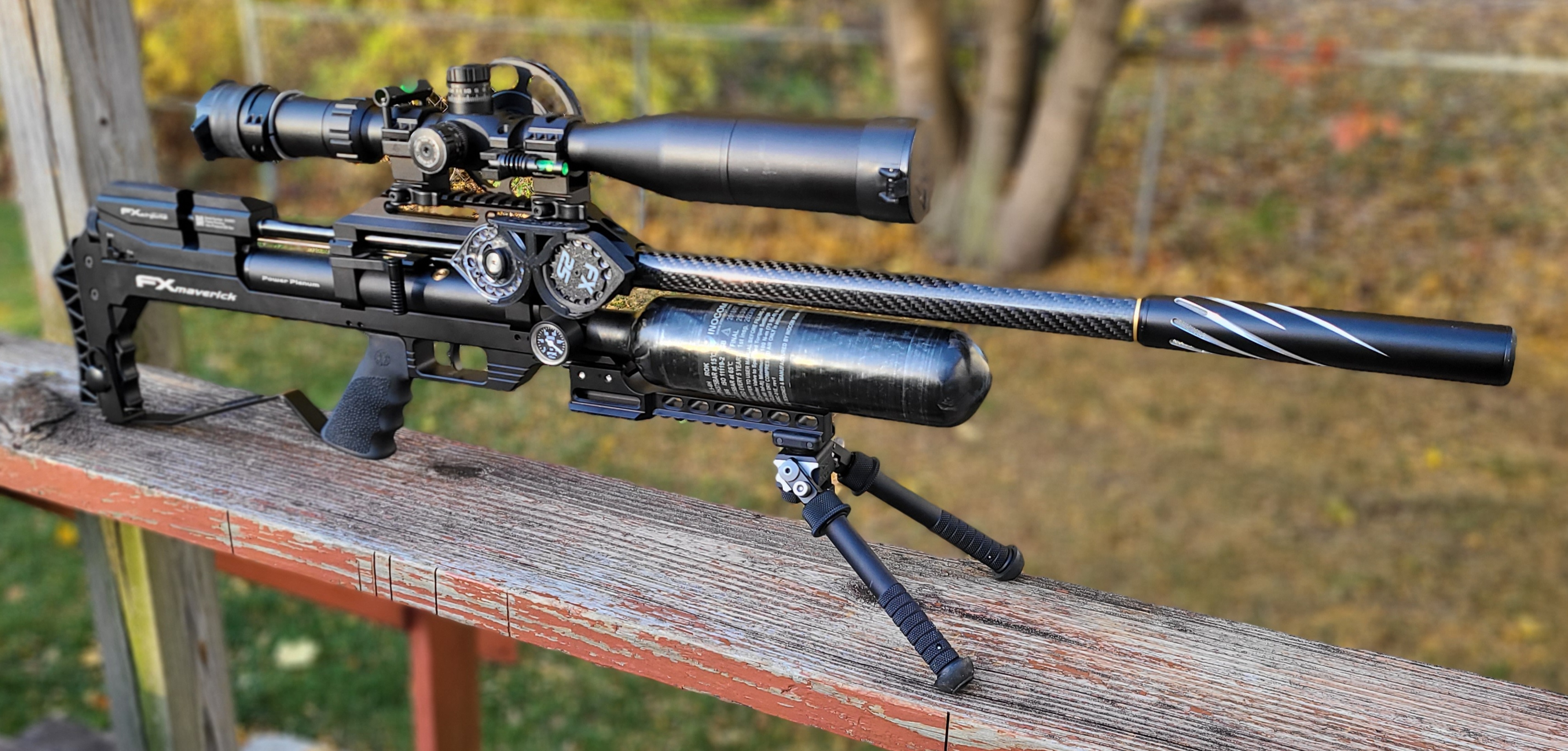

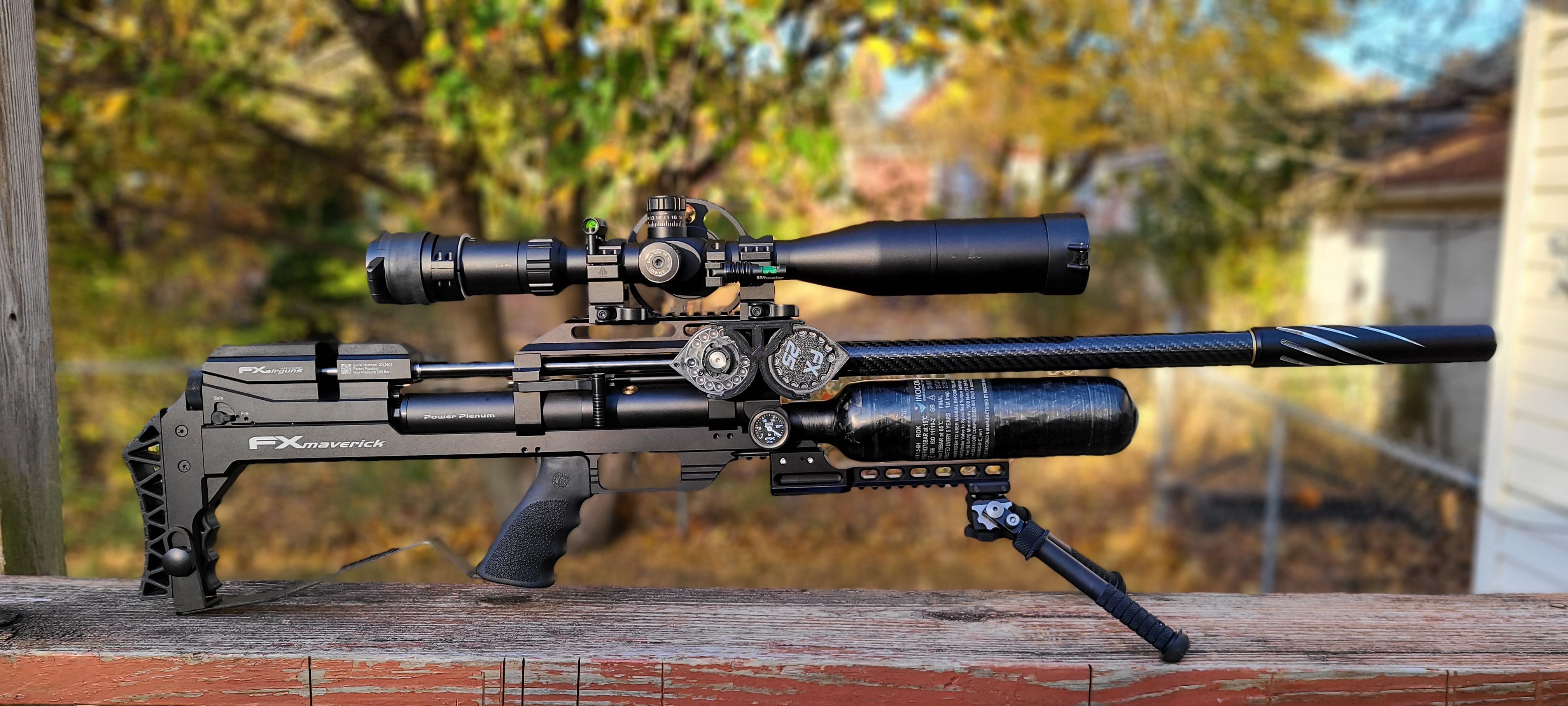

I got my 600mm shroud and tensioner kit installed yesterday on my Maverick. SUPER easy install. My POI took a big shift to the left, which I was expecting so no big deal. Didn't get a chance to shoot too much yesterday, but did shoot a couple groups after adjusting my scope. Looks like accuracy may have improved, but need to do some more testing. Overall very happy with the kit as a whole. Jury is still out on holding consistent POI, we'll see as time moves on.

Well I was doing some more shooting with my Maverick today and made another discovery with the tensioner/shroud kit, 100% proof that the barrel is much stiffer now with it installed.
I have the cheap, black, clamp-on chronograph made in china which actually works very well. Before the tensioner kit install my POI would drop about 3" low and a little left at 30 yards when the chrono was clamped onto the end of my moderator. The chrono is extremely light, but it still had an effect on POI (FYI that's with the FX carbon fiber liner sleeve installed). Because of that I never shot groups when testing velocity, I always separated the two.
Today when checking my velocity I figured I'd shoot at paper and check the POI just to see if there was any difference with the tensioner/carbon shroud installed. To my surprise there was ZERO drop! The POI didn't move a fraction of an inch with the chrono mounted, now I can don't have to "waste" pellets when testing velocity, I can multitask and shoot targets at the same time!
I was really close to buying the FX chrono for that specific reason, now I think I'll hold off on that purchase. Seeing that result today really was proof that the kit is doing it's job. Accuracy was also fantastic, but honestly it was shooting excellent groups before the install. Very happy with the tensioner and carbon fiber shroud, thank you for making a killer piece of kit!
