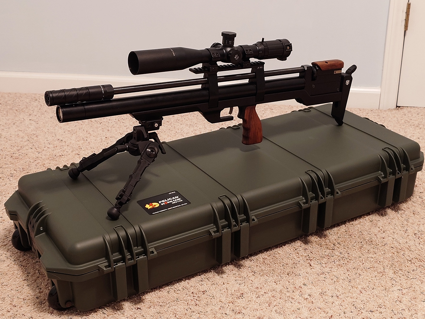

Ever since I got into a PCP 4 years ago, I've always wanted a Weihrauch HW100. When I bought my PCP, I ultimately picked between it and my current gun, the Taipan Veteran. At the time, I picked the Taipan Veteran because it is much shorter even in its long configuration. I love the way the Taipan Veteran look, but I also love the traditional rifle look of the HW100. Given the same choice today, I would still pick the Taipan Veteran first... but now that I have it for a few years now, I still can't get the HW100 out of my head.

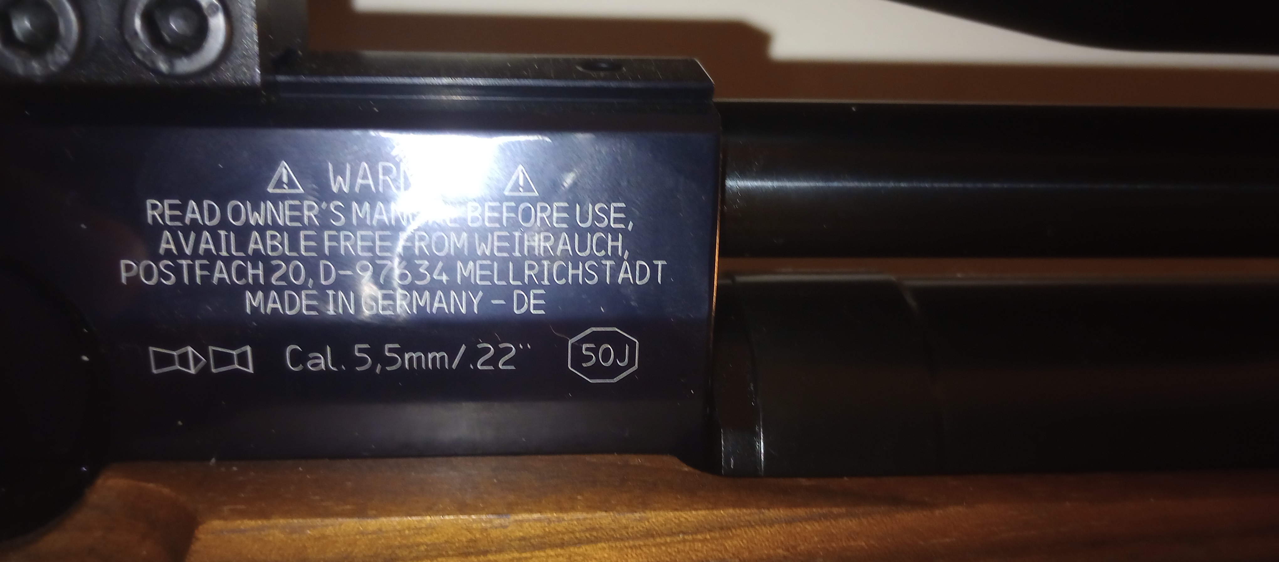

I have the full length rifle version that is rated at 50 joules and it does just a tad more at 39 ft lbs with the 18 grain JSBs which are the most accurate in it. In my shooting the first shot has always landed in the groups same as the following shots. For a 30 ft. Lb. gun you might consider the carbine version. I never decock my rifle with a magazine in place so I can't tell you about the anti- double feed after a decocking as I haven't done it yet. I can try tomorrow if you would want. It has worked as intended otherwise. I have fired a shot and removed the the magazine when intended to not use for a while or just fired a shot and left it as is. The safety acts as a cocked indicator as it only functions when the action is cocked.

These are the current specs on Weihrauchs home page; 35 joules for the .22 cal. carbine, 50 for the .22 rifle. 25.8 ft lbs for the carbine, 36.9 for the rifle. The information at AOA is outdated.

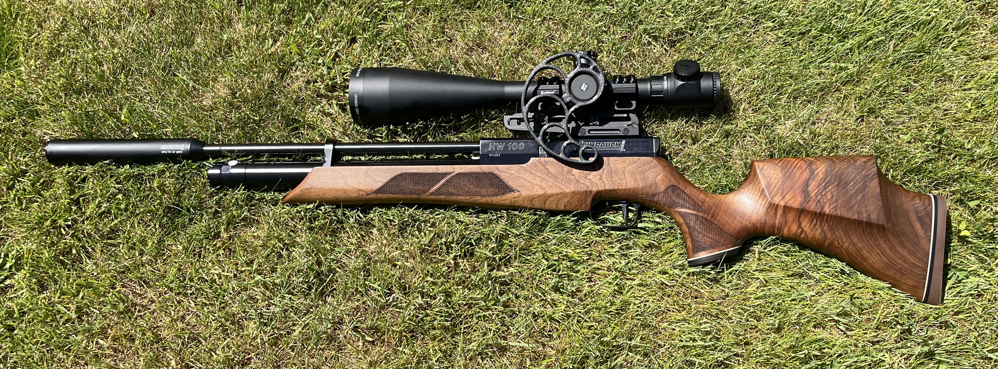

Aesthetics of traditional rifles is what I prefer; when I was searching for a rifle to buy the decision boiled down to three: Weihrauch HW100S, FX Dreamline Classic Walnut or Daystate Huntsman Revere. The FX rifles were never in stock anywhere and the Daystates were more expensive and took a higher fill pressure; after watching all of the available videos and 'net posts, I decided on the Weihrauch. It's a great rifle. If a squirrel shot is missed it's my fault!

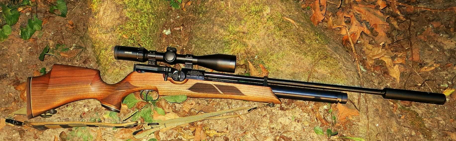

The HW100 is one of the best airguns ever and has THE BEST trigger of any airgun not counting Anschutz, FWB etc target rifles, which it rivals. The reg does require some disassembly, but with the HW100 Tuning reg gauge you can quickly set the pressure to your liking. The hammer spring only requires the back cover plate to be removed. While the rifle is fully adjustable, it is certainly not like the FX rifles with external knobs. It is a more traditional rifle like the FX Royale. I rate it as one of the finest pcp rifles made. It is a bit heavy, but adding a Titanium air cylinder makes it wonderful.

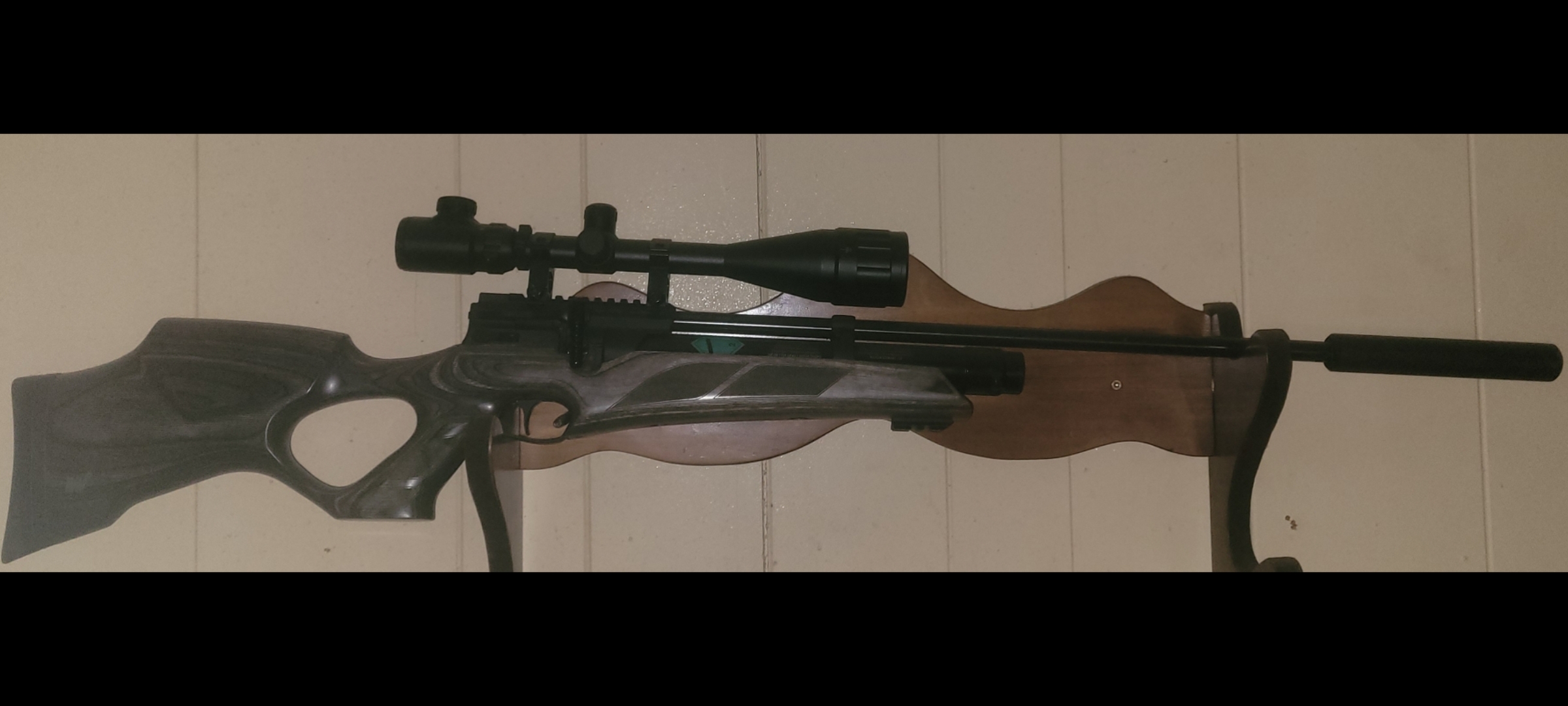

Beauty, as they say, is in the eye of the beholder, and unfortunately I see no beauty in your tipan veteran. The HW100 on the other hand is, in my eyes, a beautiful rifle, and the T variety’s (thumbhole stocks) are simply drop dead gorgeous!!!
