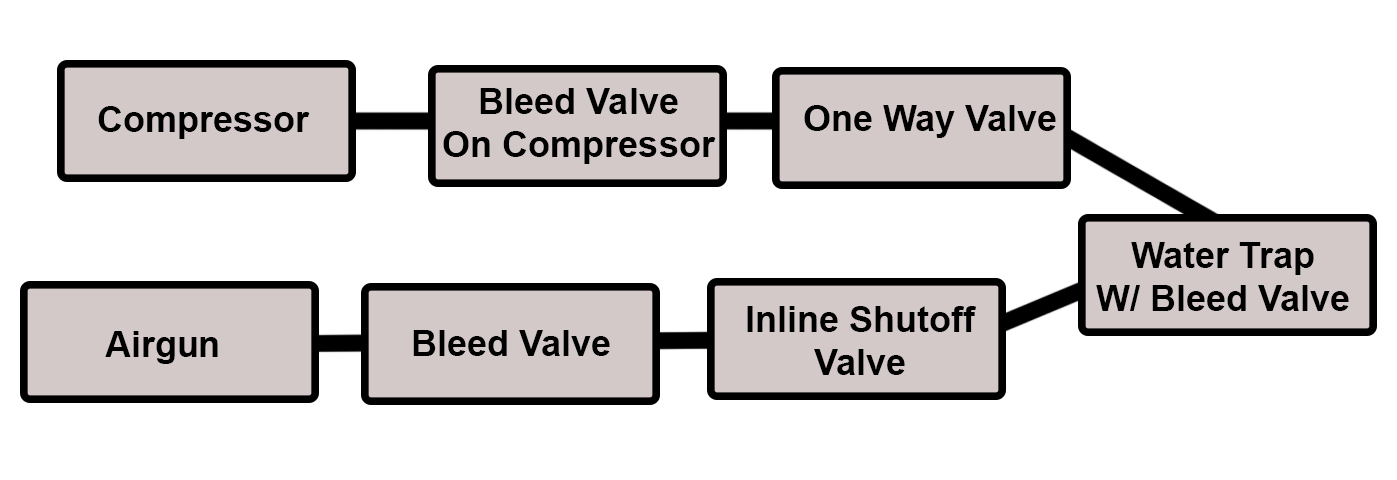

If you end up with a fairly large water separator / filter setup for your home use to fill guns and tanks, and don't want to have to wait to fill that up every time from zero psi, you can install a one way fitting on the compressor side and a shut off valve with a bleeder valve on the gun side. That will allow you to keep the filter / trap under pressure at all times, but you can remove the gun from the whip and restart the compressor with no load by closing the shutoff valve and opening the bleeder on the gun side. My filter / trap setup takes longer to fill than several of my guns.

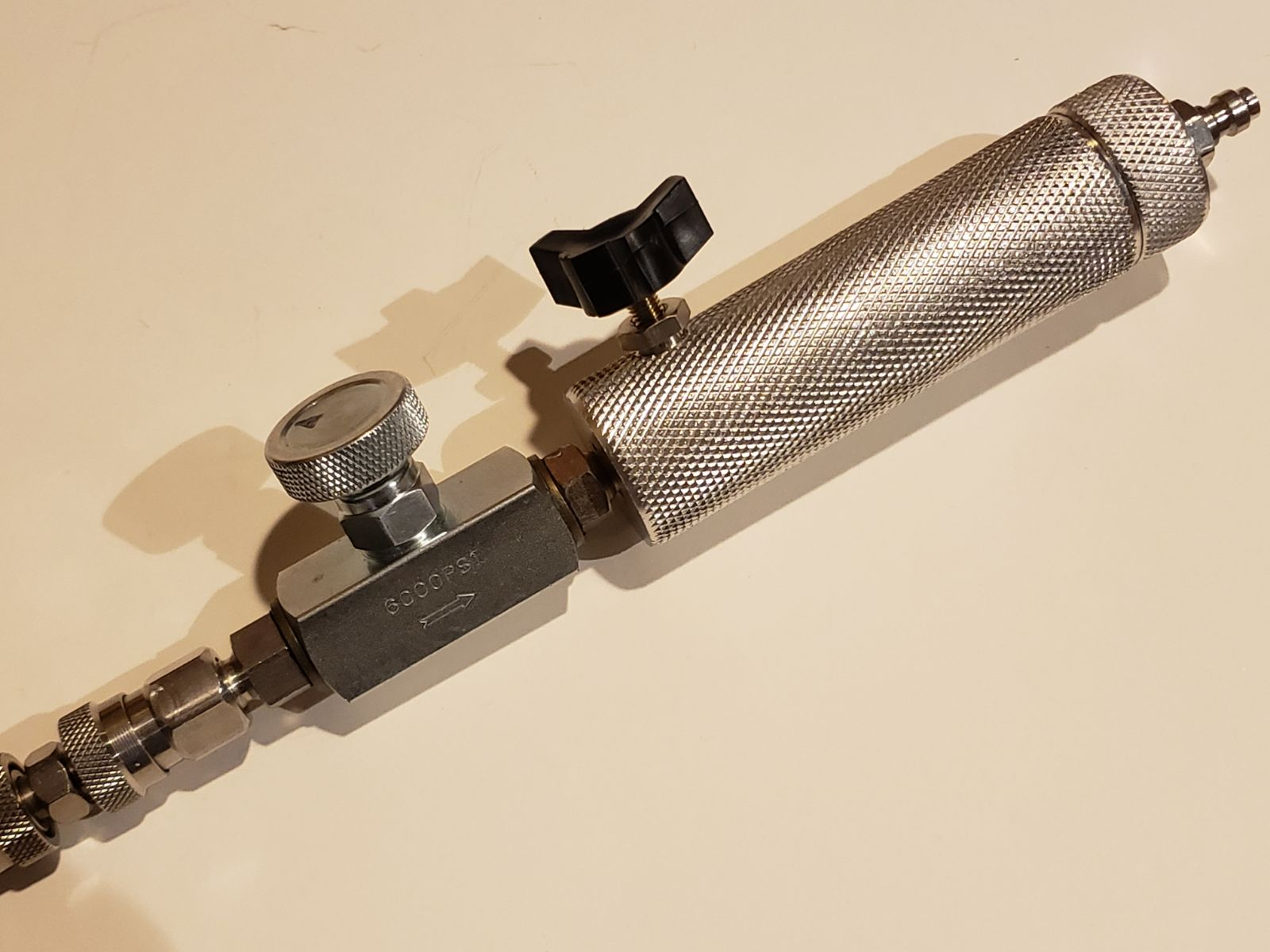

Here you go.

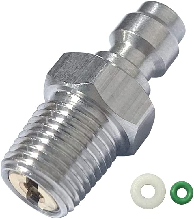

One Way QD Connector on Amazon $9.

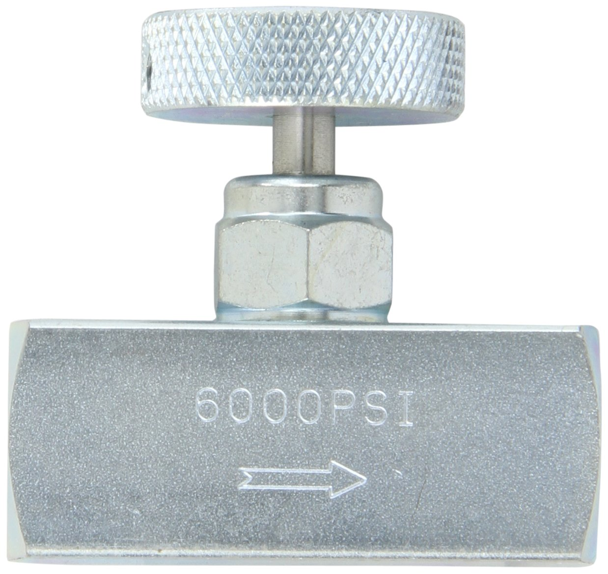

This shutoff valve below has been working well for me since November. $16 on Amazon at the time of purchase. It has a hole in the knob to insert a rod or some kind of tool, make it easier to turn when under higher pressures such as 4500 psi but I can manage it without the assist rod. I think some O-Ring grease inside the valve would make it easier to turn, but I didn't want to take it apart until it needs new seals.
You will need a bleed valve between the shutoff valve and the gun so you can disconnect it with pressure still in the lines on both sides of the valve.

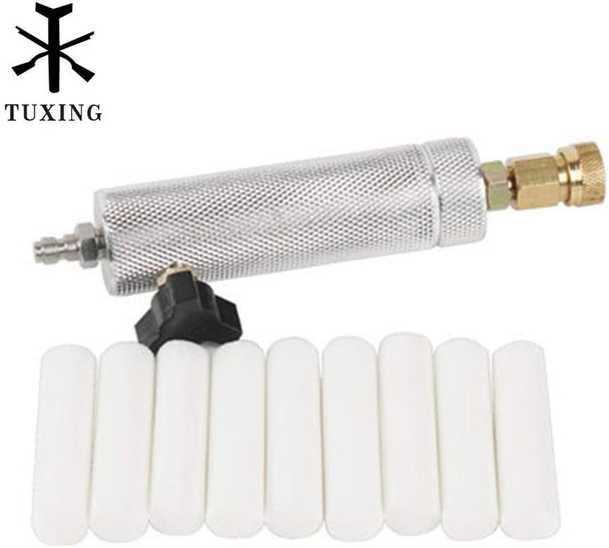

For that, I used this filter for $40 on Amazon that has a bleed valve built in. Currently $23 on Aliexpress or $27 with a whip. I use this on the gun side of my Yong Heng and my CS3.

Did you use a ¼" NPT to foster fitting to put that Amazon valve inline?
Sorry, I am not sure that the threads are. I just grabbed fittings out of my parts box and hooked everything up.
That sounds spooky. The valve you linked is ¼" NTP but everything on most of these Chinese compressors are 10mm x 1mm thread pitch. I think you can "make" a ¼" NTP thread into that metric standard, although I wouldn't think that's a good safe idea.
Everything matched threads perfectly, nothing was forced or "filled" with Teflon tape. The shutoff valve is steel, rated at 6000 PSI. All the adapter parts are steel hydraulic fittings, rated at 6000 PSI. The QD fittings are steel, rated at 4500 PSI or higher. The filter / bleeder body is aluminum, rated at 4500 PSI. There is no burst disk on the filter but there are three in the "system". One on the compressor, one on the large trap / filter and one on the gun. It has been a while so I had to go back and look at my original orders and notes.
