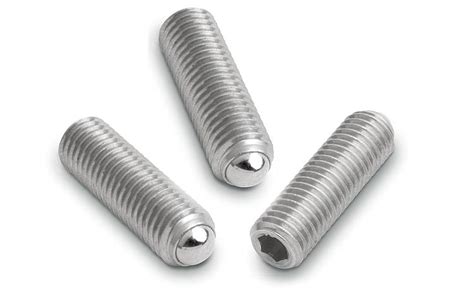

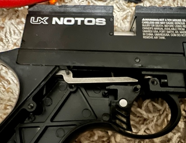

The trigger is a really simple fix, just grind the point on the end of the adjustment grub crew to a nice rounded tip and apply grease. It smooths it right out when that point isn't digging into the metal it rests against! You can also shorten the travel quite a bit which improves it as well.

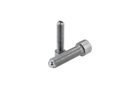

One thread i posted these roller tiped
I think the guy in that long notos 300+ post thread here showed somthing.. m3 is as small i found . But funny the solid ball type i cant find anymore . Reason was i swore he said that trigger screw was a m3 ? If its smaller like m2 - 2.5. I guess a guy could drill and tap to m3 ..
Of its a bust then im sorry for the suggestion.. my bad
Did you happen to try one of the above with a nylon or delrin point?
No .
But, i got some micro ball bearings so i thought a cup end grub, strong epoxy , and a ball from the bearing and set glue it in the cup of the grub screw .. why not?
I just now need a new 2.5 x10 grub to try it in a trigger i have in need of.

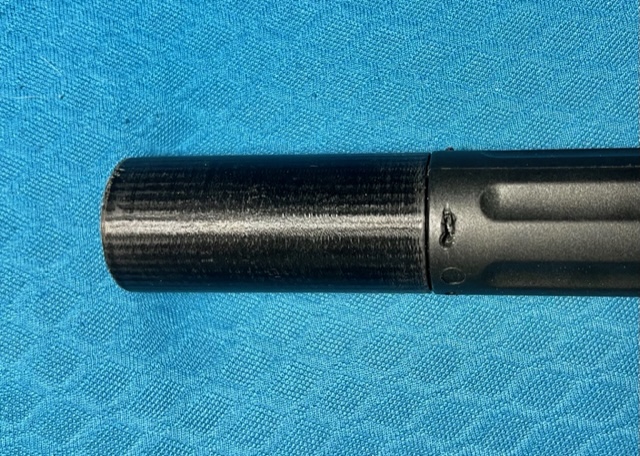

I hate to hijack this thread, but it turned out pretty good! It took 10 hours and 16 minutes to print, but it was worth it! All I hear now is the hammer slap the valve poppet and the pellet slap the Target!
Here it is installed. I kinda buggered up the housing trying to tap out the pins, so will need to clean that up a bit. I used 2 1.5mm X 18mm BUNA-N 70 DURA o-rings and the fit was nice and snug. The pin hole in the extension lined up perfectly! It's a very well designed baffle!
