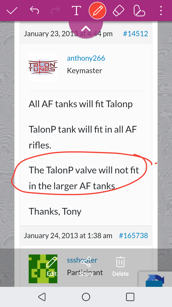

I believe that the large bottles I have (the ones that came with the talon ss) will fit a talon p valve which is the same direct flow valve as the condor but with the same bottle threading as the standard flow valve. That's what makes it an oddball. Since I have two large tanks that from what I have read have the same threading as the TalonP valve I thought I could save a little by finding a bare valve somewhere. I got this info from a very reliable source. TalonP and talon / ss use one type of tank (5/8-18 unf), Condor and Texan use another (M18x1.5).

I confirmed from Air Force that the Talon P valve will not work on any large bottles. Someone had told me that the talon valve was compatible with one of the other gun's bottles but it must also have been a lightweight gun with a small bottle. Odoyle and others were 100% correct.
