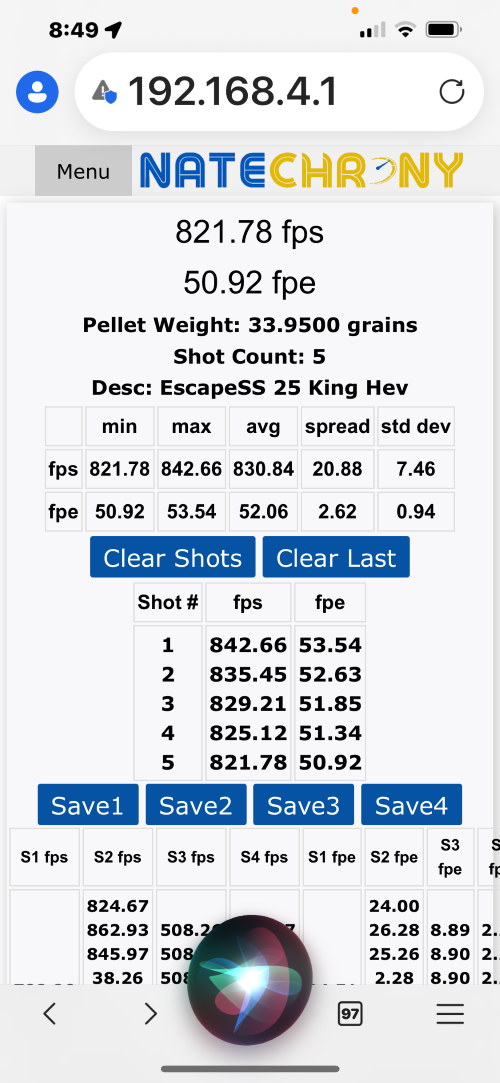

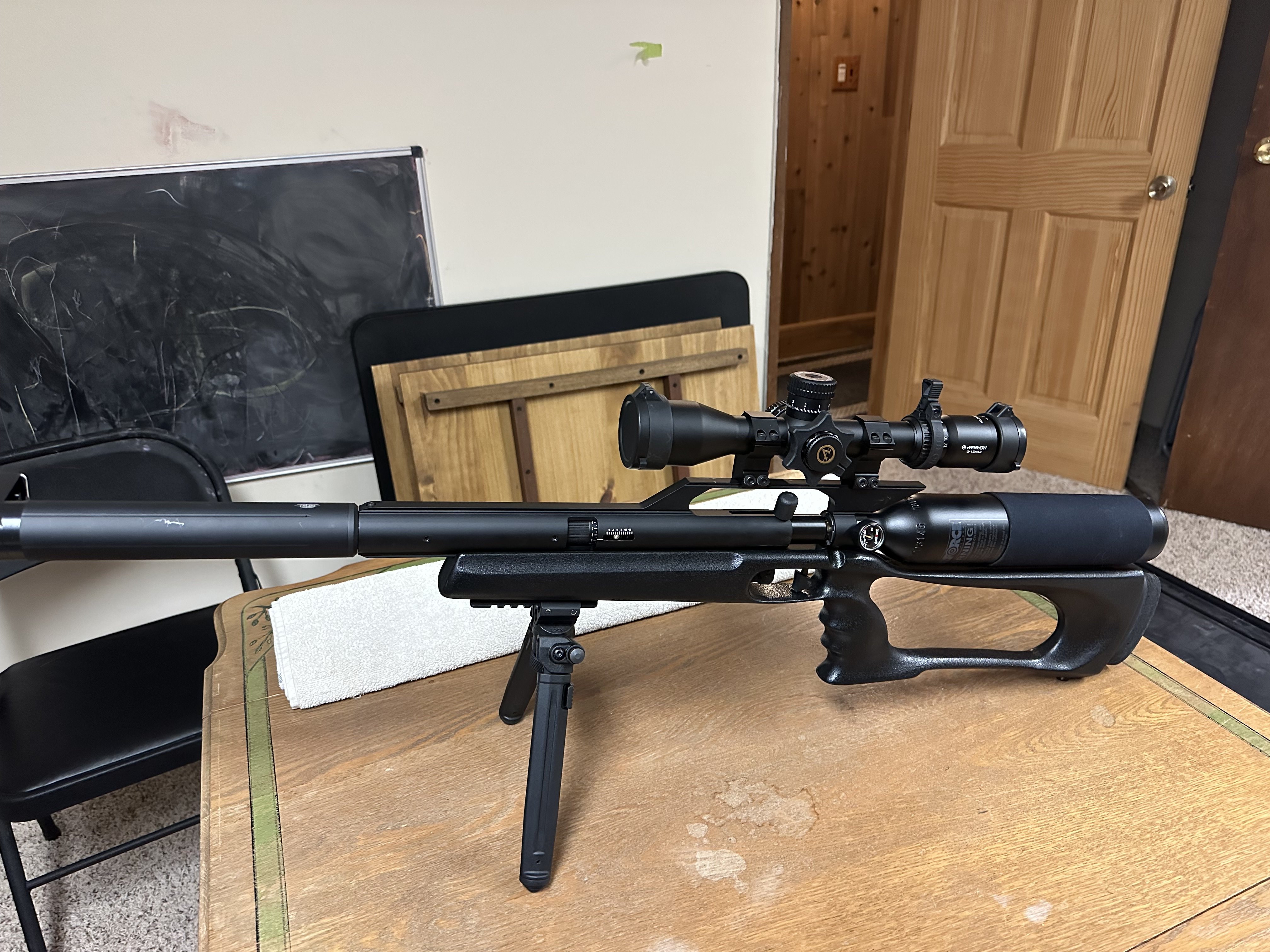

No, the gun I was shooting is an Escape SS .25 which is the same as a Talon P but with a built-in shroud/mod, with baffles. It has a 12-inch barrel and a small tank. I like those better than Talon P but they perform pretty much the same. I have 2 of them, one in .22 and another in .25. I do also have the Escape UL .25 with the 18-inch barrel and I love that thing even more. It's my favorite right now. I also have a Condor .22 with a 24-inch barrel as well.
As far as speed, yes, I am only at 8.95 on the wheel at this time and will be bringing it up. I am not done tuning it yet. I have been shooting different weights trying to find what it likes. I will be looking for low to mid 900s but I am using the Condor tank and valve on it at the moment but I believe they are the same valve. I believe the only valve that is different is the plain Talon which has reduced power.
Speed is not that much of an issue for me because I have a Zulus 5-20 with the range finder and BDC and it is dead on when you set the weight and speed correctly.
I have to many guns so am rotating them all the time to shoot them all and so it takes me longer to tune each one the way I want from shooting all of them. If I could do it over again, I would only have 2 or 3 but it is hard to find what you would like till you try them out yourself.
