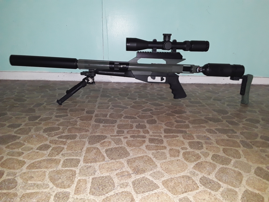

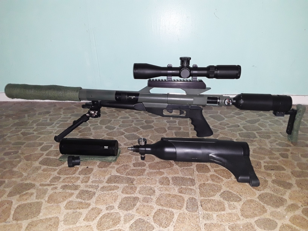

Set up as a carbine, with bullpup extension. Can easily change it into a pistol and add a red dot sight if I want more of a pistol.
I have a shorter LDC and 500cc tank to make full power.

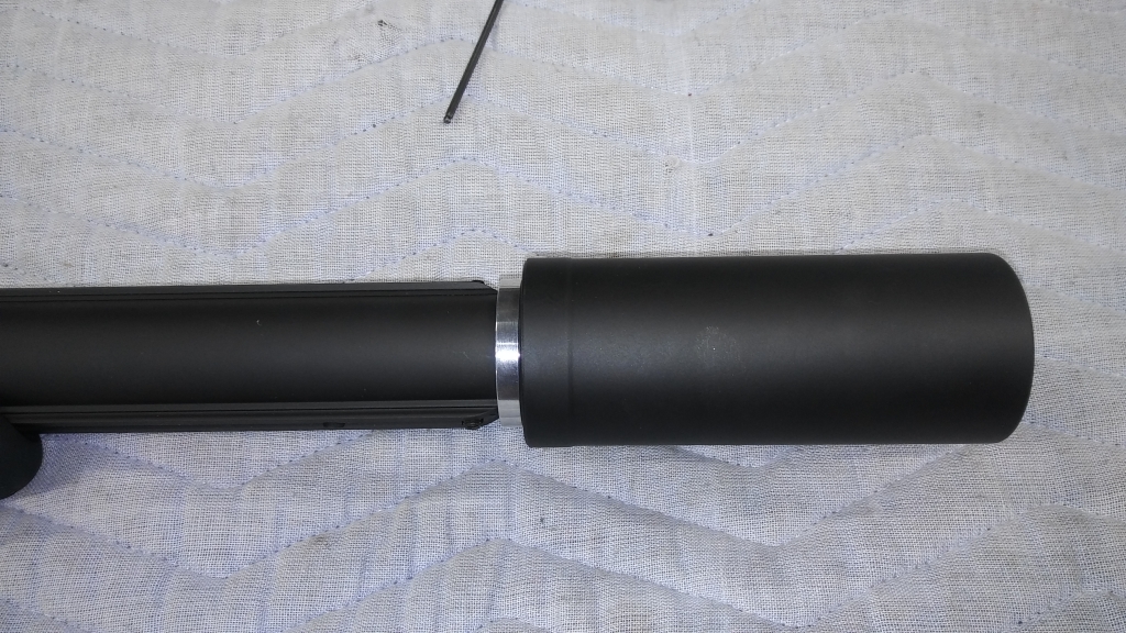

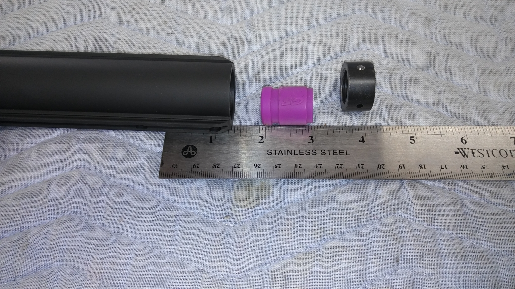

As proof of concept I fitted a piece of silicone tubing over the barrel, against the barrel bushing and cut it about 1/32 to 1/16 longer than needed so it would seal up against the mounting system for the AF can. 1/2" ID on the tubing. Available from a hobby store. It's used for coupling an exhaust header and pipe on nitro cars and boats. Looks like this...

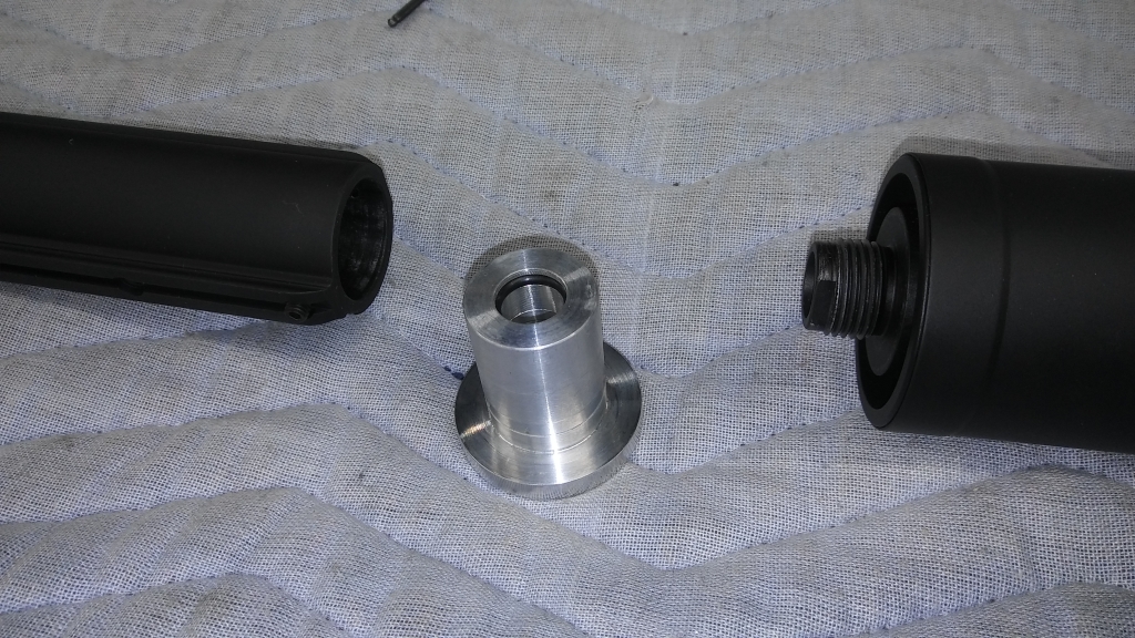

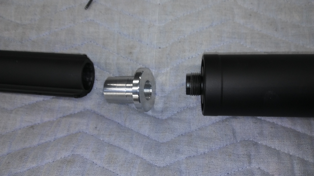

Worked way better than expected, so I made this.

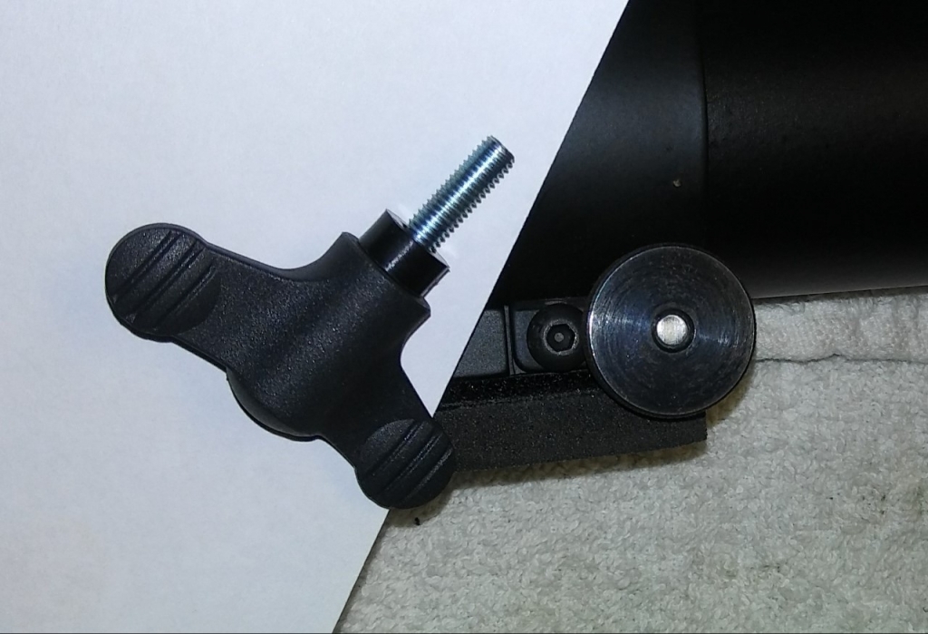

Completely sealed up, O-ringed to go over the barrel, threaded to fit the AirForce can. Held on with the original set screws in the gun. How did it work you ask? About the same as the tubing, 83db. Have so much more on the table to do on this project. Have to test different materials where I "stuffed" the baffles, make another adapter so my Sumo fits and test that. Hated the wing nut on the shoulder stock so I made something different. Lots better looking but for some reason the pic wont upload. More poop to post later.
