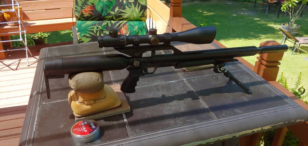

I've got one. it's not as quiet as my custom unit i built. it is close to 14" long. you remove the barrel end cap on the gun and slide it over the barrel and use the grub screws to hold it in place. its meant for the 24" barrels. it does have baffles inside. Not sure what the actual manufacturer of it was. the guy i got it from on here didn't know either.

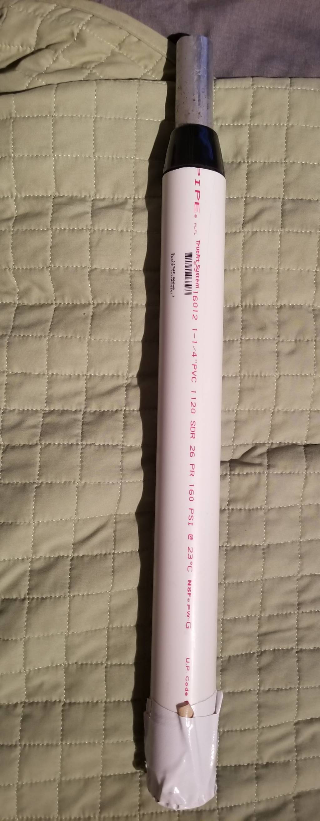

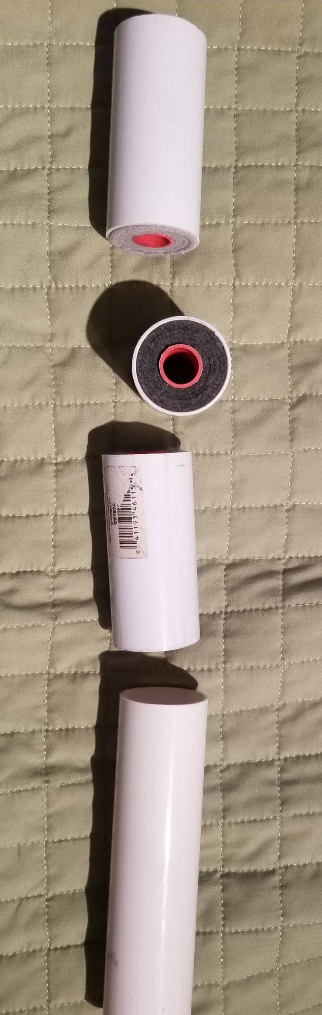

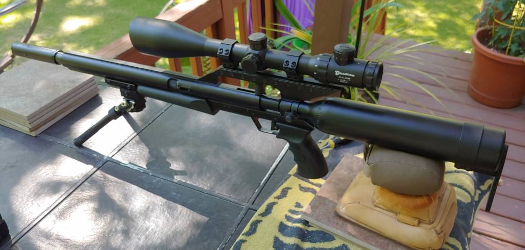

My custom unit is also a full pvc one. I used 3 different sizes to get a snug fit inside the frame. and the main body on the outside is the grey pvc. Made a custom barrel adapter to fit over the barrel that the unit slips over to help keep things in line. custom size and shape baffles. use felt weather stipping for sound control.
thats the nice thing about having a 3d printer. i can create just about anything. and if it breaks, i can assess the damage and make a new piece based of the issues.
