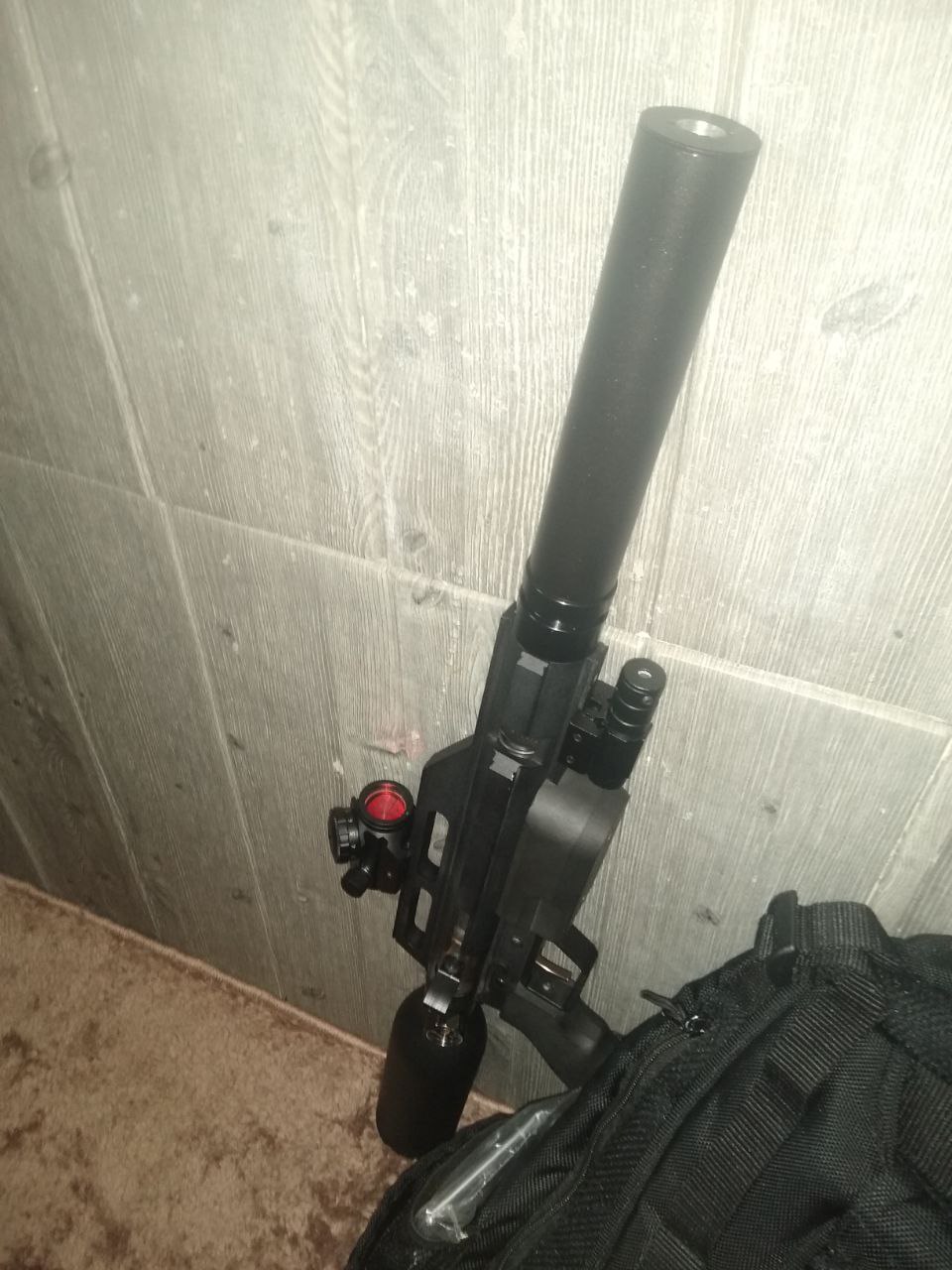

Condor owner here, but I think I can get you started on answers.
Your Talon SS has a 12" barrel, correct?
The SS barrels are 12mm, but if you put an 18" barrel on, it won't be an SS anymore. I think either barrel will fit in your gun, but you may want an end cap ("barrel cover") with the right size hole for the barrel to poke out of, and that plastic cap is usually included with the barrel. The 12mm barrel will be a little lighter in weight?
The 18" barrel should just about extend to the end of your Talon frame, so there is no room to slip a moderator on any barrel protrusion, however, Talontunes has moderators that slip _inside_ the frame where that plastic end cap would go:
Read the descriptions as some describe installation on your Talon SS gun with an 18" barrel.
I have the 14" Condor version (so I can double the gun as a walking stick), and note they are very high quality, robust items.
Best of luck!
Mike

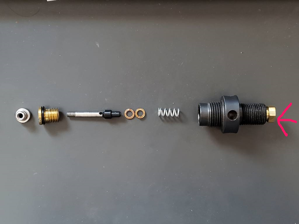

stem valve you mean that neck in front or back of the top hat?
by restrictor i meant that screw on the tank side, on my clone this has a through hole of 4mm, but the tophat opening is 6mm
Oh, cool!
Let me come up with names for the parts in your diagram so that I'm less confused. From left to right:
top hat (what I also called port), brass valve seat, hollow valve stem or "neck" with black valve poppet seal (?) on the end, 2 washers, valve spring, and valve body with... what would you call the brass bit at your arrow? A valve inlet? Inlet port?
At any rate, it was the valve stem that can be 0.25" or 0.28" in diameter in the OEM Airforce versions. One can just pull that part out of a OEM valve with the top hat attached. I've never seen beyond that.
This post shows some parts, but not the "inlet port" you're asking about:
I'm surprised there isn't a decent exploded view out there...
Mike

the brass bit is what screws inside the inlet to hold the valve spring and also acts as restrictor by means of a through hole(like a restricted transfer port)
the valve stem on the clones i've seen from 8 to 9mm(for ..30 and .35 caliber clones)
some are tapered some not, it seems the critical part is the area directly in front of the stem holes, and the larger it is relative to top hat's front opening less dificult is to keep the valve open(measured in lbs)
like this one i got recently the valve stem is 8mm and top hat opening is 11mm so at 3000psi i calculated 205lbs force to open the valve(Thanks RSterne) not counting the spring, this thing has a 145g steel hammer and heavy brass breech
