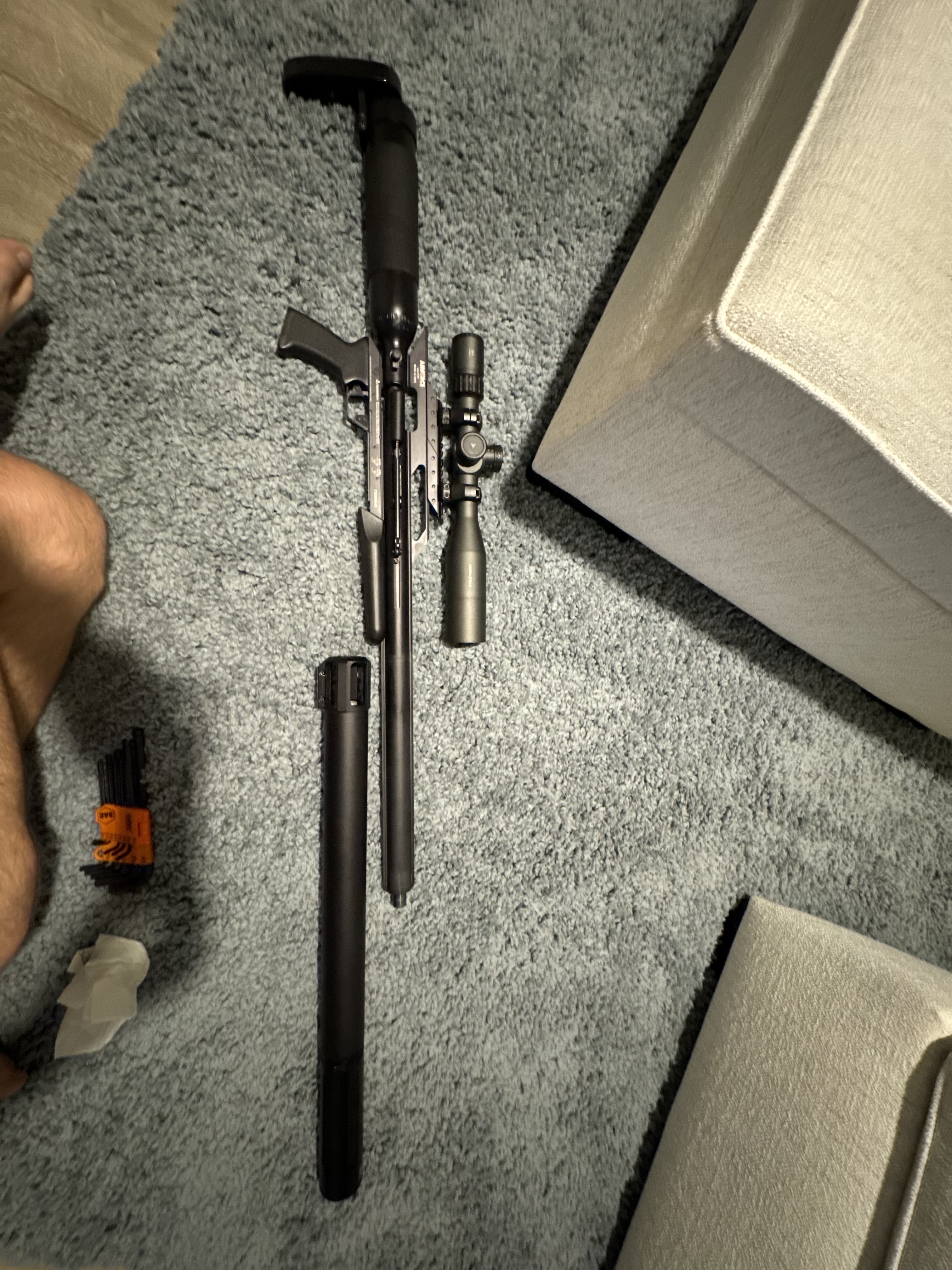

How did you get a .457 barrel in the Talon frame?
Dunno… it came that way
That looks like a bog standard .22 or .25 talon. The end cap is 1/2-20 and is about .35 ID a .457 can't go through that hole.

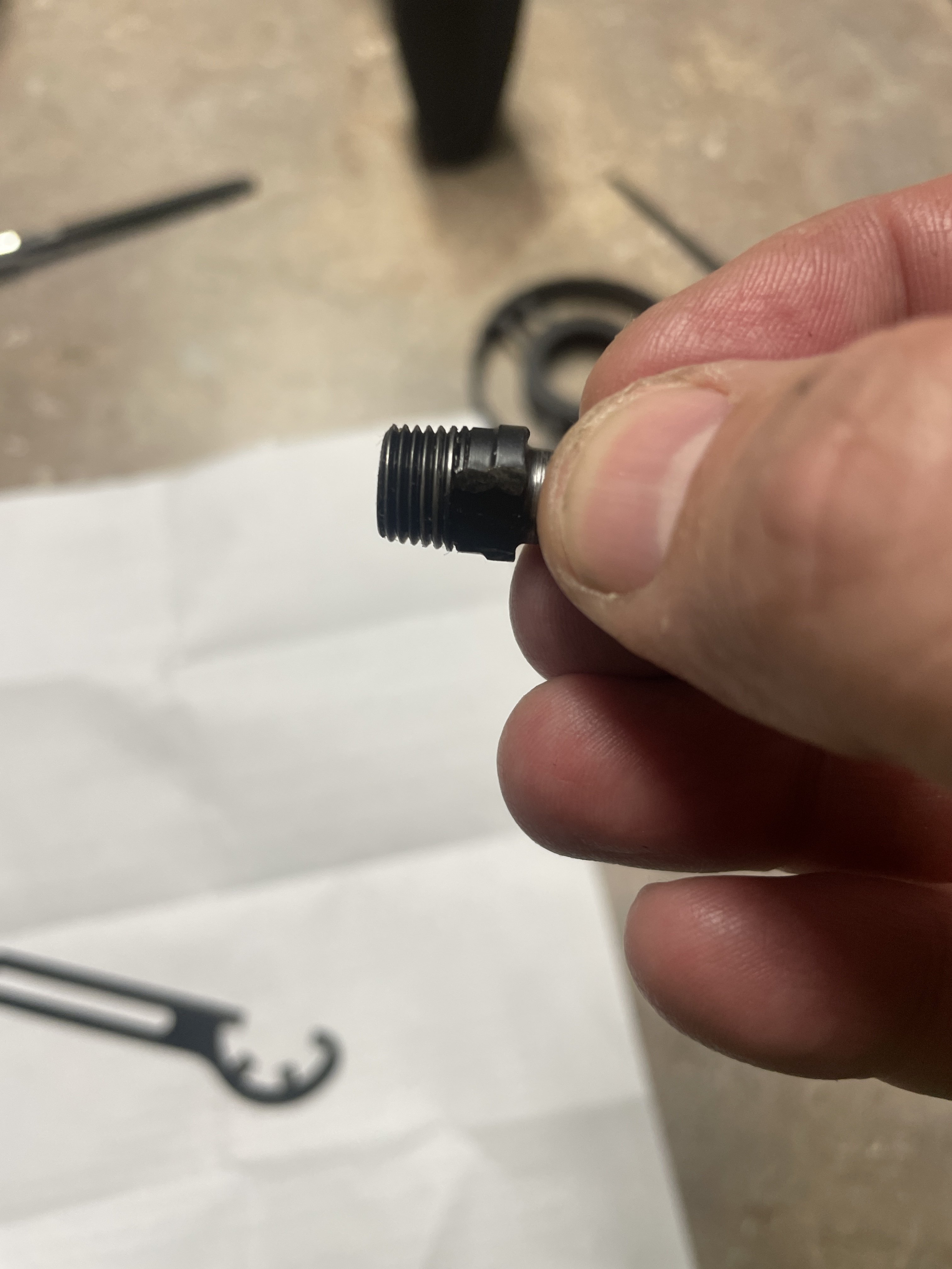

trying to find the male QD foster fitting threaded piece for it thus the need for information about threading type. as this appears tapered I’m guessing NPT Vice BSP.
This is the one removed
thank you for responding
If it is AirForce it is not BSP. My only guns with SAE thread screws. All the rest are metric or some BSP.
That is definitely a taper so that really only leaves 1/8 NPT.
