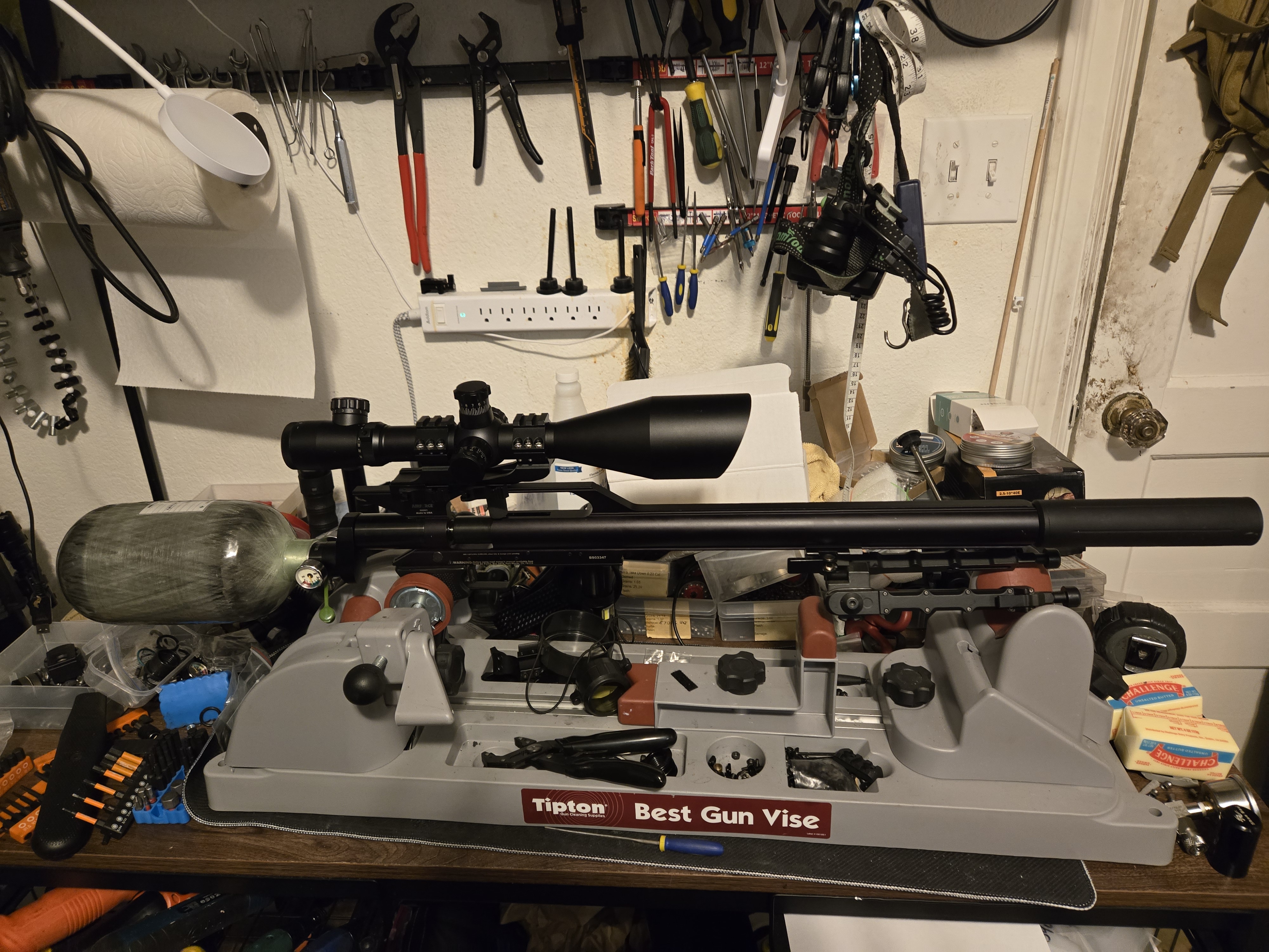

I picked up a non-working .22 Talon SS a month or so back. My first foray into AirForce. Didn't hold air and the seller was not mechanically inclined. Got it cheap :) .
Fixed the valve on the bottle, o'ring came out in 3 pieces. That made the gun serviceable. Fired it didn't chrony.
I had a 1.1L fat bottle from one of my less stellar *ideas* and figured WTF and ordered a Cricket Z-Valve from Huben Power. It arrived and is now installed with the 1.1L and in the "does it hold air overnight" testing phase.

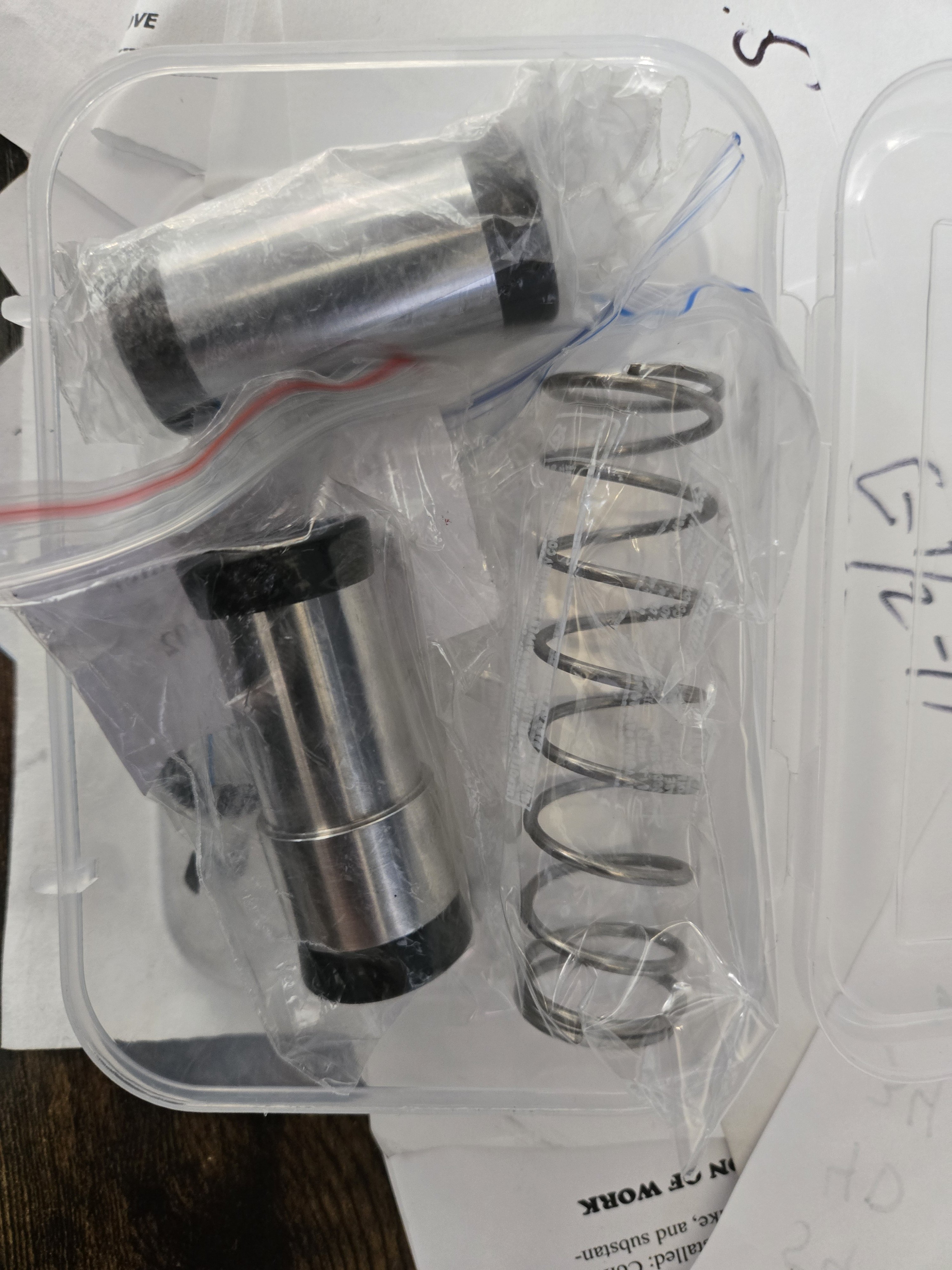

In the mean time I ordered a bunch of parts from Trajectron in India. Springs, hammers, Spin-Loc kit. The latter turned into a farce so that got put to the back of the queue.
Ordered some high flow (6mm orifice) internals for the standard valves from AliExpress.
Tomorrow I'll put it through the chrony and see how it works with the Huben/1.1L combo. Try some pellets and slugs, get the baseline with the same mid-point power setting.
Once all the parts are in I'll play with the high flow valve, 2 different hammers and a heavy spring. Probably start with the Huben Regulator to see how it does with the heavy hammer and spring. Then the high flow valve.
I have a Huben MAX-ATH Universal coming in so I may see if that 50cc plenum adds anything to the mix.

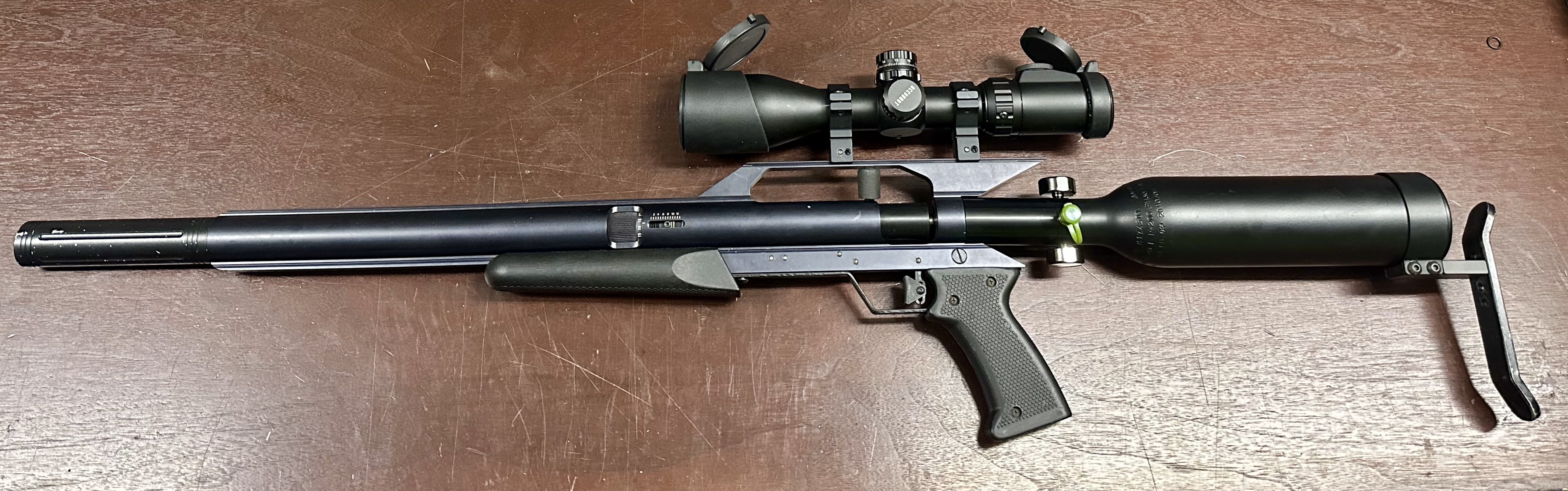

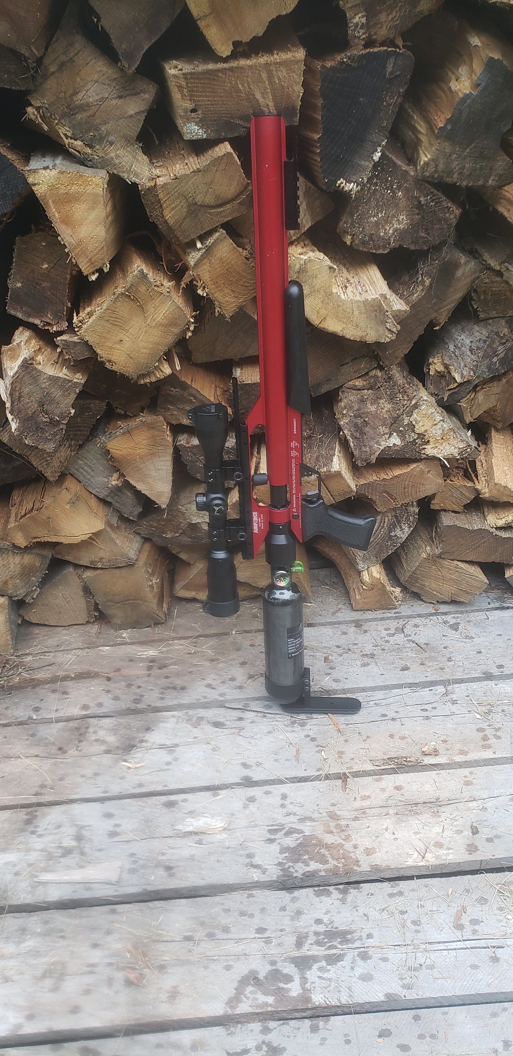

My latest AF pieced together while the weather has been poop here. Just a plinker in .177. Havent chronied it yet, but hoping for 12fpe. Short bottle on it to compensate for the reg so same LOP as with the longer bottle. I should repaint that shroud. The reg timed in at the gauges at 12 and 6. Doesnt bother me enough to try to re-time it.

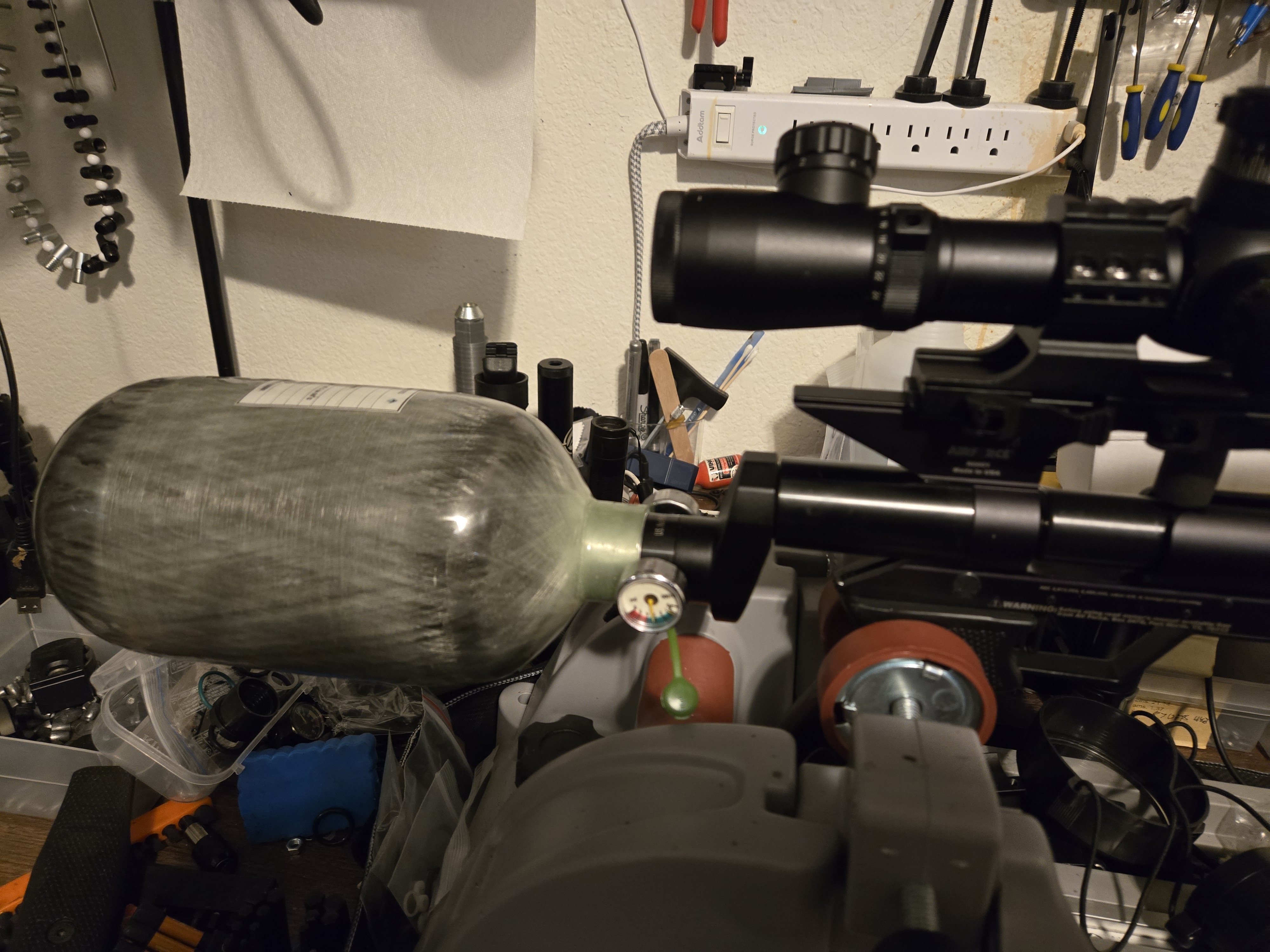

Spindle, I like what you have gong on with your SS. The bottle is interestin.
1.1L fat Acecare CF tank with a Huben Power Cricket Z-Valve.
Had the bottle from a previous experiment gone bad so I ordered the Z-Valve and there ya go.
I've put a good 50 rounds down range and the needle as barely moved.

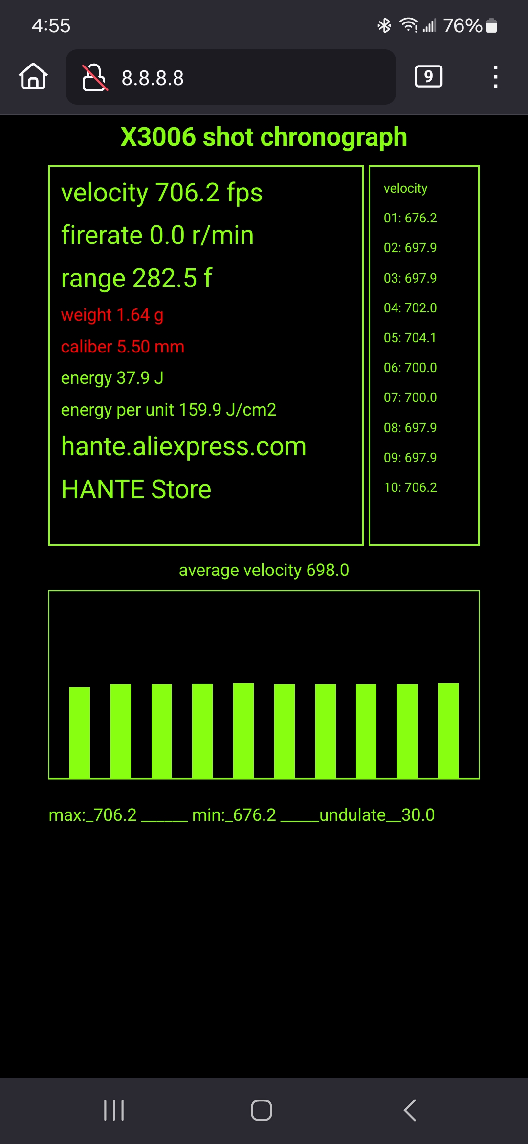

Started playing with slugs this morning.
Going to have to drain the bottle and increase the regulated pressure.
Was getting 650fps at 2200psi and 11 on the power wheel
H&N 36gr slugs
Probably go up to 2700psi

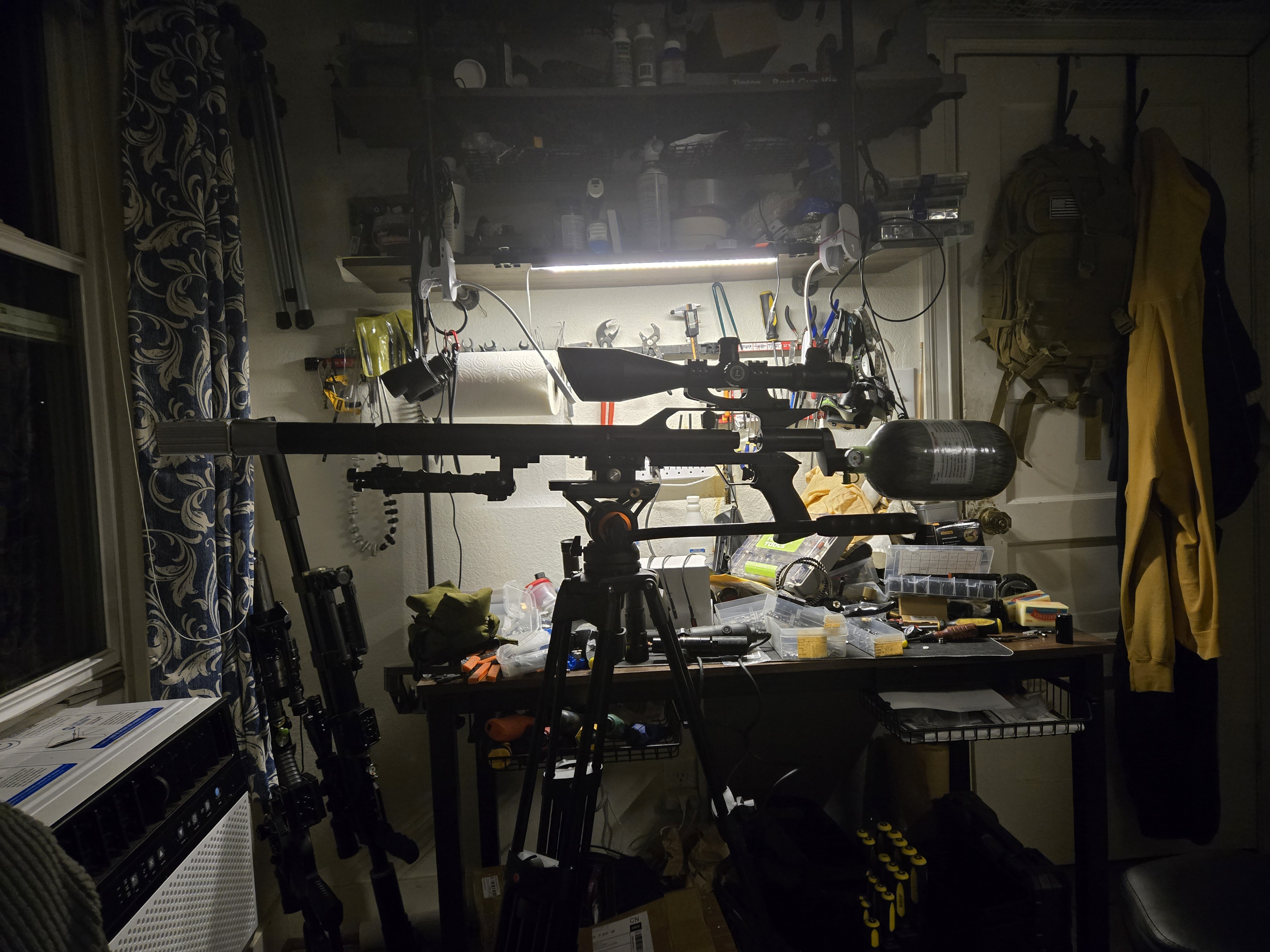

I shoot out the open window here in my office so weather is pretty much a non factor for me.

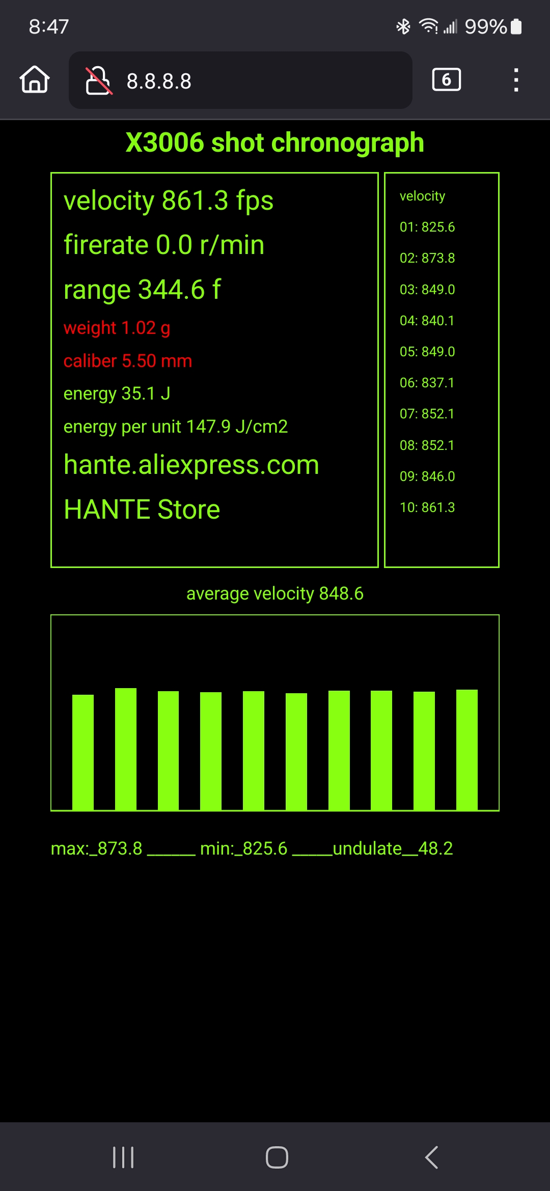

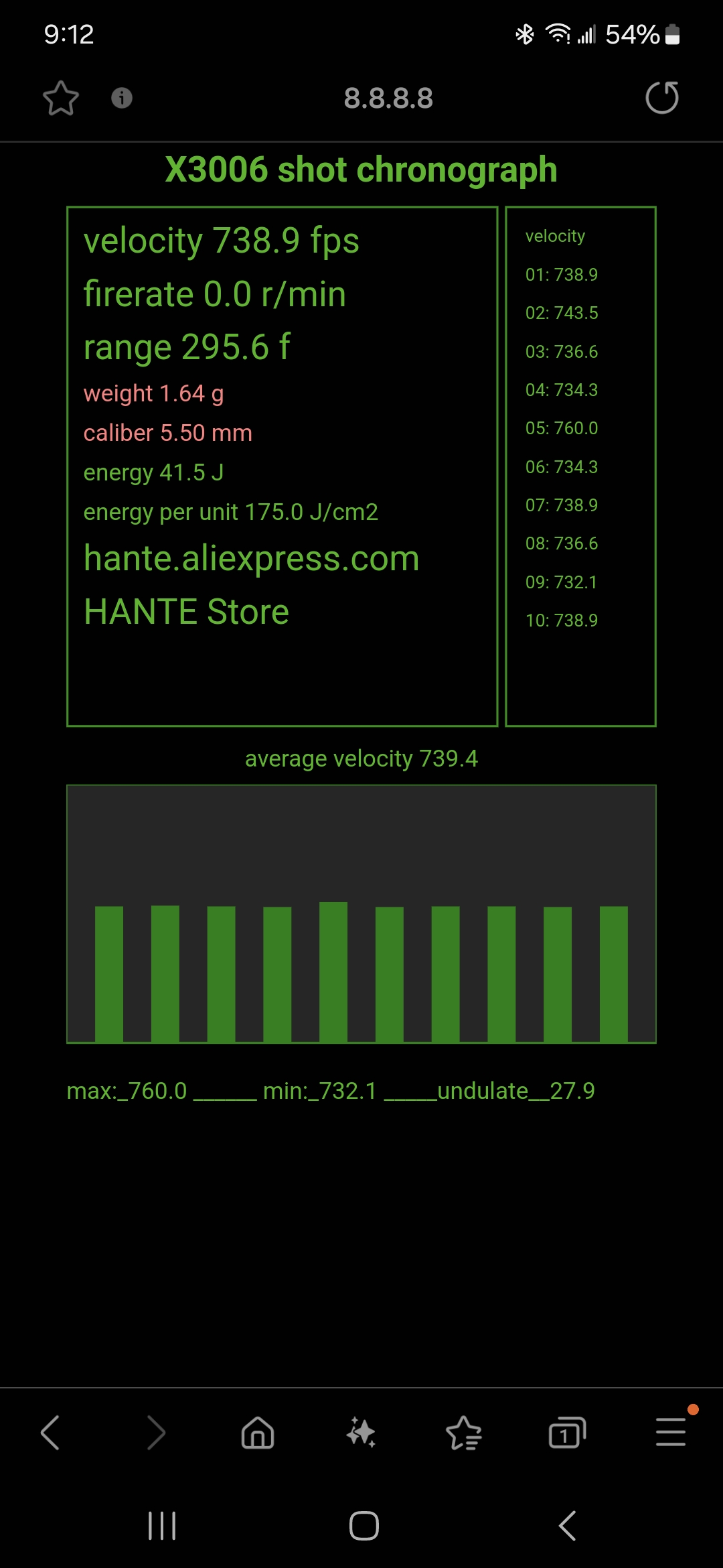

H&N 36gr slugs
Are you using the stock hammer? I have a talon ss .25 I put a huben cricket 50cc reg on and had to increase hammer weight after I turned the reg past 1400psi. I'm at 1700psi now, any more than that and it started slowing down. getting right around 775 fps with 26gn hades. Very accurate and tons of shots. Just put a 18" .22 barrel in it last night. My cheap china chronograph only reads up to 1200fps. The first shot was 728, after that one I can only guess they where going faster because it stopped reading and got really loud! I bought a mod adapter from talon airguns but the barrel sticks out to far to use it. Think I'm going to turn the end of it down and thread it. Might get the caldwell out in a little while and see what it's doing with these 18gn pellets.

At the moment, I have 75g and 90g hammers and a heavy spring I just received from Trajectron the other day. The high flow valve is in route.
Hammers were $18 and change.
