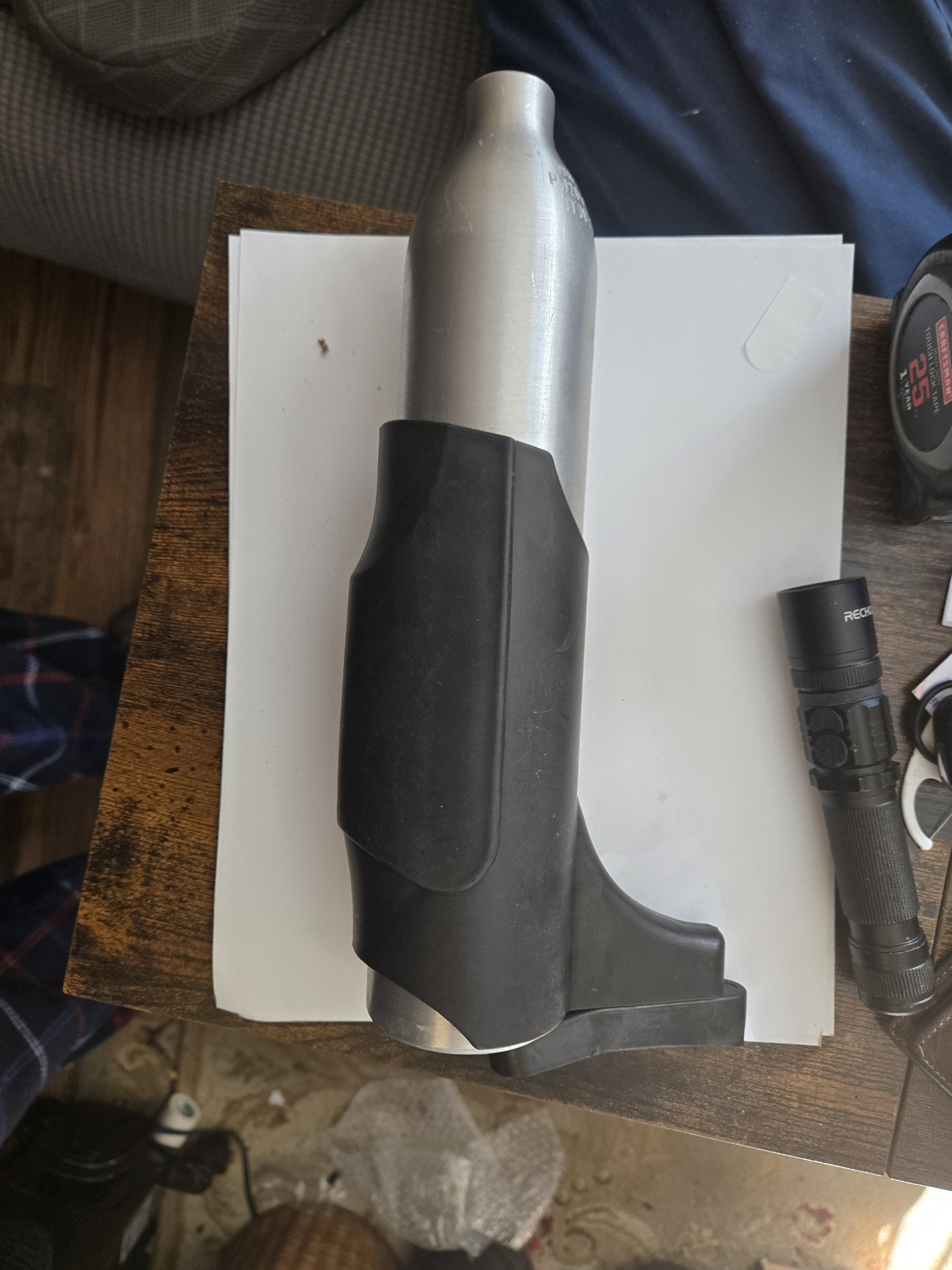

Yep, only works on bottles 60mm to 61mm.
So that ad lies, will not work on a Texan, they have bigger bottles than the Talon or Condor.
I could beat it on to my 0.5L CF (61.5mm) and then had to cut it off because I couldn't turn it to get it clocked.
Less than $10 on AliExpress, just cheap fairly hard plastic.
I bought 2, my aluminum 0.5L (60.5mm) is fine, can clock it, but I want one for my CF bottle.

Yeah, emailed MCS after I found out their AirForce PCP buttstock didn't fit.
They offered return for trade.
But it is just a cheap plastic tube with a tiny cam lock.
I'm unimpresed with their offerings.
Maddog's stuff is WAY outside my budget.
Trajectron has a metal one for $120.
But I'll probably end up here:
They literally have a CF bottle option for $95

I have a buttstock from Aliexpress in route to use on a 500cc carbon bottle build. I think you can use a heat gun or place it in hot water then position it quickly on your bottle. Should work and if not only out a few dollars.
I didn't like them, just plastic and hard plastic at that.
I tried the heat gun but the plastic in the center is just too thick, you start melting the outer layer well before the inner, and important, later even gets warm.
I also wanted something I could use on different bottles and they surely are not that.
I went with this one:
