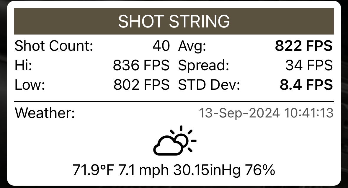

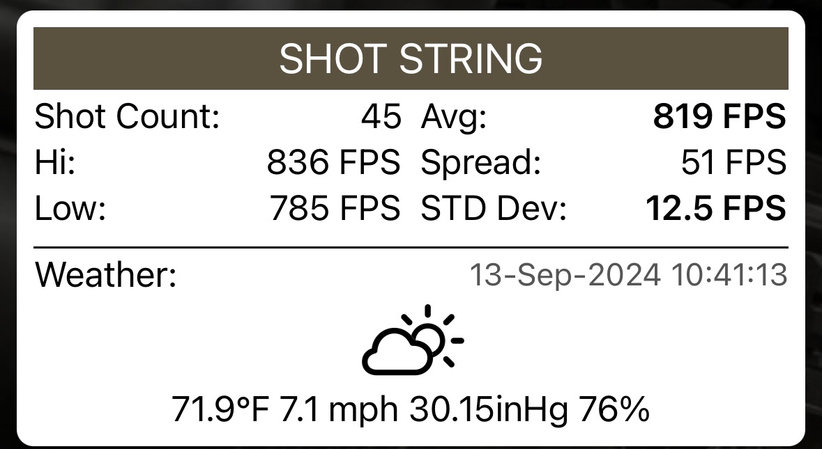

okay, so, ive done some testing...and yeah it looks like you're 100% correct. im chalking up my early results as a "break in period" or something because it used to shoot very consistently from 2800psi down to ~2000psi (weather could have also been a factor considering it was at the end of winter when I got this gun)...but here are the current results
this is the shot string from 2400psi down to 1900psi.
and this is 2400 down to 1800
so its looking like im going to be filling to 2400psi for now on, hopefully the barrel likes this speed :)
