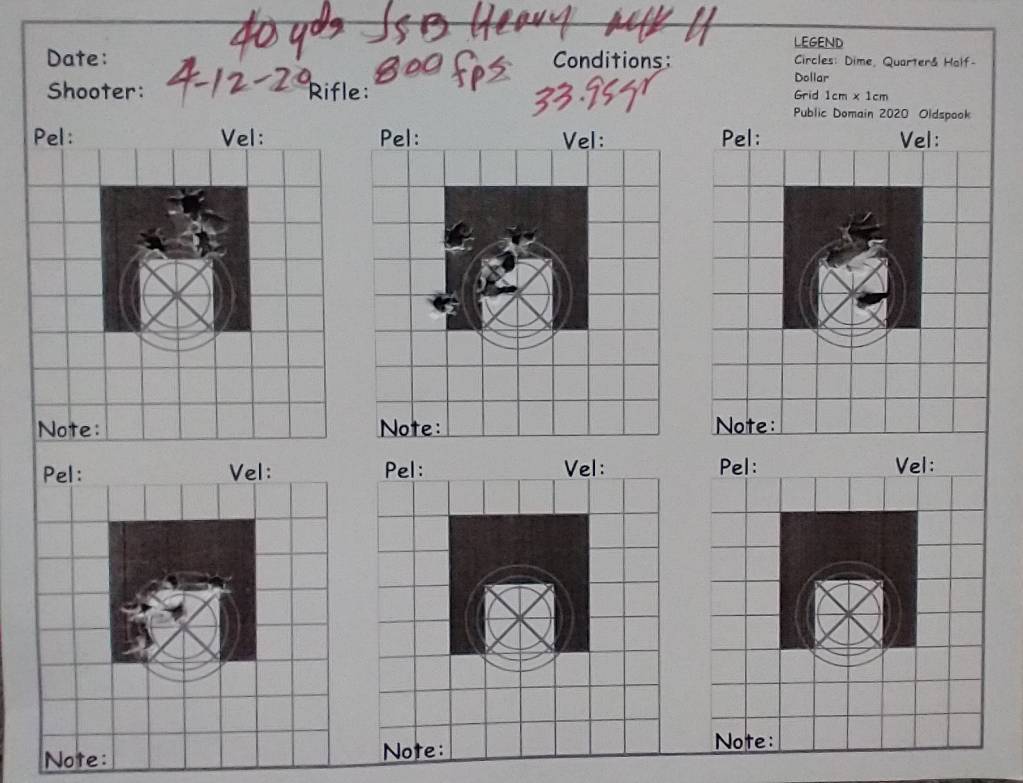

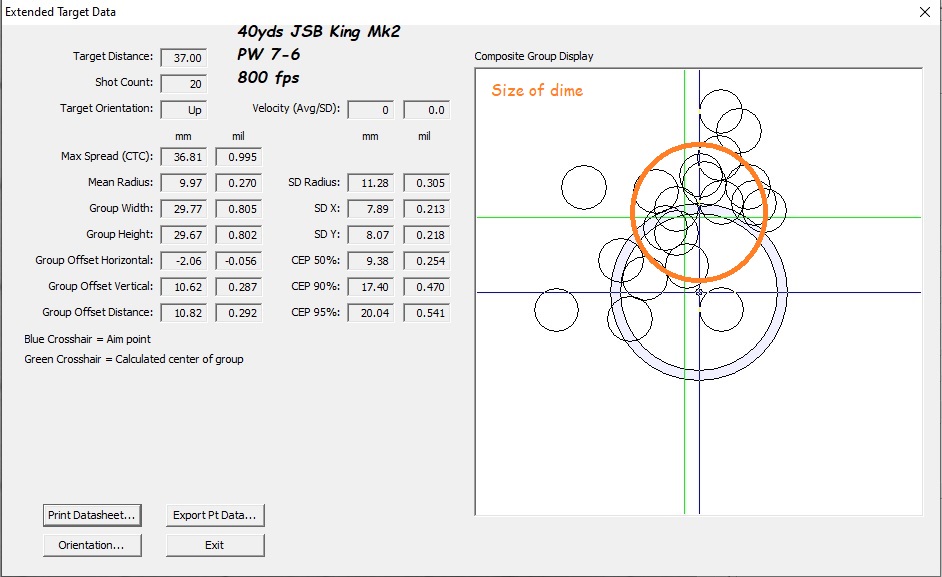

I'm done with this exercise. I have built a fine little 50 yard squirrel rifle. I did not explain how I shimmed the scope in this thread because I explained it in a different thread. Today I caught an onshore breeze which was fairly consistent so I shot the test groups that I needed to do to select a pellet for the rifle. It isn't really picky.

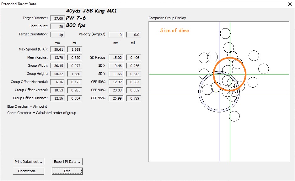

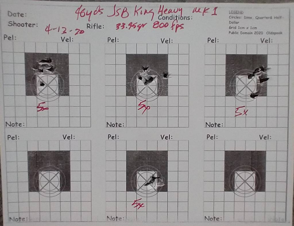

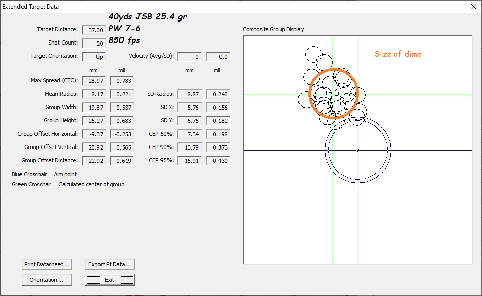

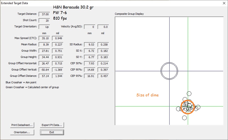

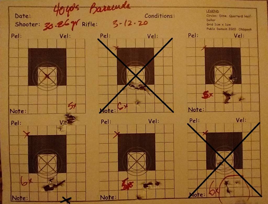

The squares on the targets below are 0.25 mils at 40 yards (just under 1 MOA square). Each target was started on a fresh bottle. Only four five shot groups were shot on each target.
Shot with power wheel set to 7-6 (I could probably squeek out another 10 or 15% but this is good):
JSB Exact King Heavy 33.4 grain pellets at 800 fps, 47+ fpe, 20 shots/fill
JSB Exact King Heavy MkII 33.4 grain pellets at 800 fps, 47+ fpe, 20 shots/fill
H&N Baracuda 30.2 grain pellets at 810 fps, 44+ fpe, 25 shots/fill
JSB Exact 25.4 grain pellets at 850 fps, 40+ fpe, 30 shots/fill
Very nice to have all four of these pellets available on the same power wheel setting with these power levels and shot counts. The Seneca's did not shoot well enough to post the groups. They were shooting at about 54 fpe.

I think any of them can be made to shoot well enough to be a fifty yard squirrel rifle with nothing more than the right pellet, a good match of power wheel setting to pellet and an optic. This is by far the easiest air rifle I've ever worked on. You don't have to have all the crap that mine has in it and on it.

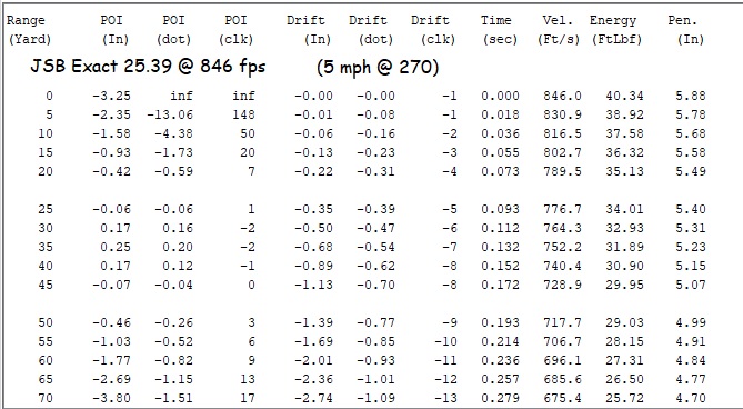

This rifle is for sure a 50 yard squirrel rifle as it sits, no problem at all. Look a the ballistics and the groups. Ninteen out of 20 shots touching a dime at 40 yards and a half inch of drop after that delivering 29 fpe at 50 yards? Of course it is a fifty yard squirrel rifle all you have to do is your part. I wouldn't call it a squirrel rifle if I didn't think it would do head shots at that distance.

The rifle will put 19 out of 20 shots on a quarter at 50 yards if I do my part. That's a head shot on a squirrel. It will put 29 foot pounds of energy on target at that range. That's a kill even with a transverse body shot. There aren't very many .22 rimfires that can put 19 out of 20 shots on a quarter at 50 yards and every one of them comes with a "one mile" caveat. Now before you decide to tell me that isn't true, show me your target. We have both been around the wagon once or twice, but I will warrant what MY experience has taught me. I had a Marlin bolt rifle in .22 that would do it. Never seen another rifle I could count on to do that with the same regularity that didn't turn a squirrel into hamburger.
