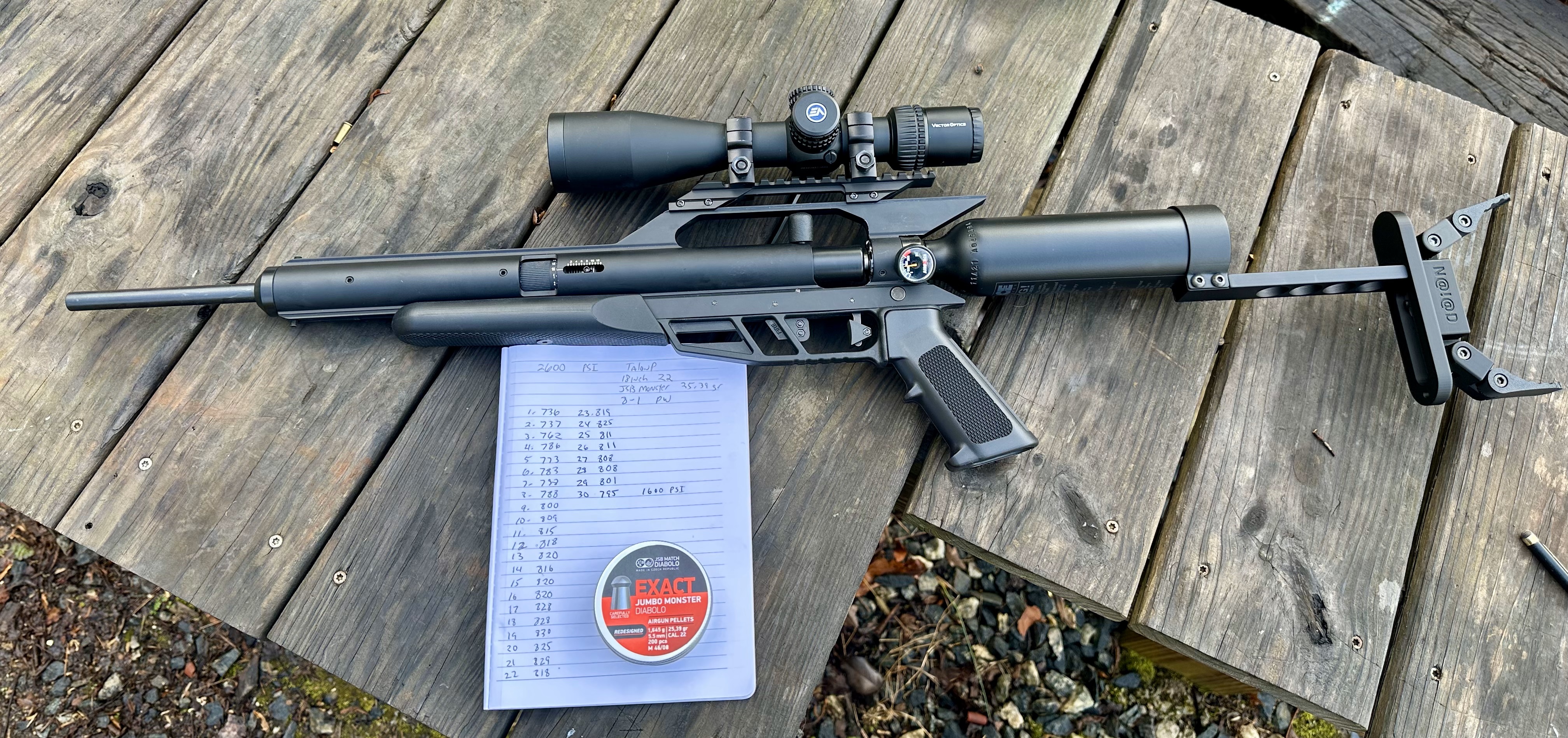

Recently got a renewed interest in AirForce guns and picked up a lightly used TalonP. Had planned on putting a larger tank on it (and may one day, who knows?) but pleasantly surprised with the small tank.
It came with a .25 barrel and I threw on an 18 inch .22 barrel I had laying around. My goal was around 800fps using the 25.39gr JSB Monsters. After some inspiration and guidance from @Mike_Lenardon on what what possible on these little guns, the weather broke enough today for me to do a string.
.166 top hat with o ring behind it, 18 inch, .22 barrel, JSB Monsters, 8-1 PW. As you can see, I filled to 2600psi, but should probably only fill to 2200 or so. Still, an impressive string if I do say so myself. Definitely happy with the results. A rough sight in later had me grouping really well out to 40 yards and acceptable at 50. Very well could tighten up those groups. I wasnt even using a rear bag, just a rough sight in.

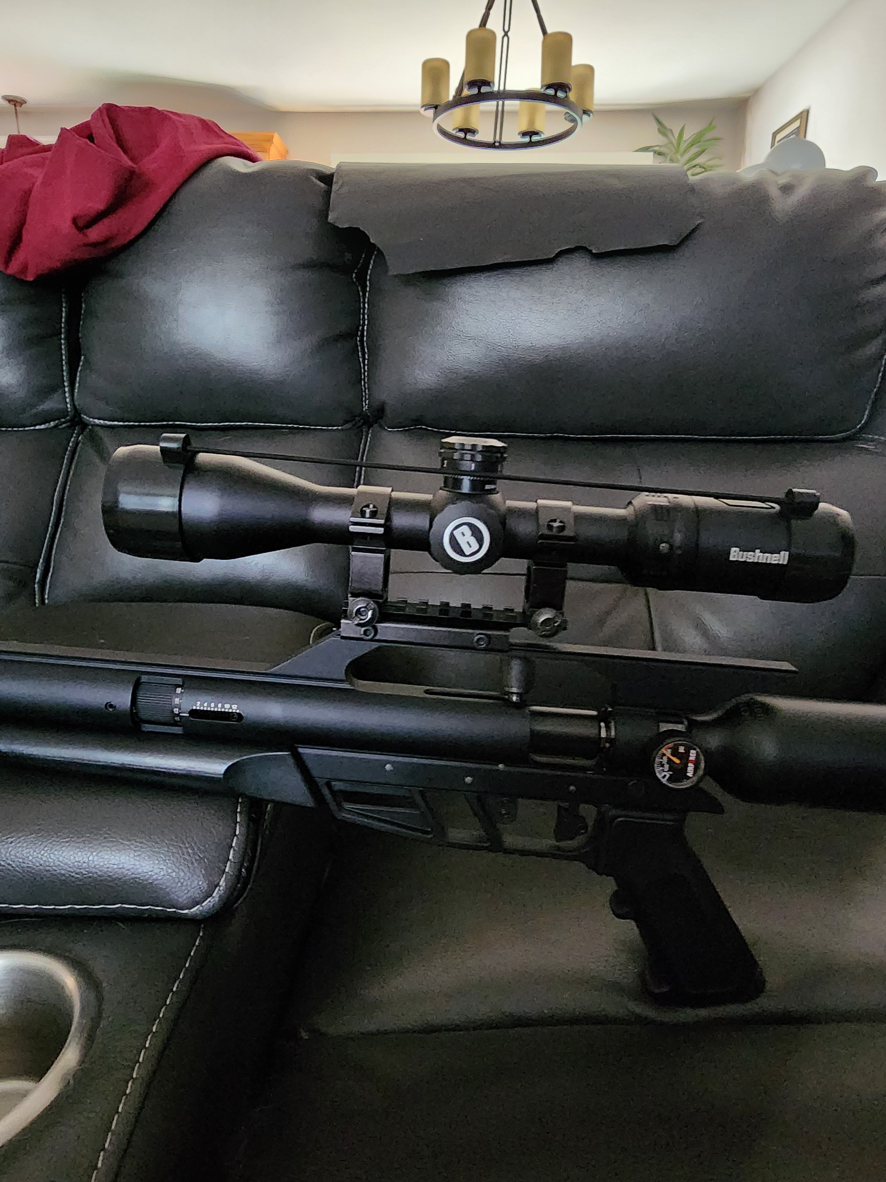

While at it, had threw together a little 18 inch barrel .177 with a micrometer tank on another Talon and was getting around 600fps with 8.44 gr. I'm not sure if I'll keep that configuration or change it up but I do know the TalonP will not be changed at this point.

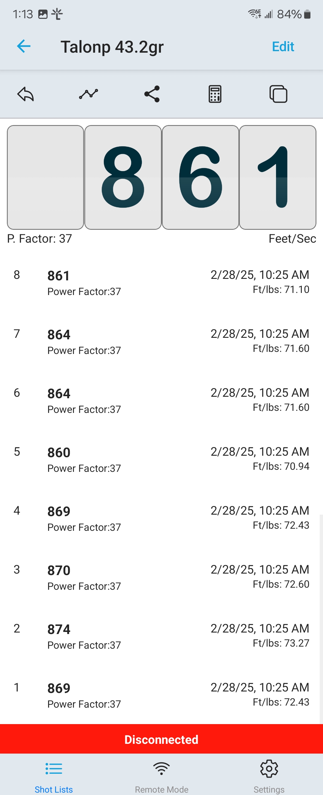

The gun was sitting with 2450 or so in it, so I started shooting Baracuda 21gr.
884
869
874
884
889
877
884
876
879
880
879
876
875
870
The last two were louder so it fell off the pipe. I’ll pump to 2600 and see what the full string looks like, but this is very promising.
