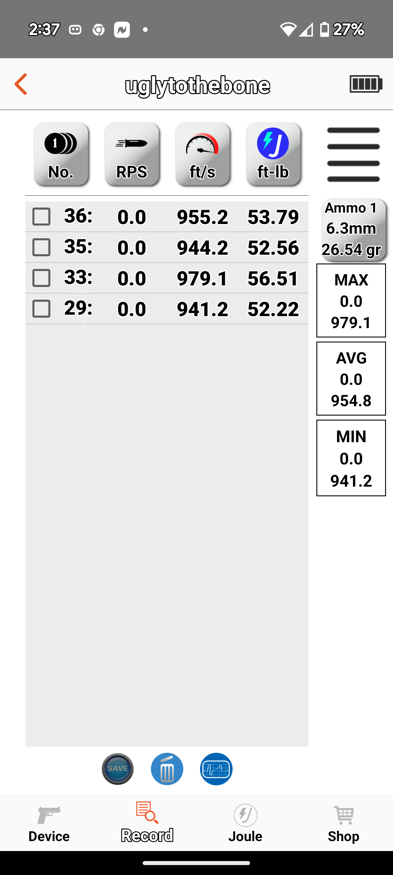

Salutations, I am in a bit of a situation that's haunted me at night for 2 weeks. I shoot "Black Bob" my wicked custom TalonP without a Regulator / Diablo Hades 26.54 / Wheel on 7.5 / 3100 PSI with a max of 979.1, average 4 shot string (Only one I had saved) 954.8.

Unregulated my average drop is about 22 to 24 Fps per shot & Regulated I'm still dropping about 17 Fps per shot🙃

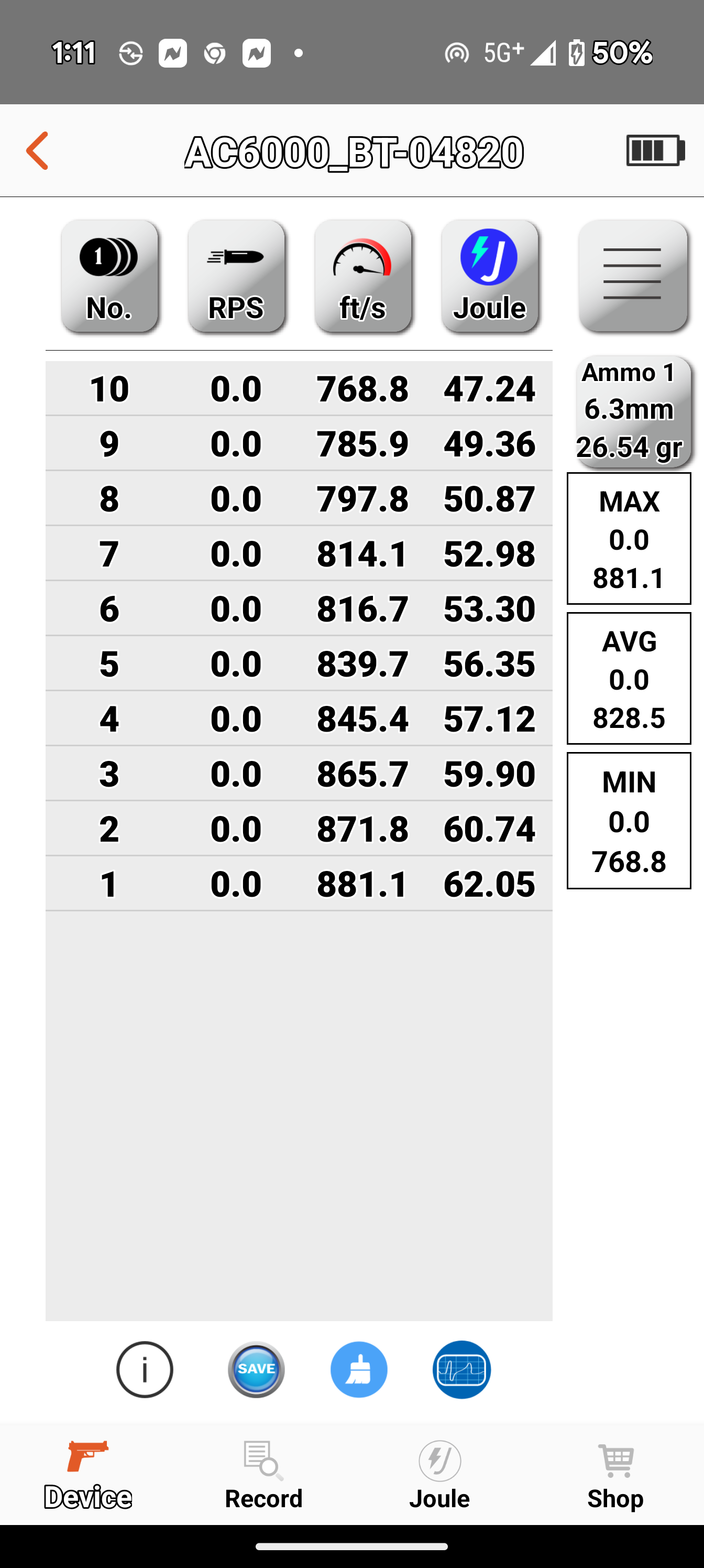

Well lowered it 7 notches & doing the math got me down to 2320 on the Regulator. I shot a 10 shot string being it was 4° out here. Have to thank you again because for as much PSI as I lowered it on the regulator it's still a great starting point. Now in that string I have two shots that dropped 20 psi where the other ones were between 3 & 5. Is that normal to have one do that once in awhile??
I have no experience with Air force guns, but have you considered lowering your reg set point to 2000 psi or even 1800 psi? You'd have more regulated shots but might sacrifice some power. You might also try a lighter hammer strike? Your shot graph looks like the classic cliff from too much hammer strike.

Too much hammer dwell and too small a plenum, maybe?
My .22 Talon SS has the Huben Power Cricket Max-ATH with the 50CC plenum. I have a high flow valve, heavy spring and 90g hammer. I get VERY consistent FPS with a heavy pellets, about the same as your .25.
