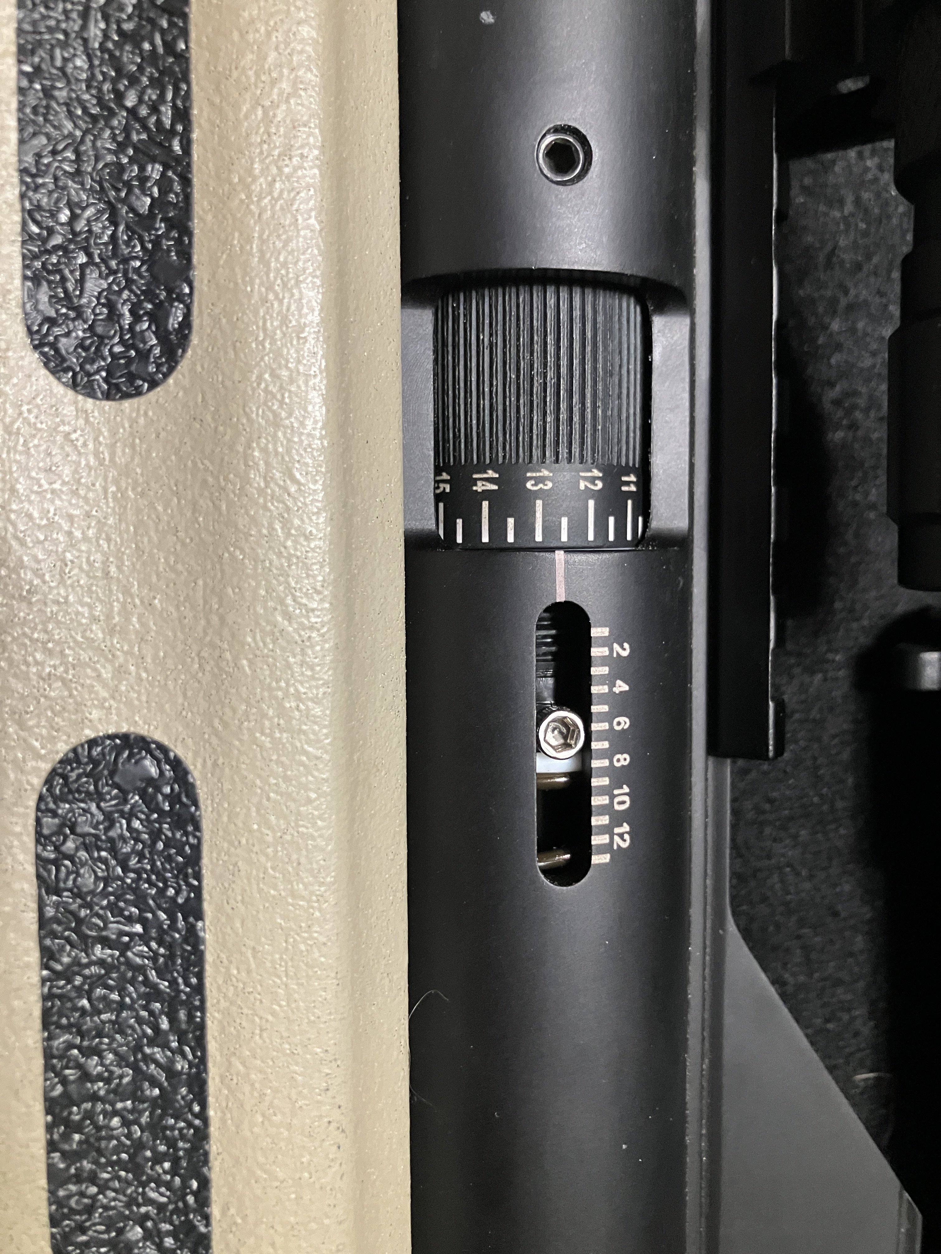

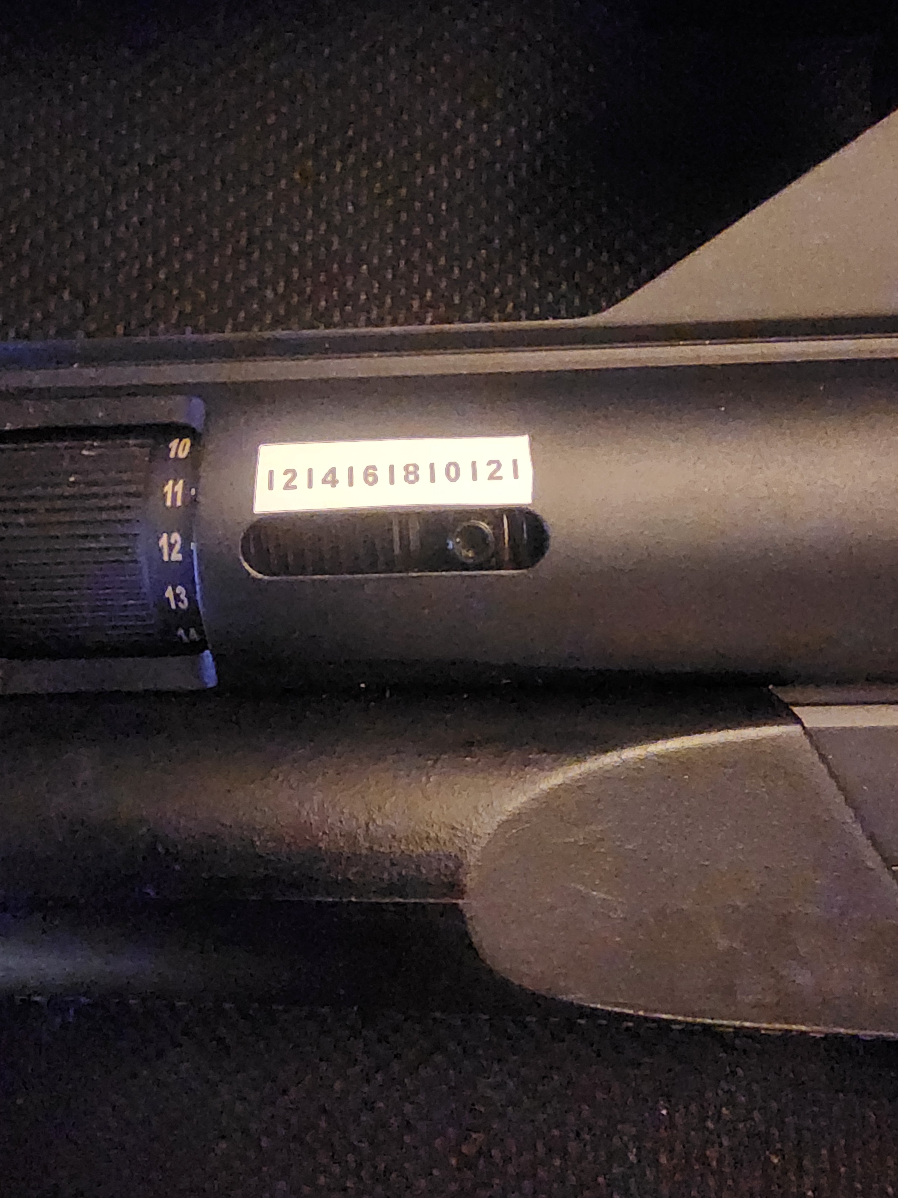

So I received my new talonp in the mail today and one thing I noticed right away. If anyone that has gotten a new talonp recently can confirm this. Or is it a manufacturer error. The power screw does not have the numbers and lines to know in what power you are is just blank.

as others have already said, your numbers are definitely just missing and is an error in the manufacturing. as far as the safety issue goes, sometimes it is possible that when you cock the gun you can get the bolt to lock open without "unlocking" the safety. when this happens if you push the bolt forward again you should hear a little click, then you should be good to go.
Once you realize what a great gun the TalonP is, you will be satisfied. You did get an odd ball with the numbers missing. That is a good tip about the bolt being fully cocked to engage the safety. I personally own 4 Airforce guns and have never had any problems with any of them except for fill nipples. The people at Airforce are easy to work with and if your gun is registered the warranty will usually provide you with the parts to repair yourself. I like the light weight and power which makes it an ideal woods toter, not to mention the accuracy.
