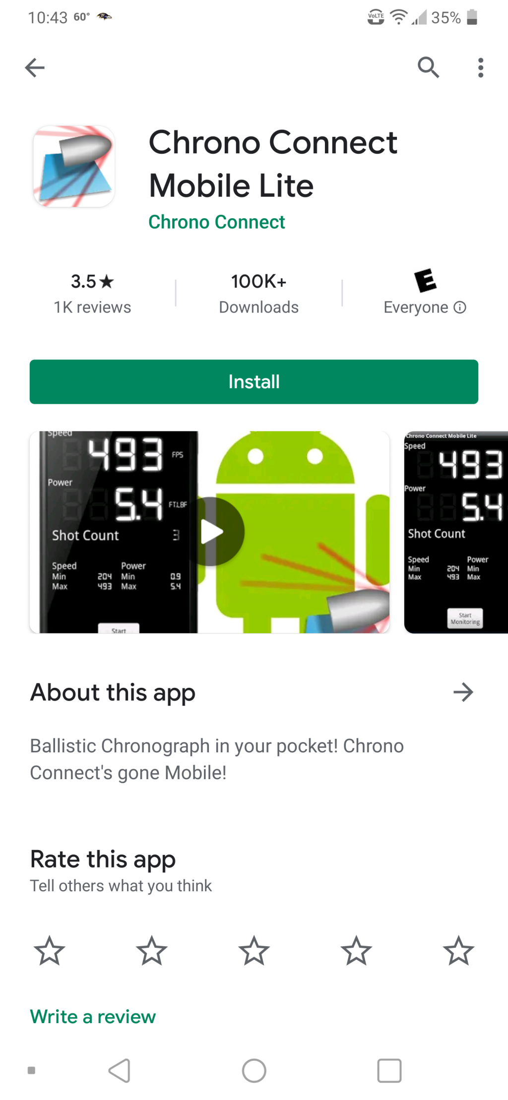

Thank you. This is helpful. I would love to have my own chronograph some day. Now I know there are many factors involved here but how do you think the shot strings in this picture would compare to the current talon p (ring loc) that can’t use the qc top hat? Maybe this can’t be answered until someone who has one chronographs it, but I would love to know. Mainly curious about the fpe without the inserts (or in my case, the smaller valves in the airforce ring lock set)
I thought this was a joke at first! it must measure the delay between the “pop” and the “slap” of the pellets. That is awesome... I have these sets of photogate triggers as part of some lab equipment in my classroom (I’m a science teacher). We used these to clock blow guns the kids made - blowing darts or other projectiles through the photo gates. Let me tell you a stomp rocket, a 1 meter copper pipe and a marble (or for safety a grape or potato plug) makes a great demonstration for discussing kinetic energy and projectiles. Had some fun with that before the virus.
i wonder if they’d clock a pellet if I could shoot well enough?
I can space them up to 3 meters apart and calculate velocities based on when the beams are interrupted. I think the sweet spot of the sensors is too small for me to reliably shoot a pellet through so I may just have to invest some cash in a chronometer, but I’m having a hard time justifying the purchase after just getting the talon p.
I’ll tell you it might have been 5 years before I got back into this hobby if it hadn’t been for the outbreak. been a long time since I messed around with airguns. Gave me time to think, do a little research, get really bored and come up with a solution. Guess it’s always nice to find good mixed in with the bad.
