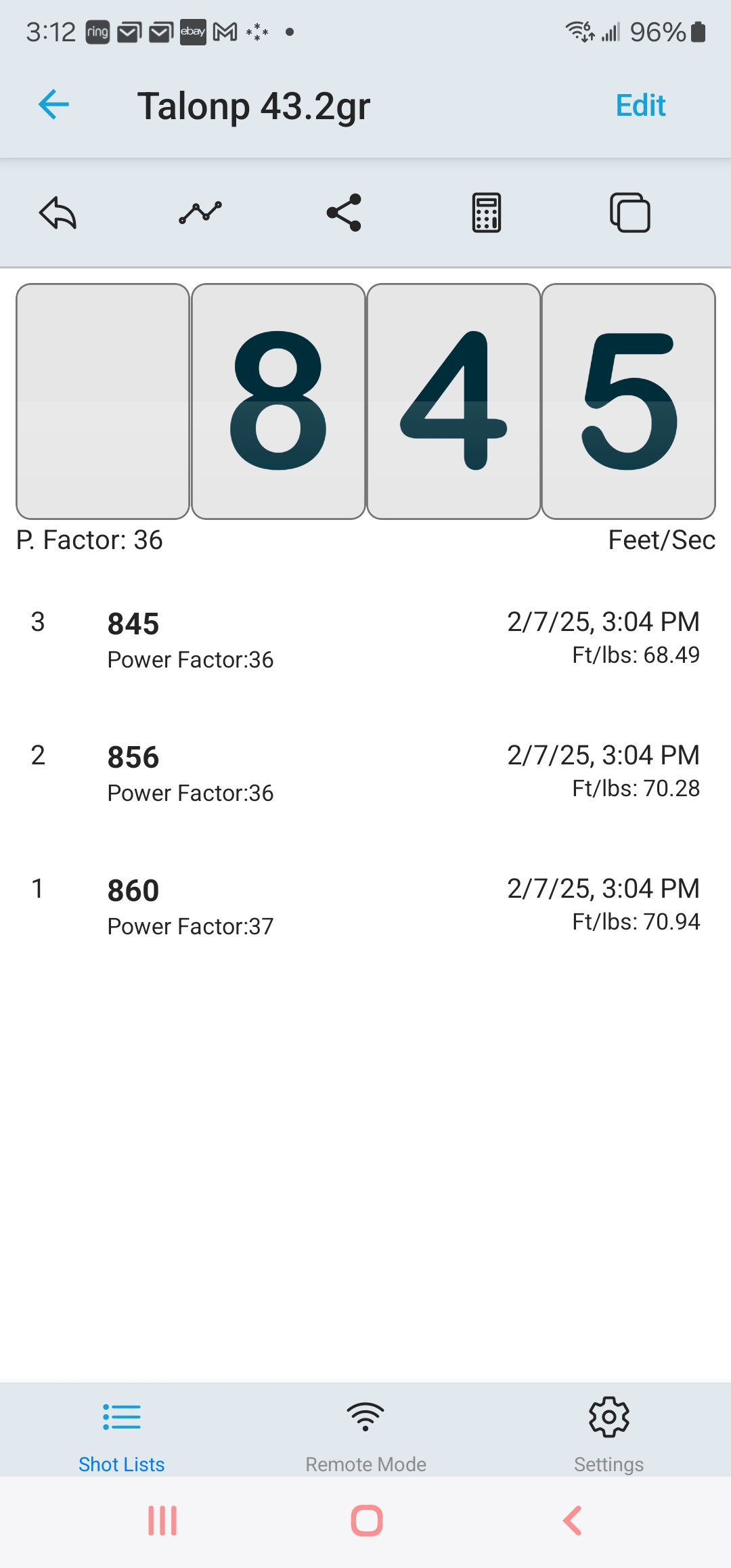

Well here are my results with the talonp I mean those numbers are ridiculous from that small barrel.
