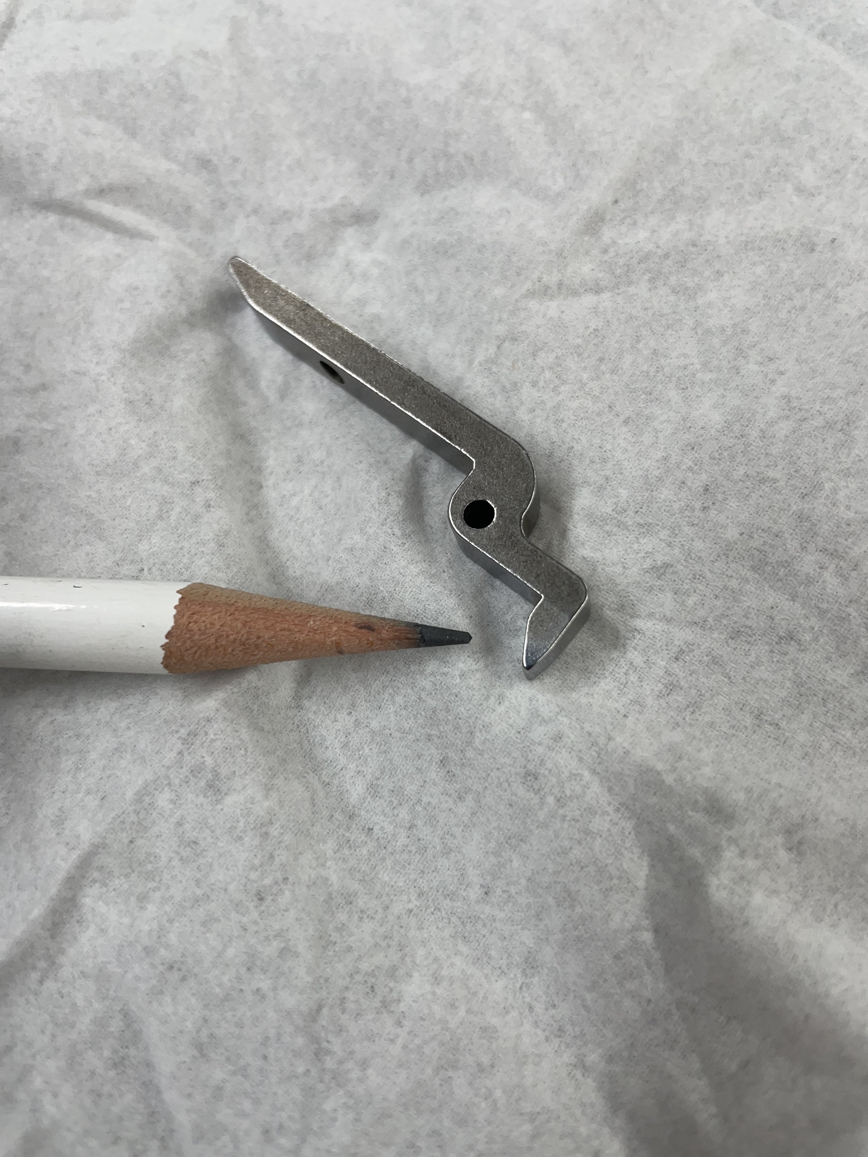

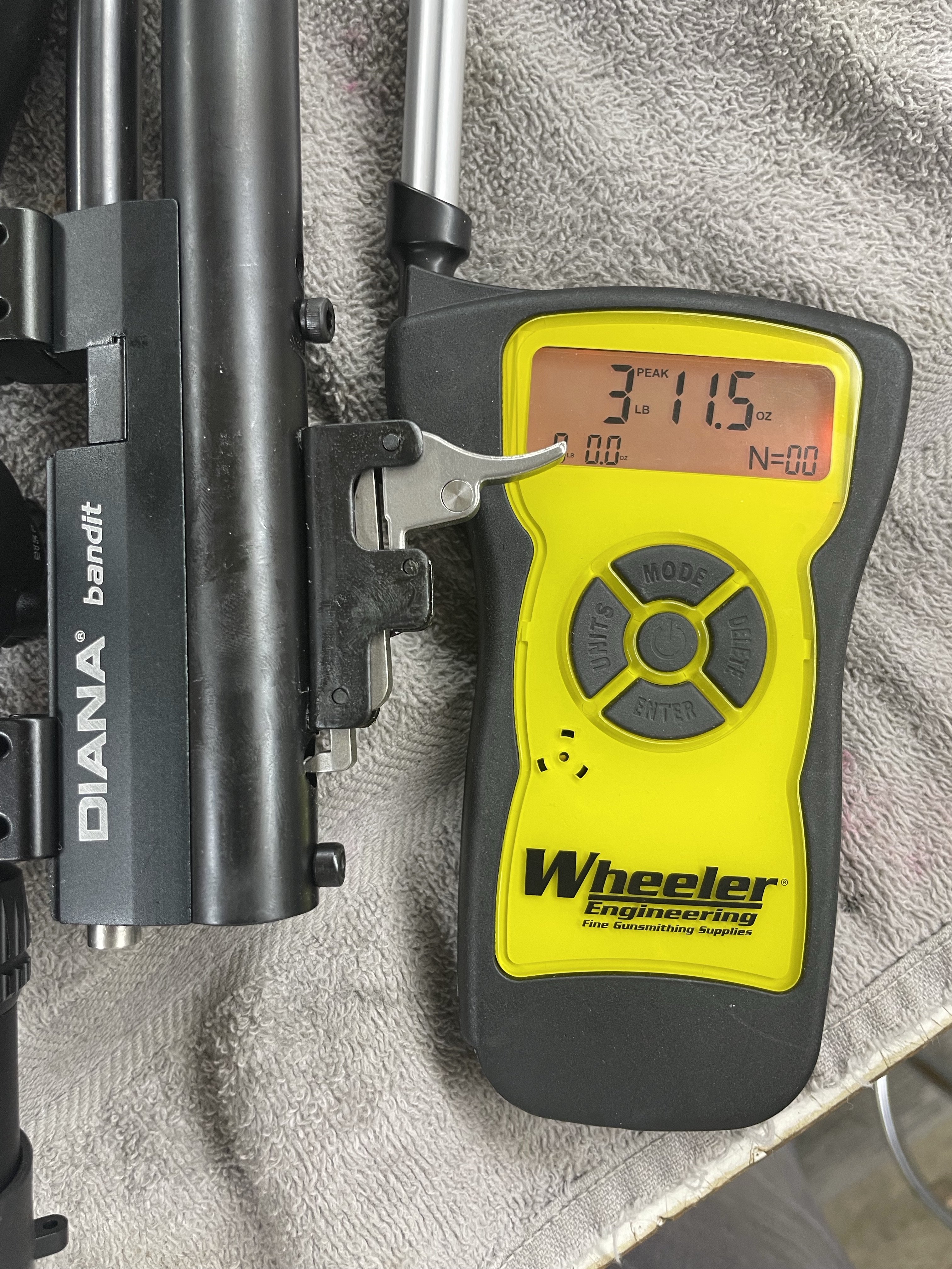

I purchased a used Diana Bandit a few days ago and put a few .22 pellets down the pipe to see what the pistol’s accuracy potential was. Surprisingly it was pretty darn accurate, especially for its price point. The main thing that was holding it back for better accuracy was the trigger because it was stiffer than a fence post and certainly not conducive for pin point accuracy punching holes in paper. 3 Pounds 11.5 ounces is fine for a defense CCW pistol but not what I had in mind for a target pistol.

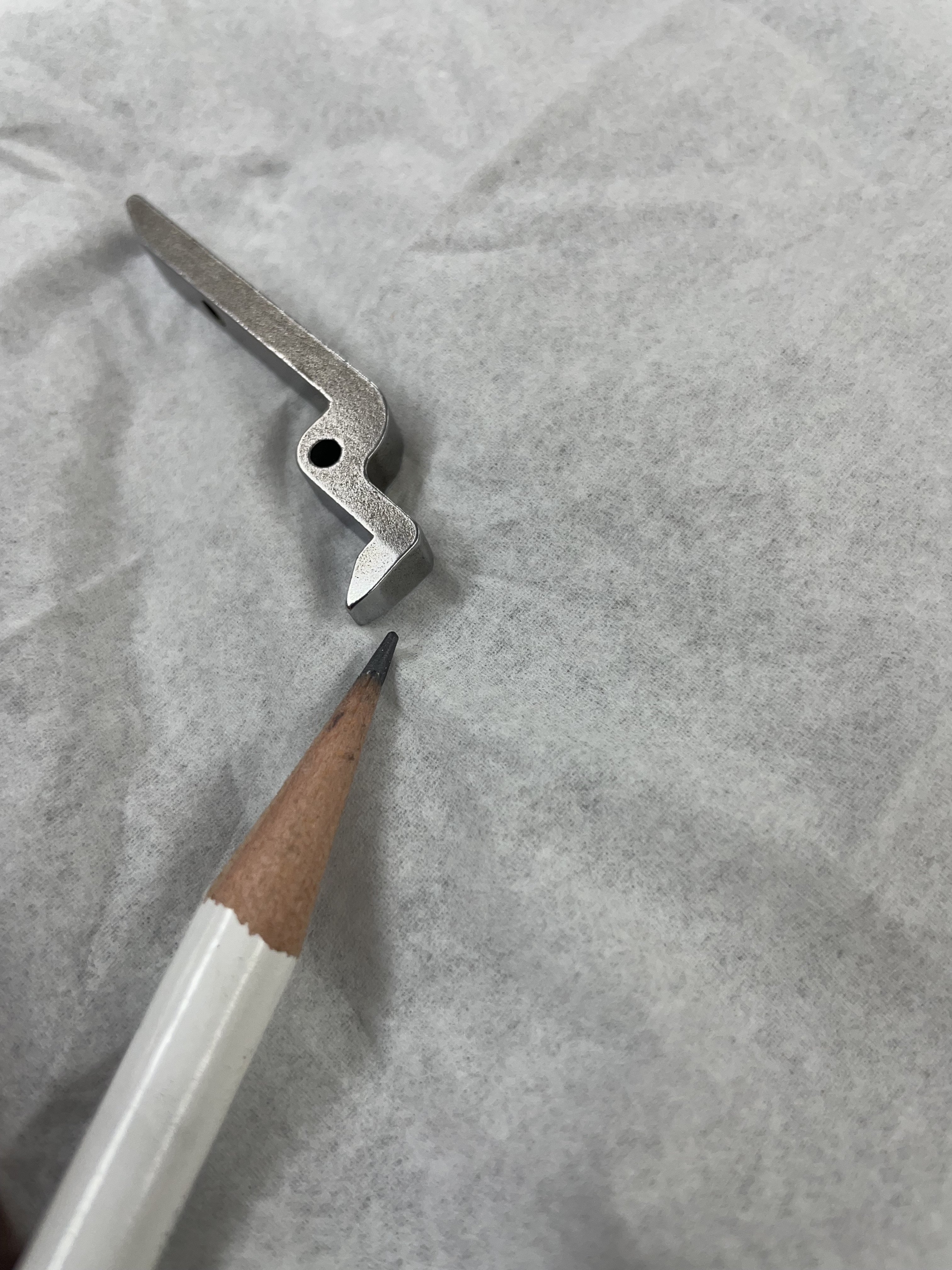

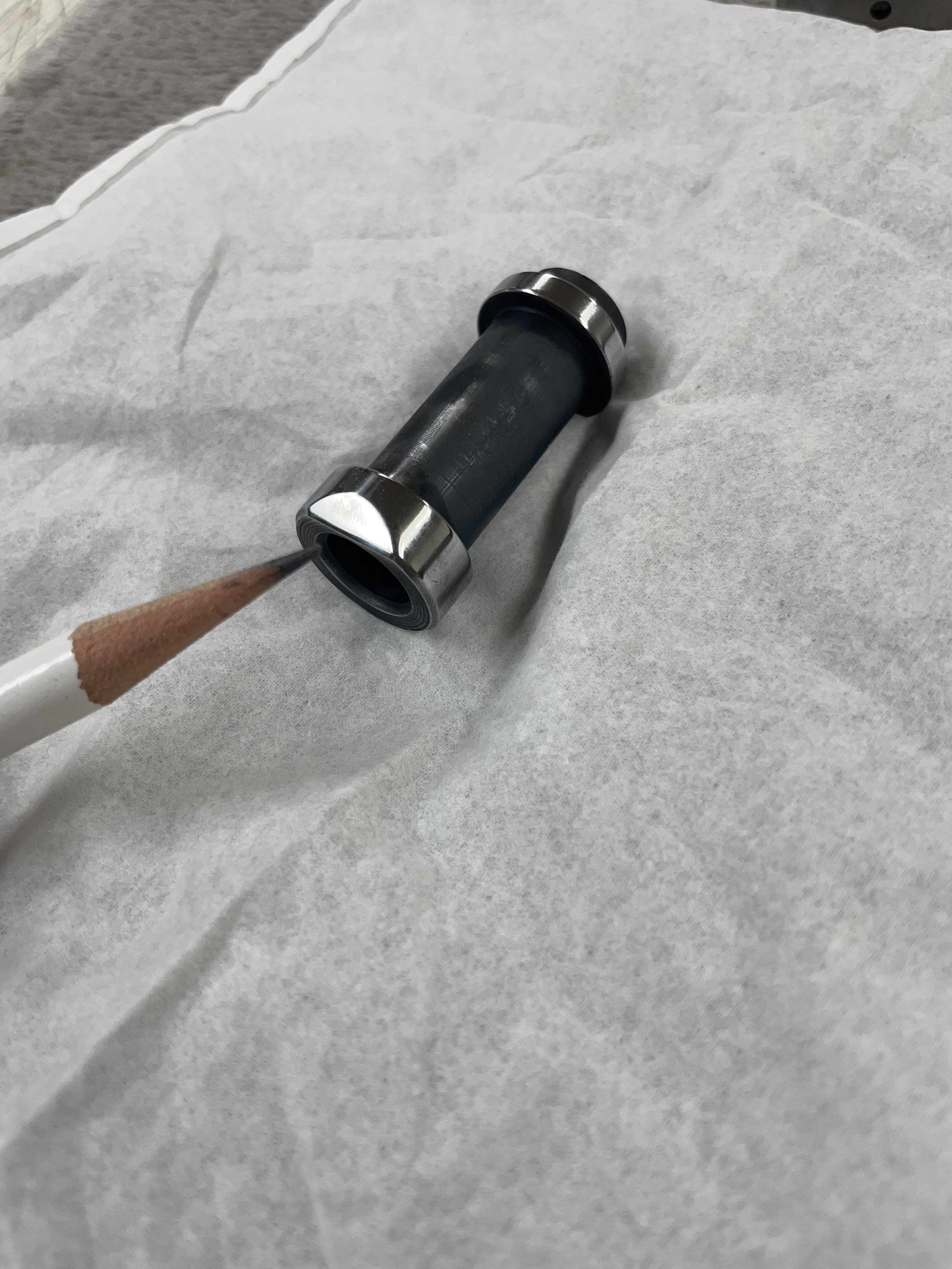

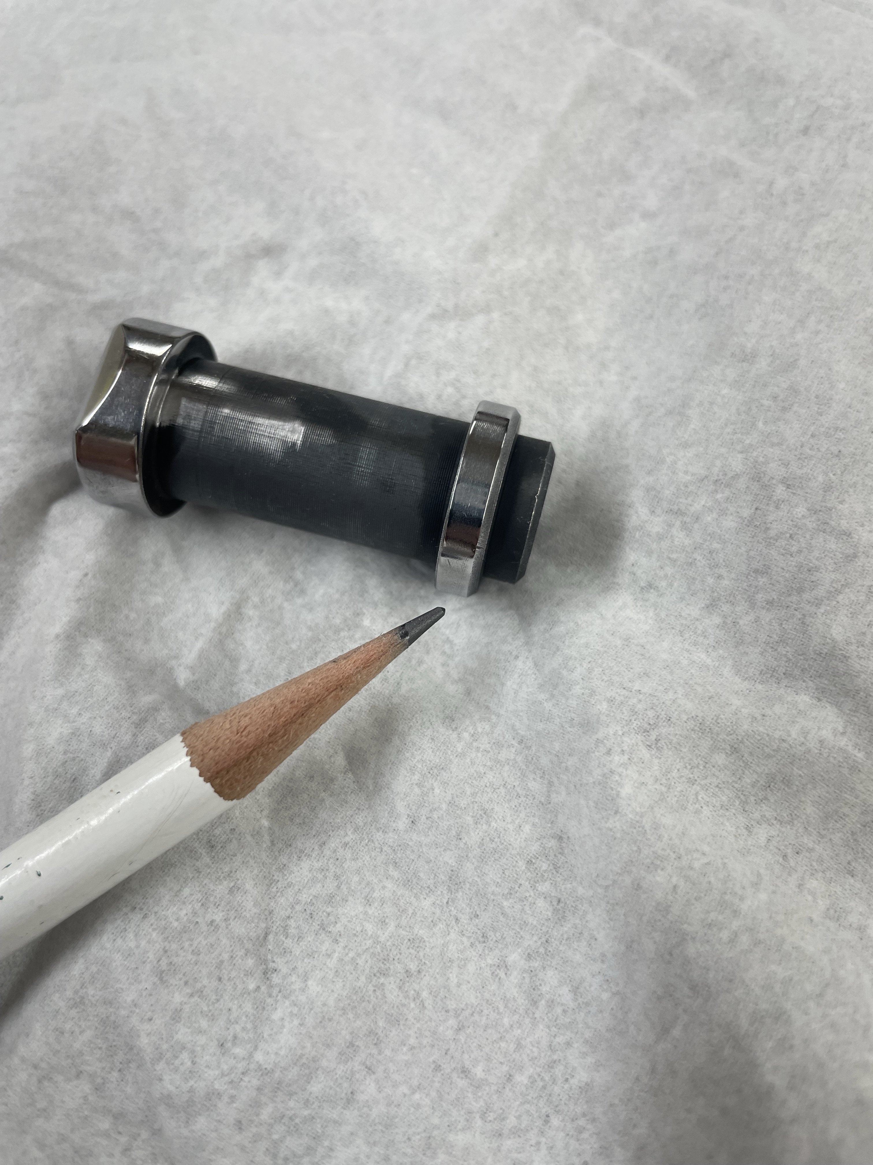

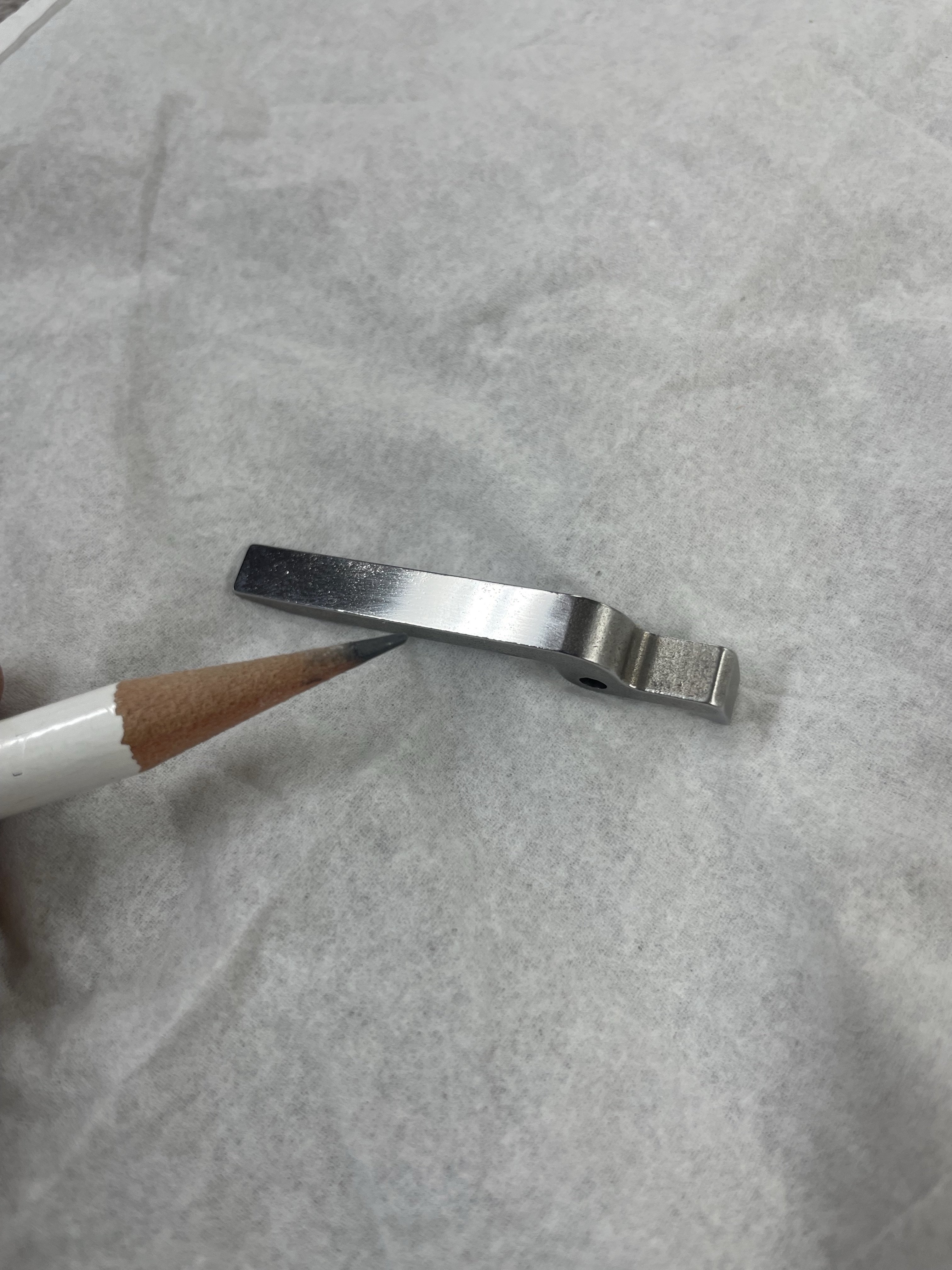

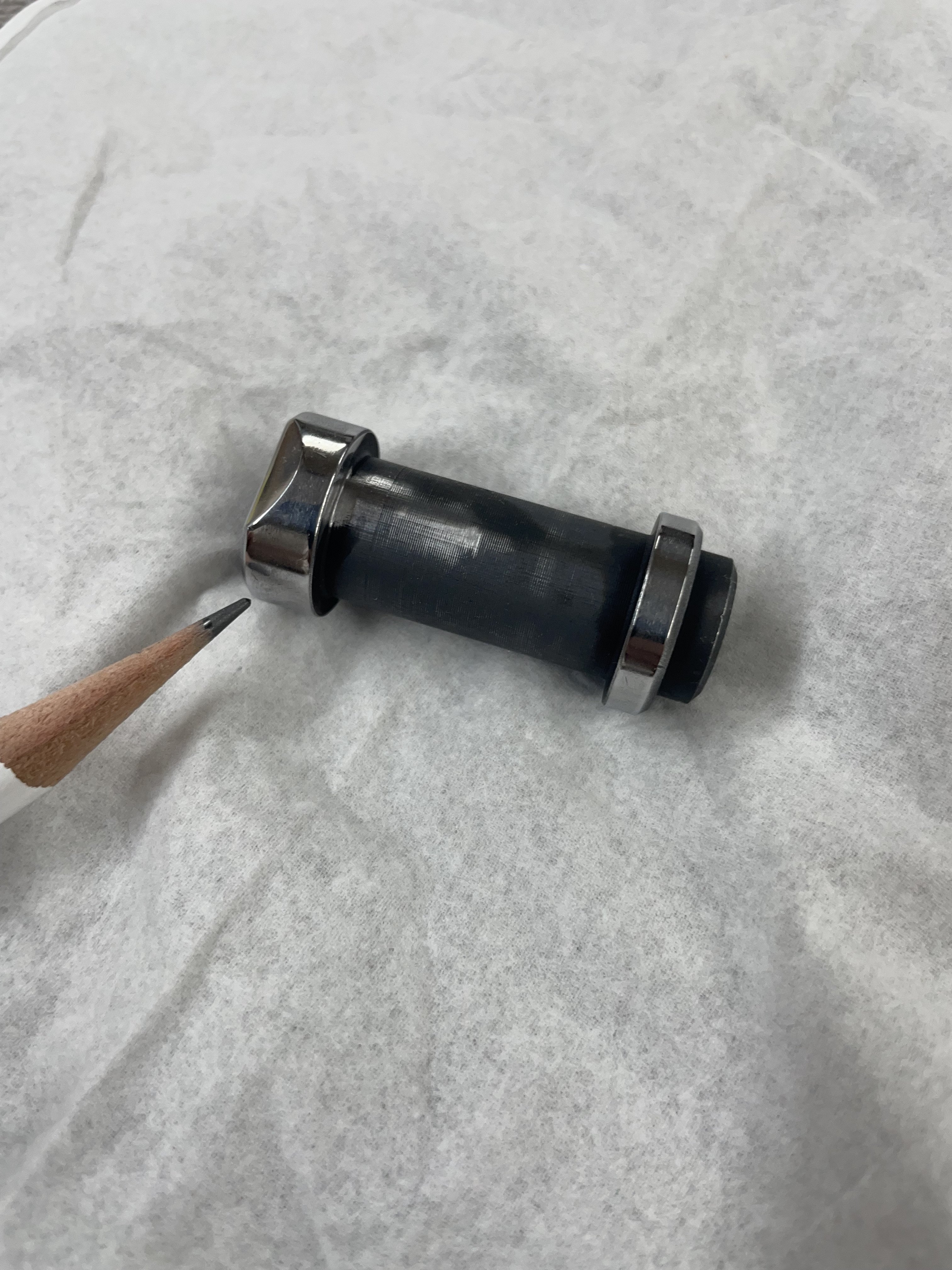

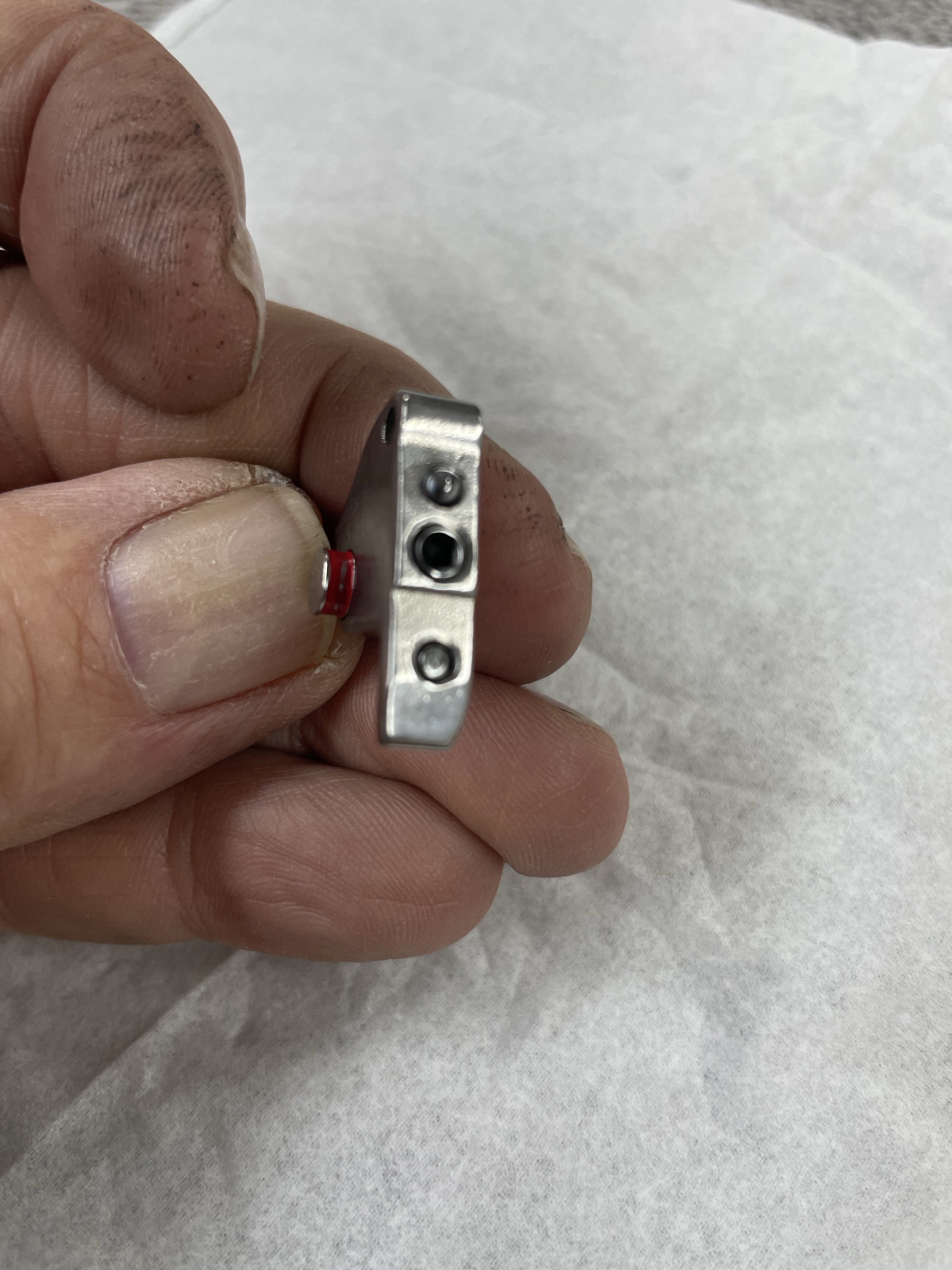

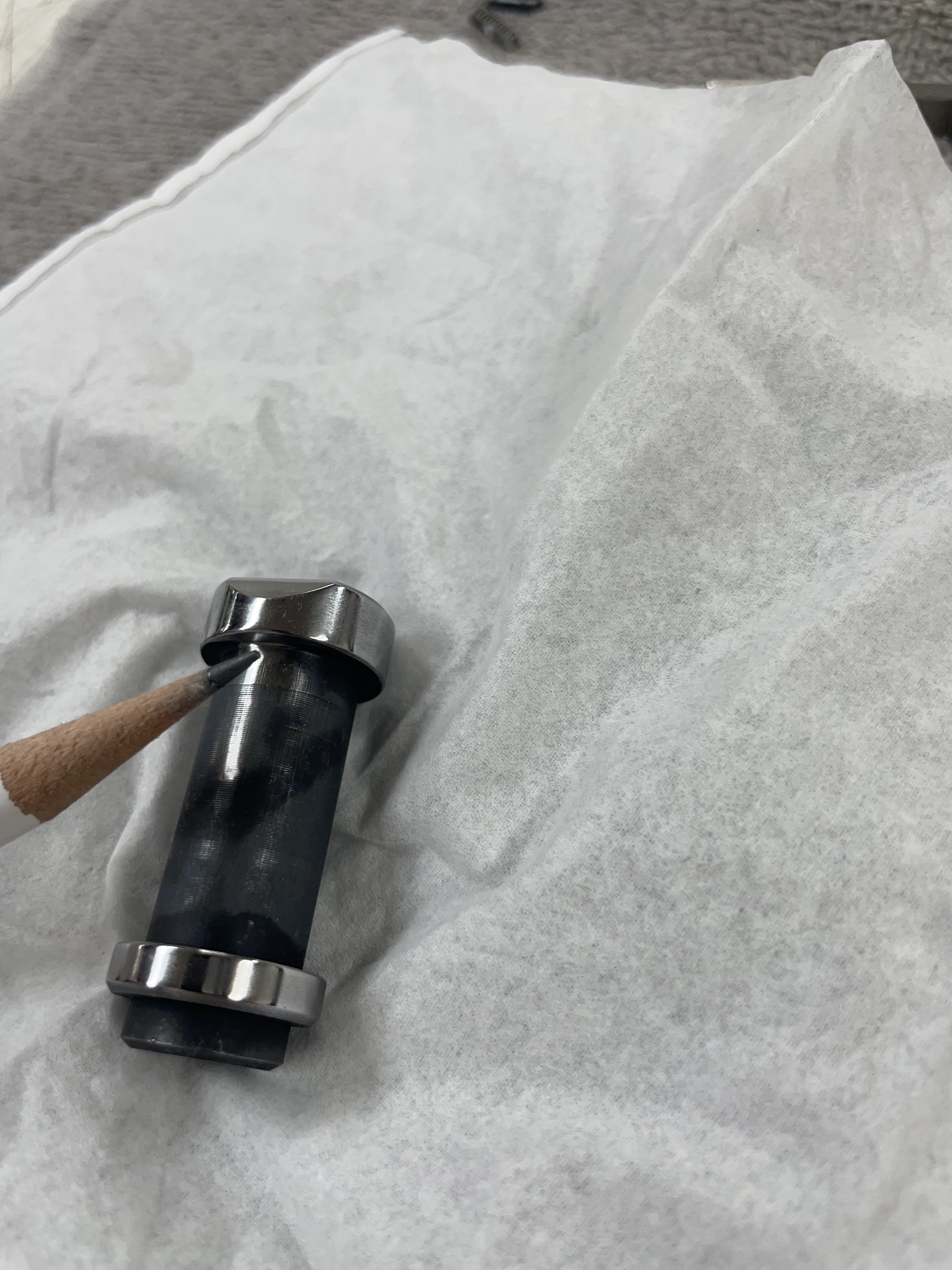

So I set out to try my hand at making this trigger more user friendly. After I removed the trigger, sear, hammer and springs I knew what components that I had to address. I spent a considerable amount of time stoning the sear, hammer and trigger interfacing surfaces. Then I buffed these faces to a mirror finish. The photos below show the components after final polishing. The pencil points to each of the faces that were stoned and polished.

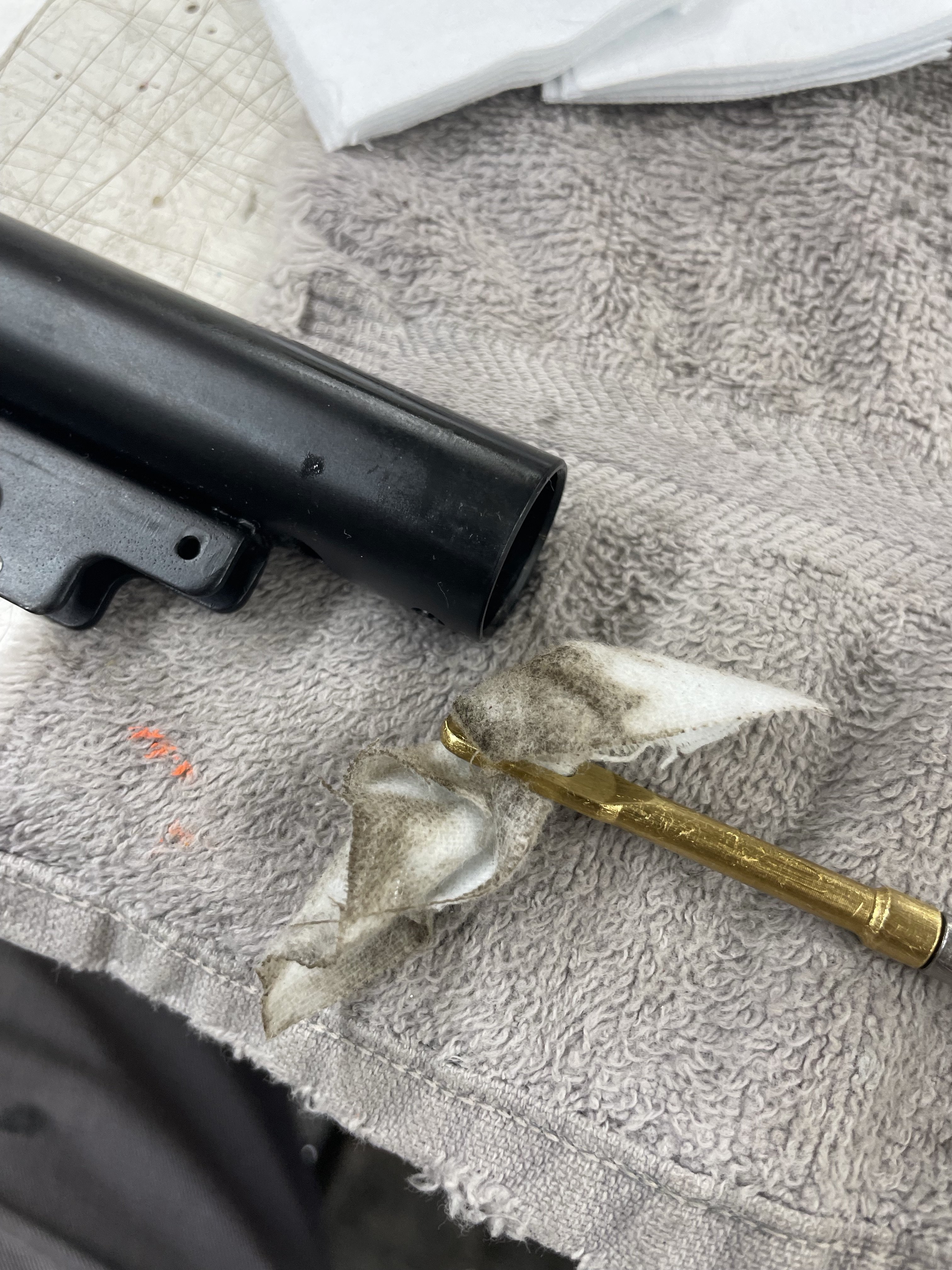

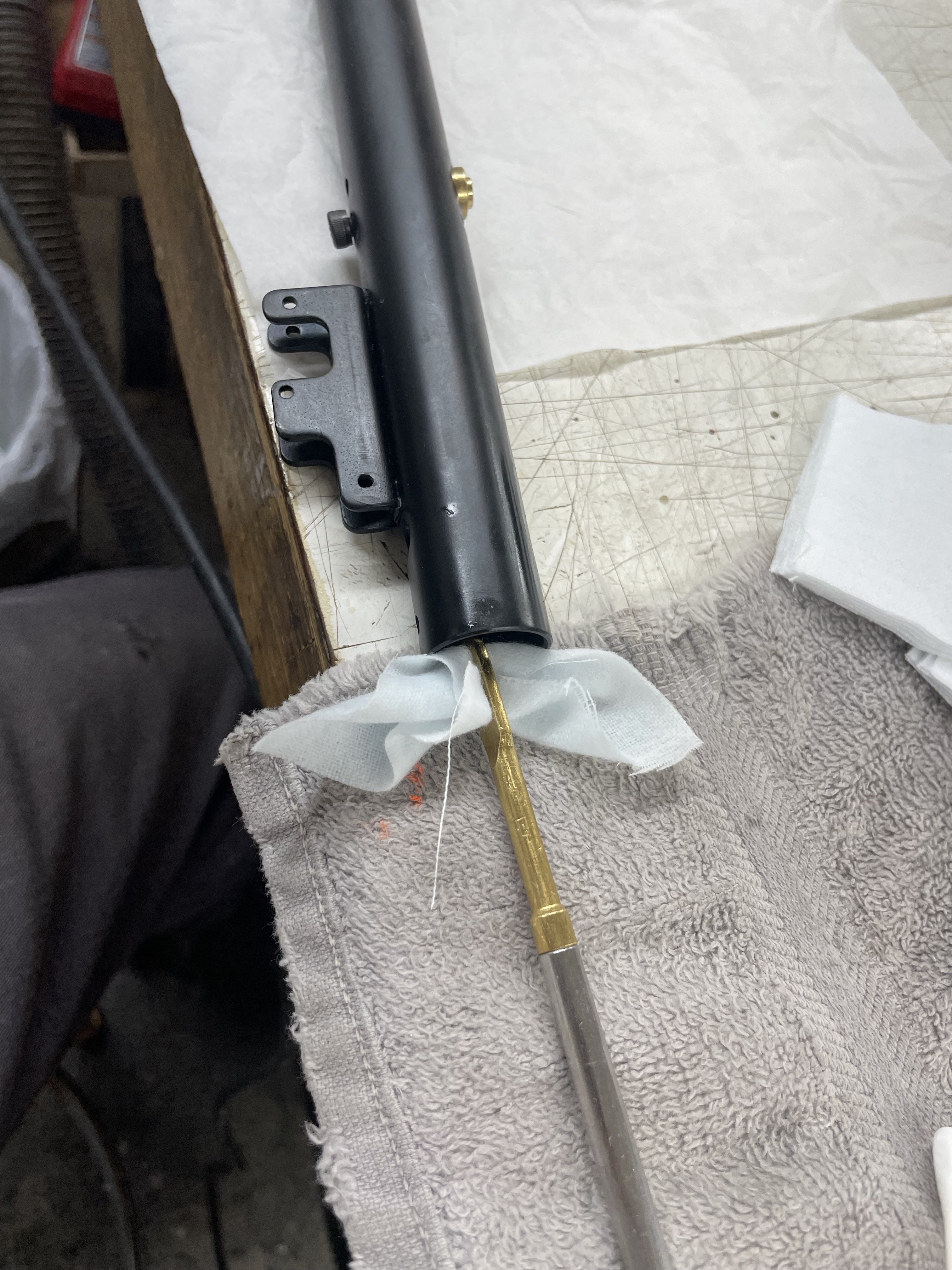

Next all of the parts were cleaned thoroughly with Prolix which leaves a dry film lubricant behind. I also polished the hammer spring too. Then I cleaned the inside of the gun that the hammer slides into. and it was was filthy and rusty.
Even the inside of the hammer, where the spring rides, was rusty too.

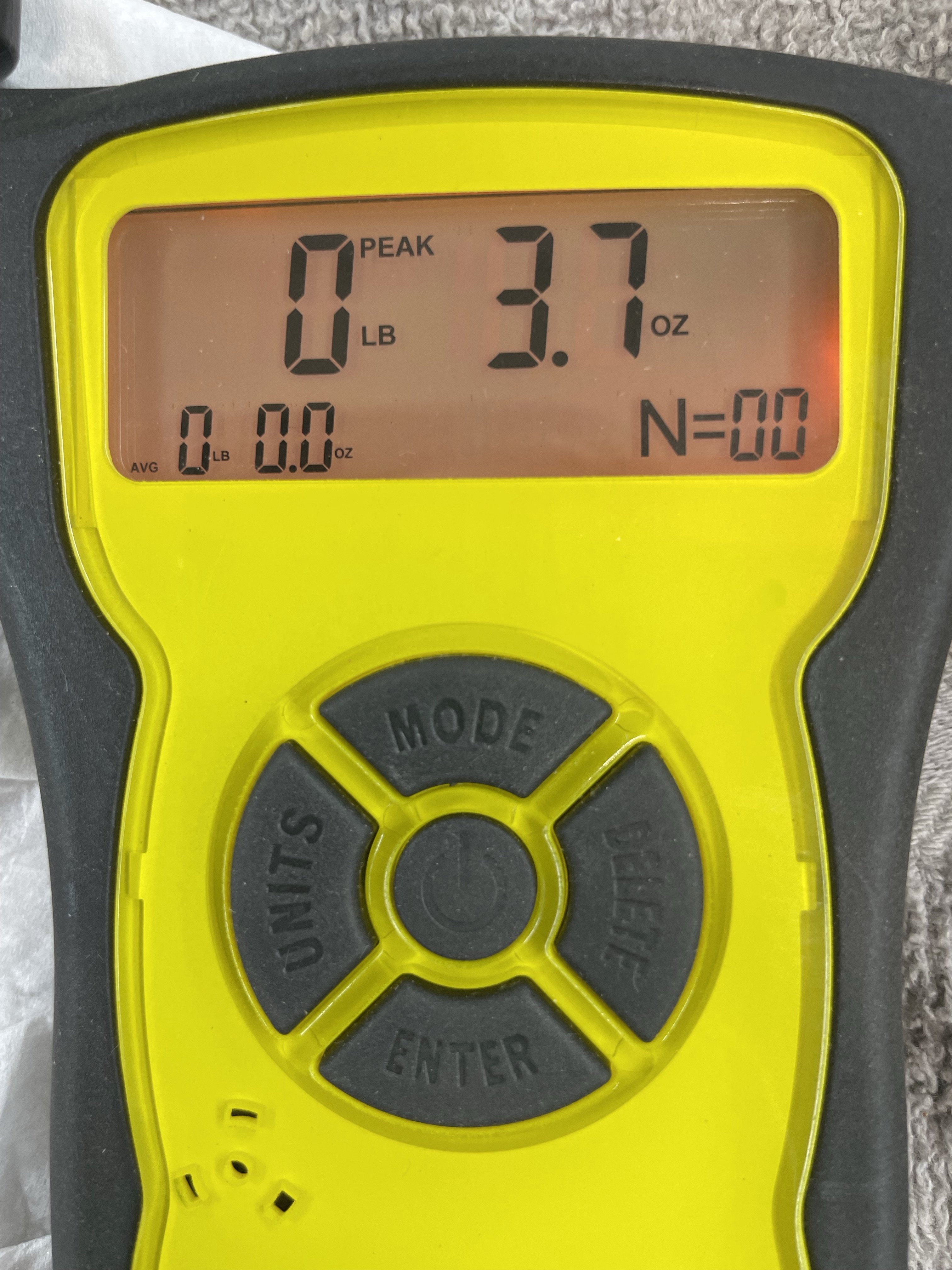

Finally I reassembled all of the parts after putting a light coat of grease on all of the trigger group mating surfaces. After it was all back together the trigger pull measured a much improved 3.7 ounces.
View attachment 505975View attachment 505973View attachment 505974View attachment 505976View attachment 505972View attachment 505977View attachment 505979View attachment 505978

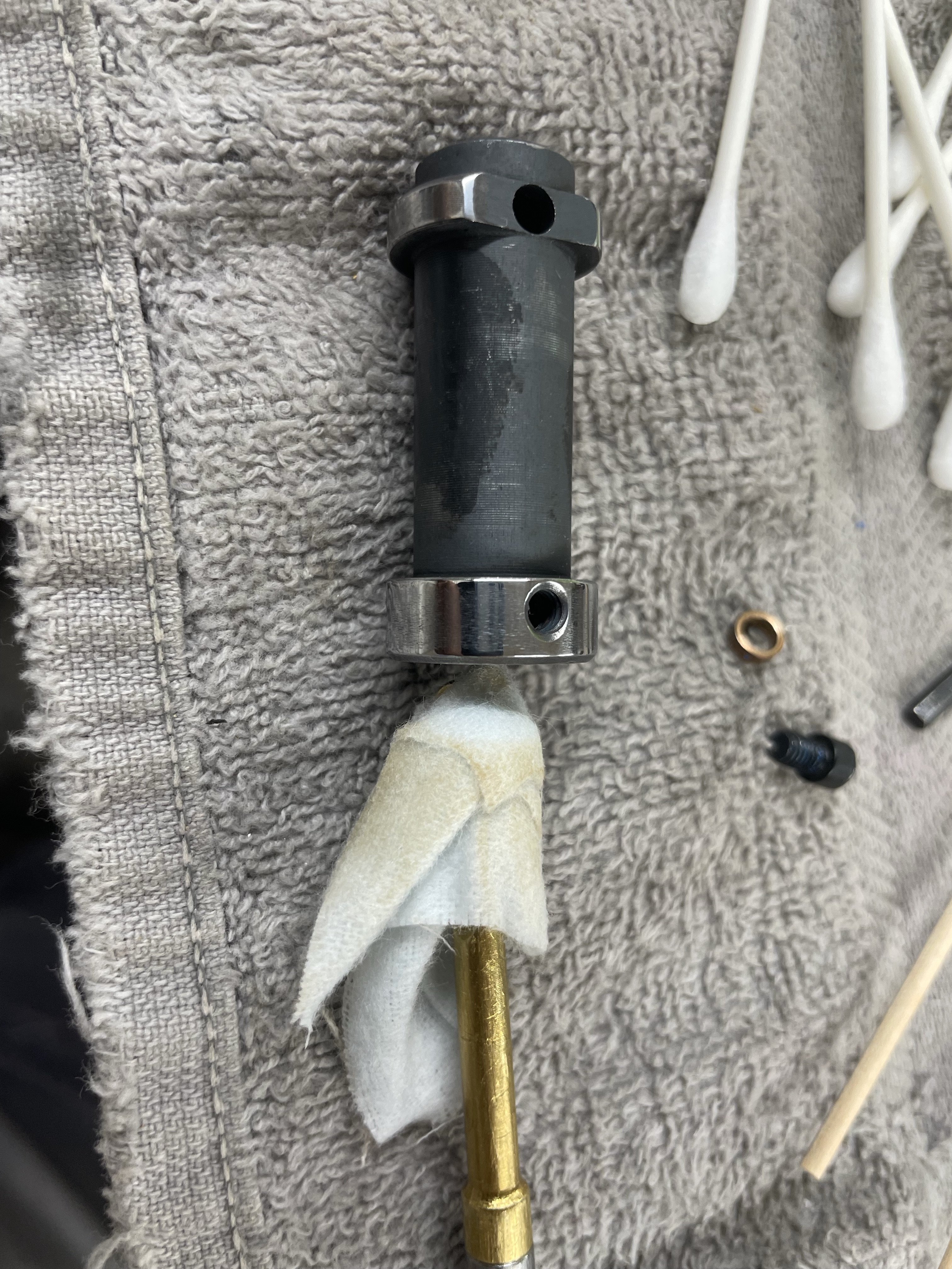

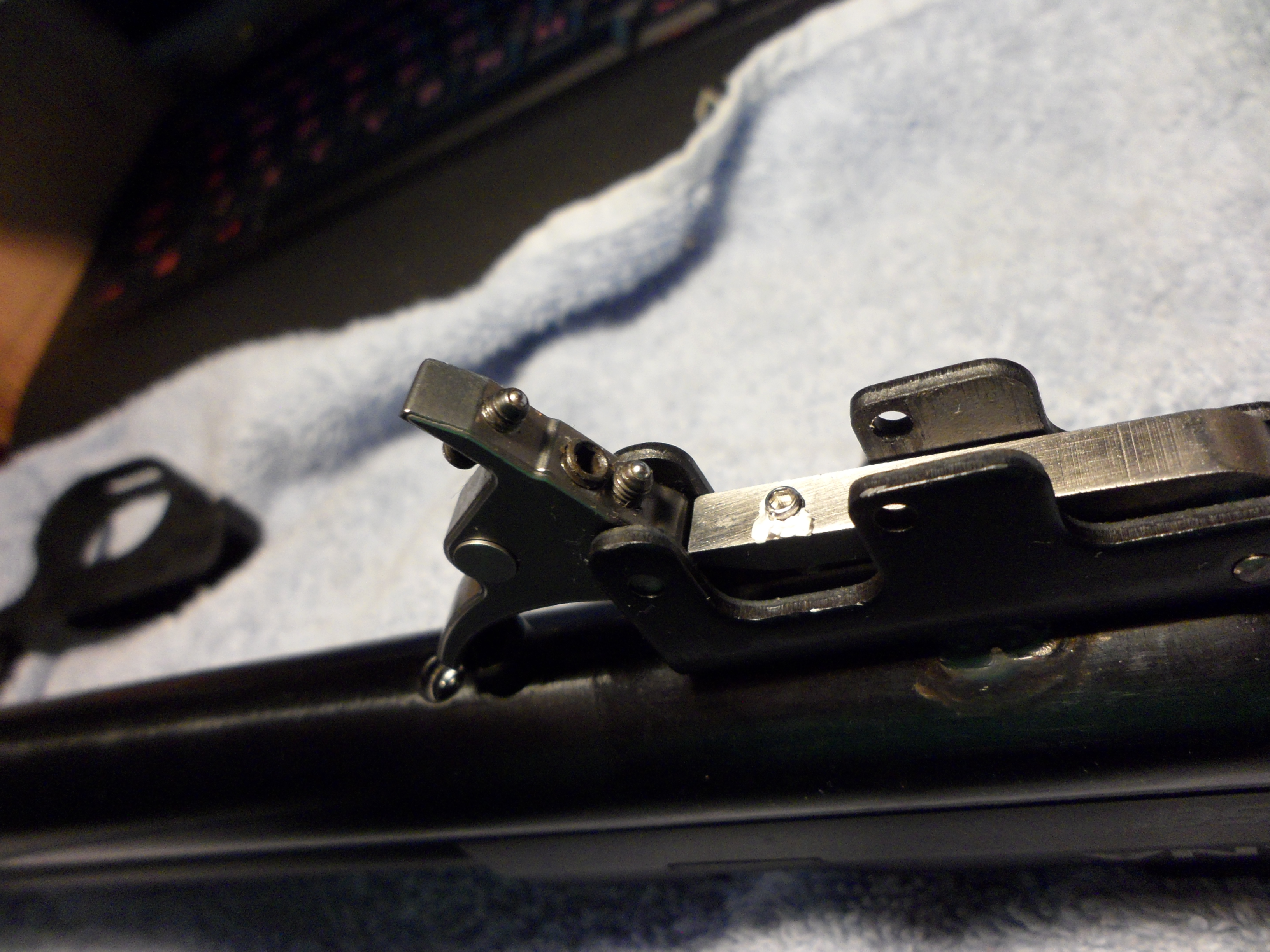

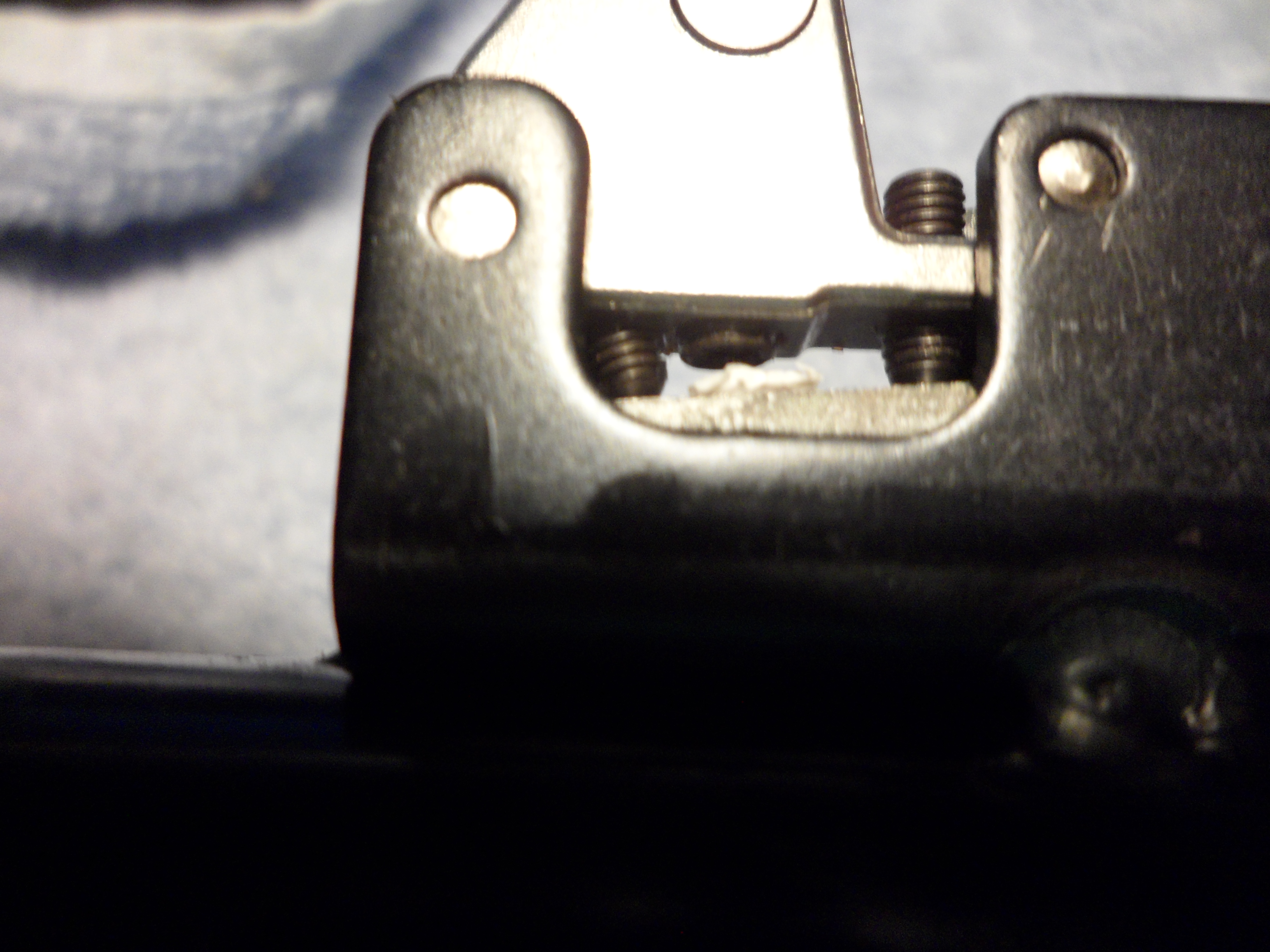

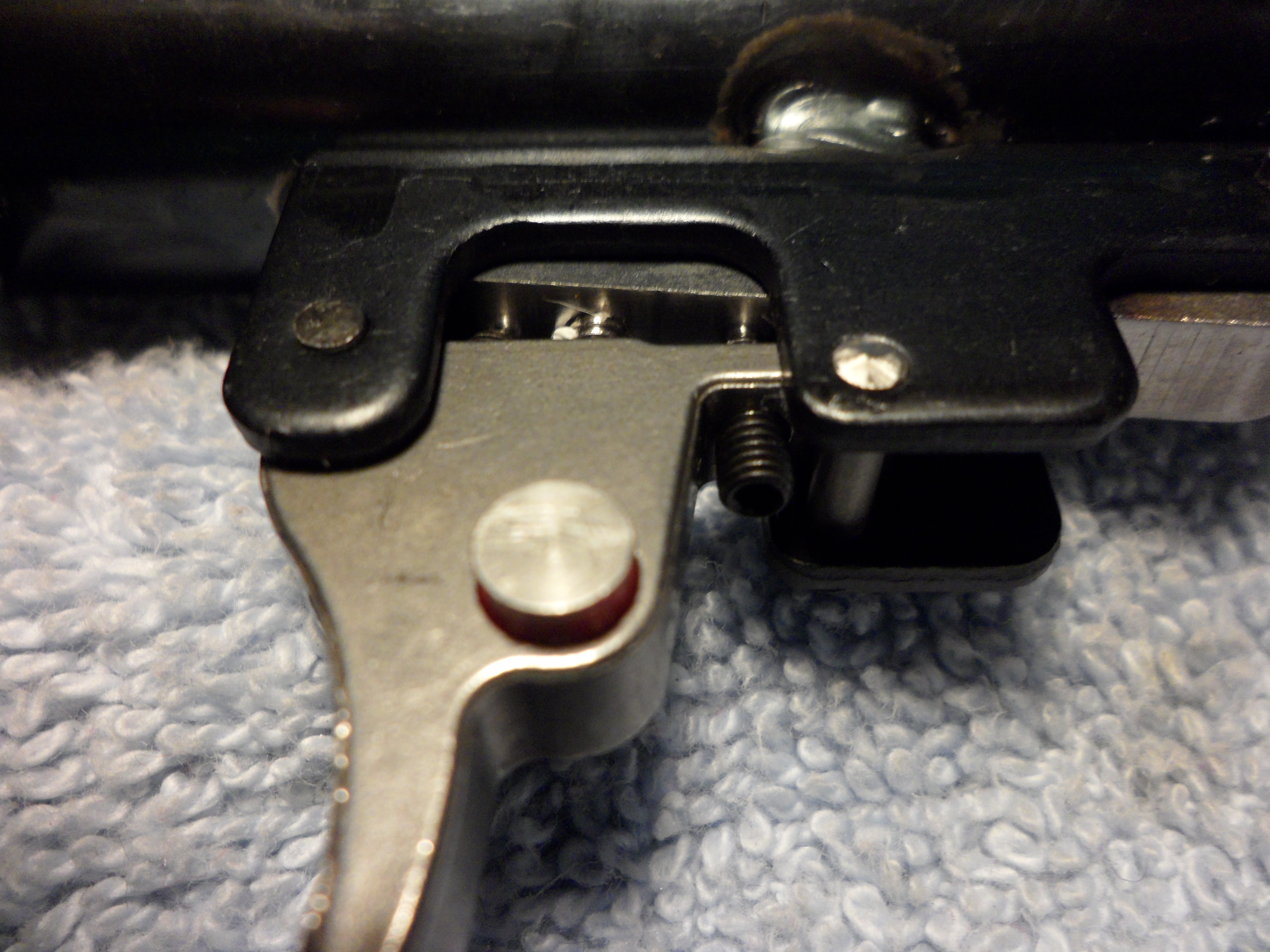

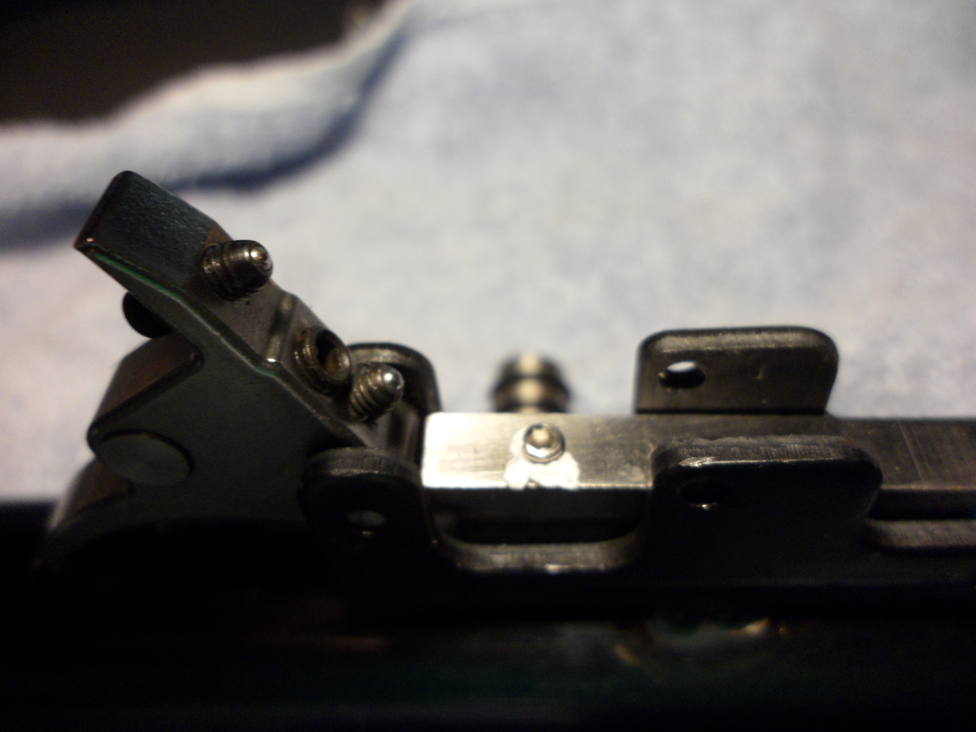

View attachment 506021View attachment 506022View attachment 506023View attachment 506024

@marflow 777 , Thank you for sharing your method to fine tune the trigger. I used all of the stock components and did not shim anything. Just stoned and buffed all of the mating surfaces, I did replace the sear spring with a much lighter spring (from a ball point pen) and that in of itself is probably what made the most improvement. I did remove (adjust) most of the sear overlap out so there is no creep now in the trigger before breaking. The original sear adjustment setscrew had a very sharp point on it and I increased that profile to more of a ball profile like the ball nose set screws like you used. I will shoot mine as is for a while and may employ some of your refinements down the road if I feel the need for further improvement?
