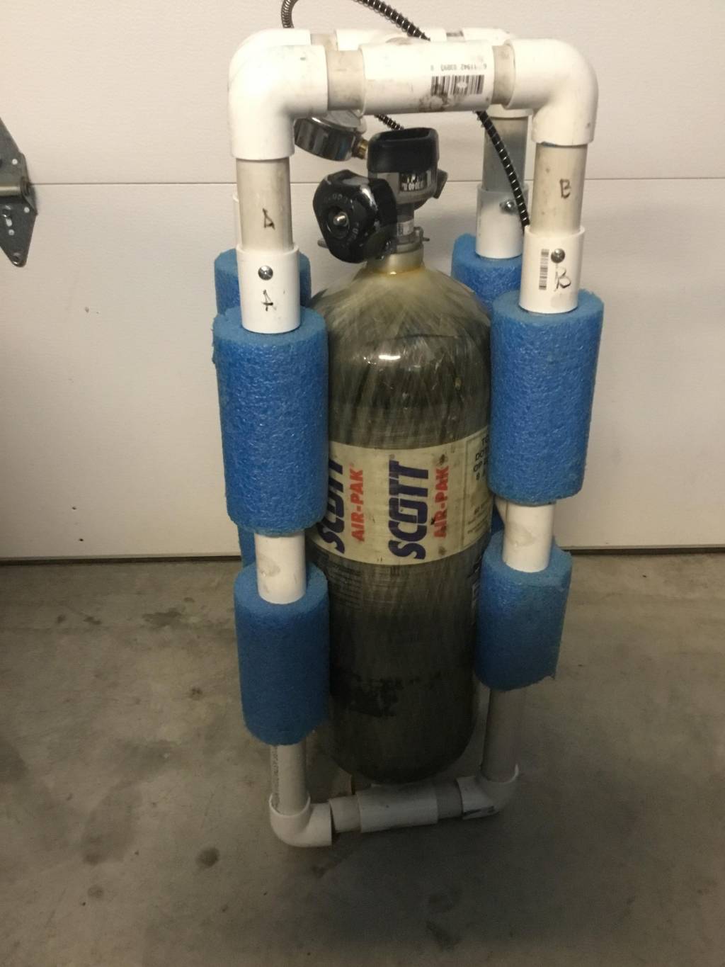

I built a “cage” around mine about 12 years ago. PVC and pool noodles.
Fell over once. No damage kinda a dull thud.
Stays in the cage. No need to remove it. I can carry it, transport it without fear of it sliding or rolling around, fill from it, even sit stuff on it when horizontal.
