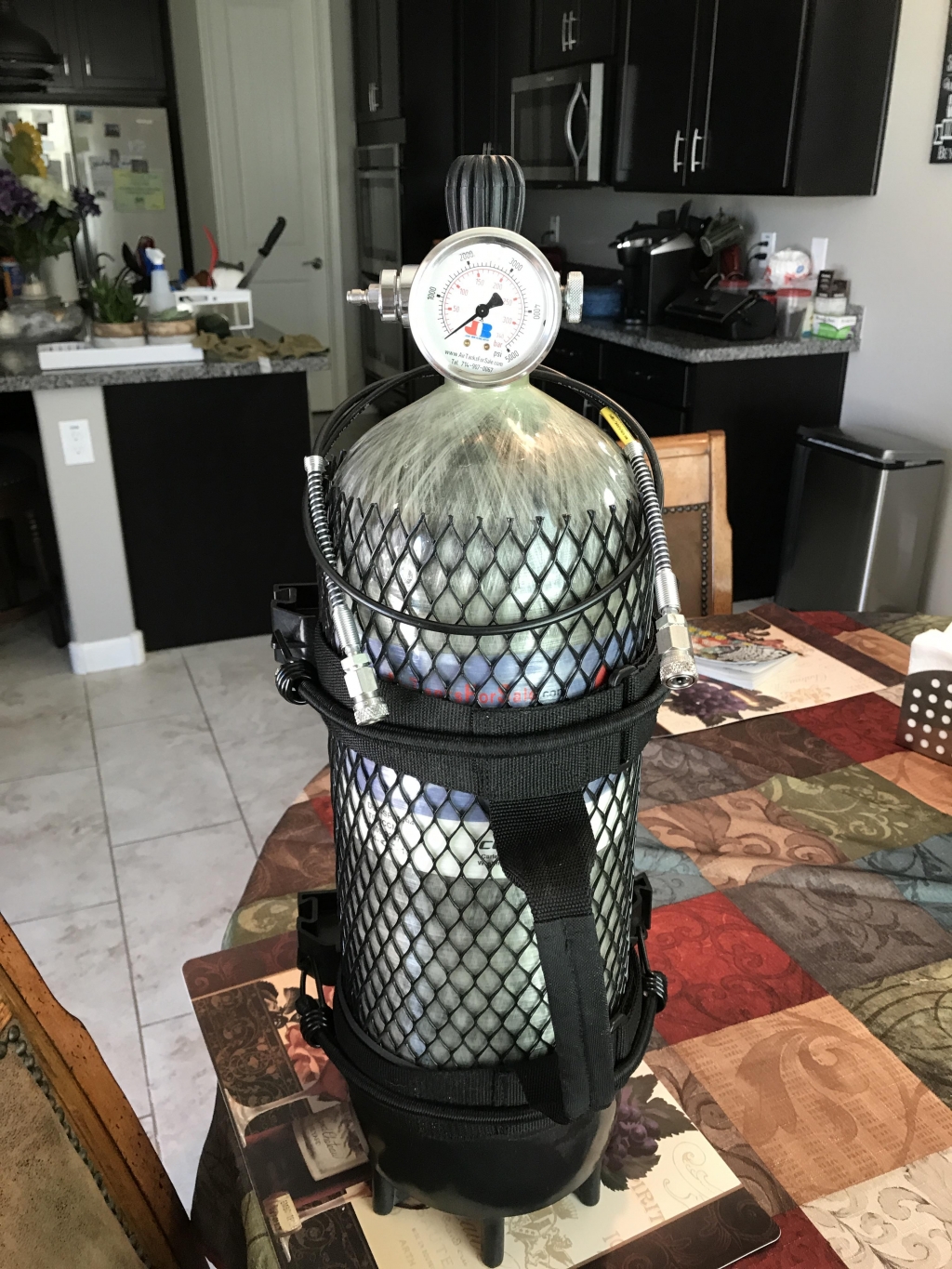

I second Joe Brancatto. His store is based off of selling air tanks. I recently purchased a fully loaded Tiger Shark 72cu/ft tank from him. He also sells the Great White which is his largest tank @ 90cuft. I have topped off my Regal 162cc reservoir and Compatto 150cc daily for a month and have not needed to refill it yet. Fully loaded it came with dual gauges, one for fill pressure the other for the bottles pressure, foster fill/refill with dual foster hose, slow unregulated fill, tank armor and dual stands.

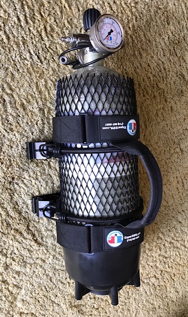

Utah Airguns carries the Joe B Great White 97 CuFt Air Tanks From all my research, his tanks have premium gauges and flow control valves.
I have been procrastinating on purchasing a bottle as I have a compressor to fill up my Impacts. I'm fixing to pull the trigger and Joe B's tanks are at the very top of the list. Plus they are Made In The USA.
