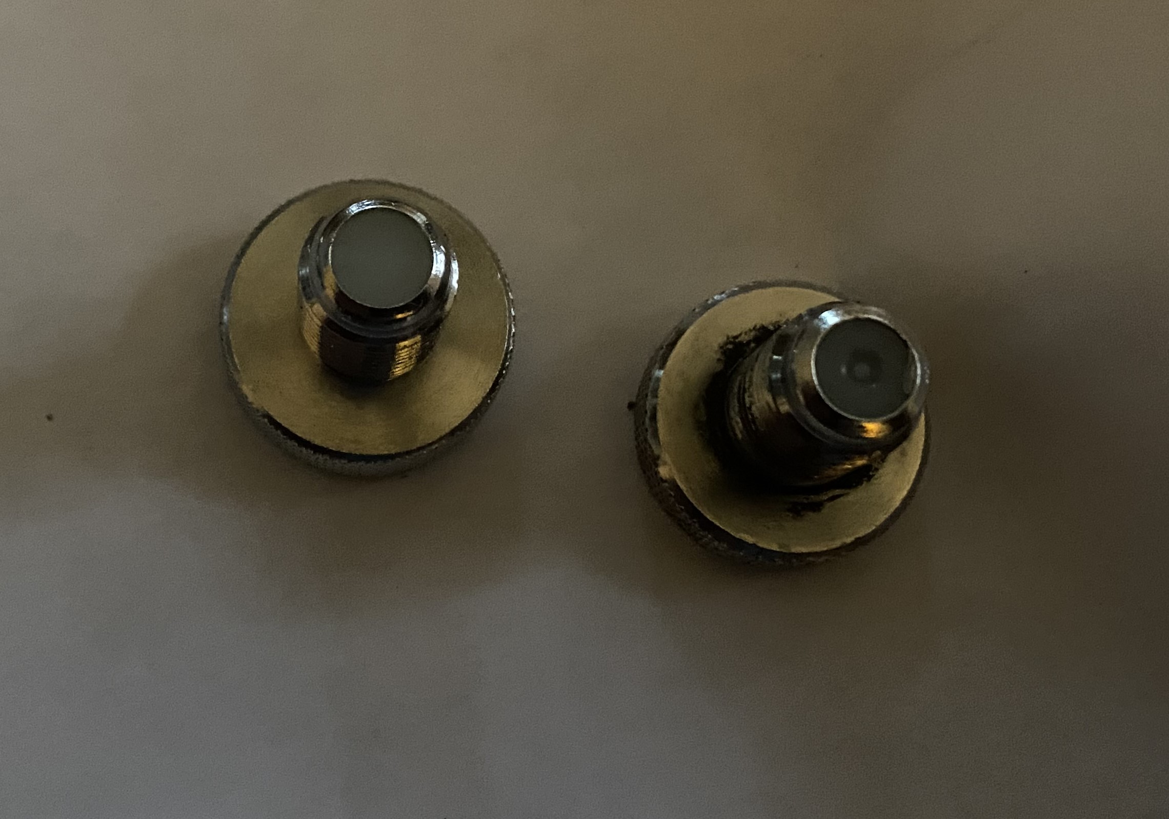

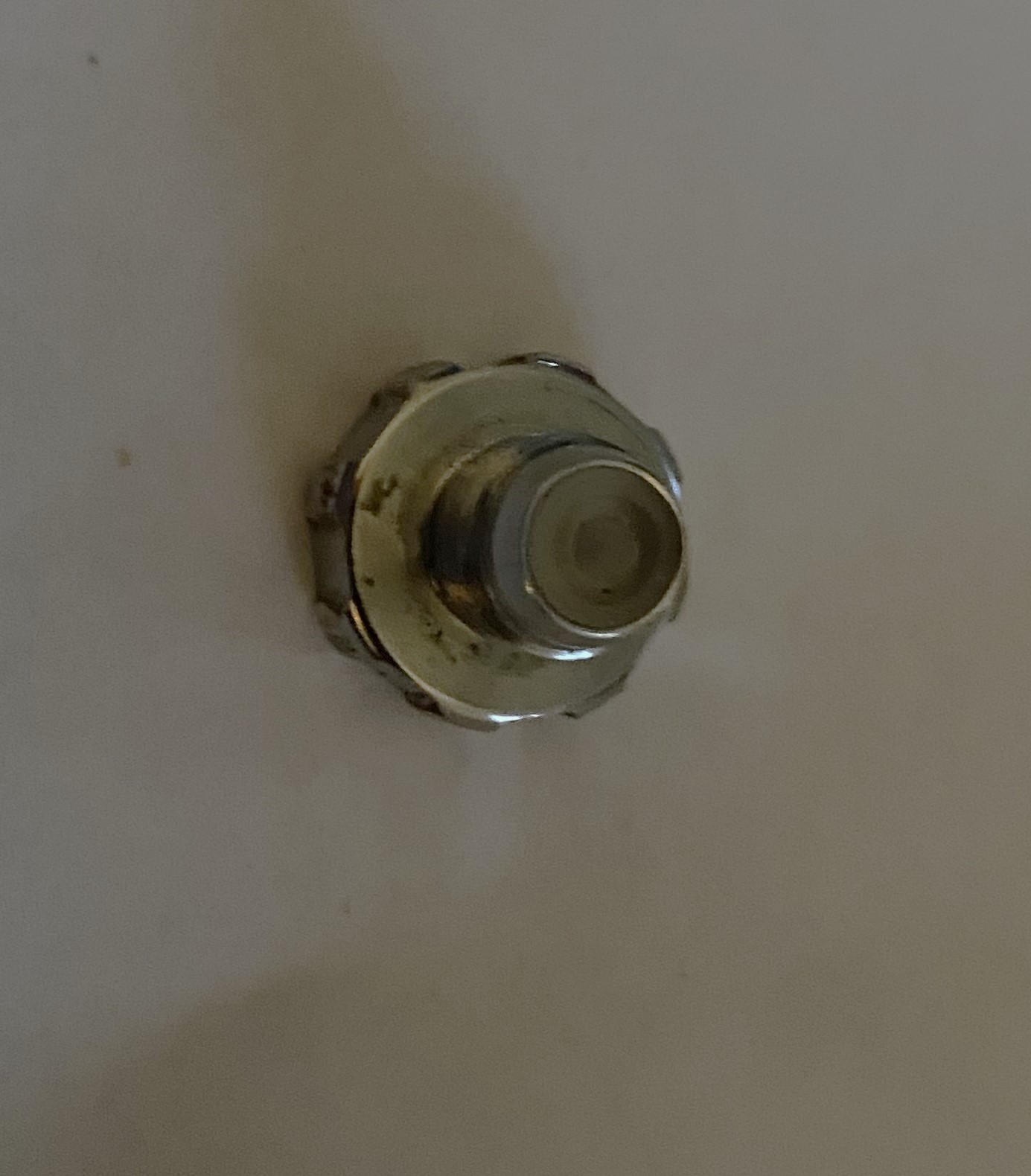

I have 2 tanks (90L & 60 minute) on which the fill set pressure release valves are no longer sealing properly.
My question are:
- Which seals do I use?
-Where can I find them
Attached are photos of the 2 release valves and the 2 tanks/fillsets

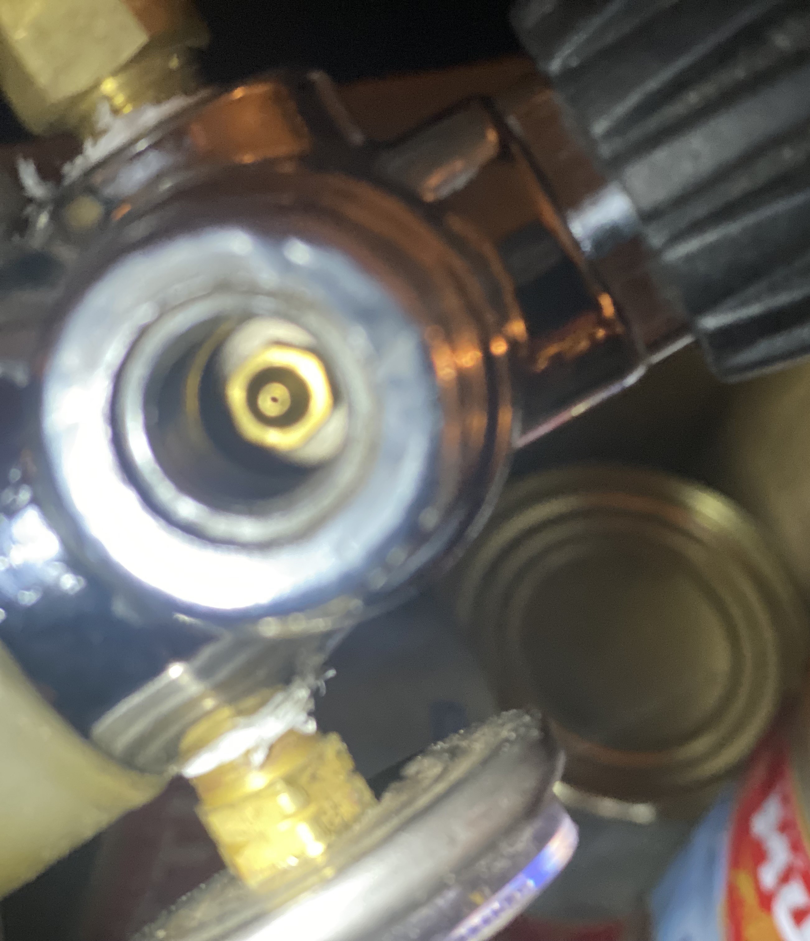

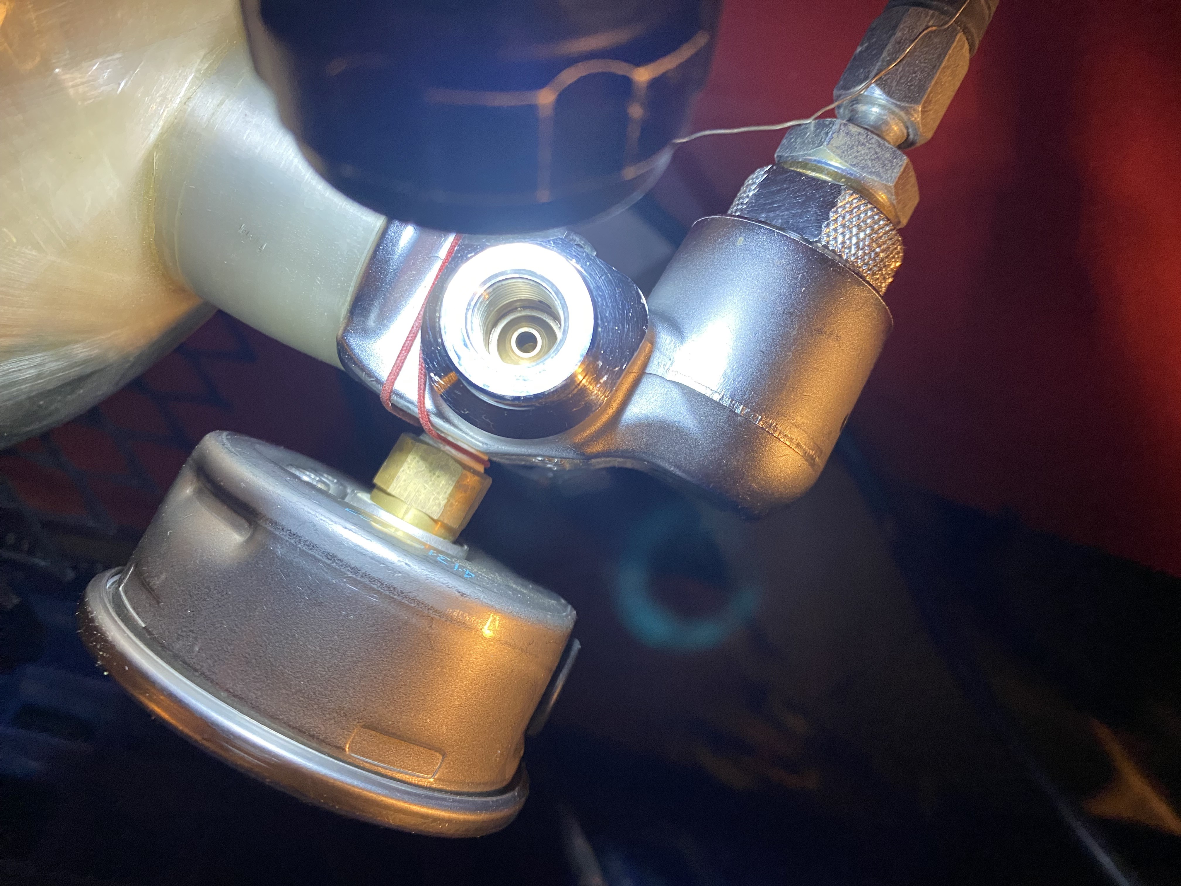

Those are your bleed off screws, I guess. Not sure exactly the problem you're describing. Do you mean the bleed screws are not holding as pressure in your tank rises? Is there a white nylon (Delrin) "donut" that the screw closes against? Can you show a picture of the INSIDE of where those screw into?

If you have calipers measure the i.d. of the screw hole or the outer diameter of the screw itself. You can get those Delrin seals off anywhere that carries pcp compressor parts (Aliexpress, Ebay, Amazon, etc.) I have a bunch of spares. IF you respond to your own post I'll send some. If you have your own compressor you probably got spare parts that came with it & might already have some. For the sake of clarity those "fill set pressure release valves" are bleed screws. Wasn't sure what you meant at first. Please answer & provide pictures if you can.

With @Humdinger 's recommendation I have started shopping flat (not conical) seals
These seem to me to be soft seals with no hole in them, unlike the hard nylon washer type seals used on compressors and gauges

There is a photo of the inside of each bore attached for reference

Your bleed screw ends are different from mine. How I got them "to work" was by just replacing the seals (delrin) in mine that were bad. Maybe it's time to replace your tank valves with STANDARD SCBA valves & get CGA347 fill adapters. That's the best I can come up with, sorry. Never seen bleed screws quite like yours. Mine have metal ends that seal against the delrin "donuts" that are in the bottom of the female receptacle. That make sense?

Yes, I understand the difference between your bleed screw ends & mine.
And yes again, they are quality valves
One is a Joe Brancato 2 gauge set up, and the other is an Apex.
Which is why I want to fix the bleed screw seals
