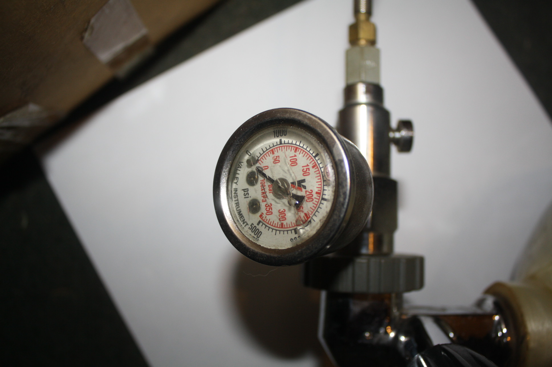

Ever see what happens to a non-filled gauge that is subject to high humidity after a few years of use? I have.
And who knows.....
(Photo below is a dry gauge)
Oil might actually help prevent this type of hazing/cracking/deterioration in a dry gauge:
