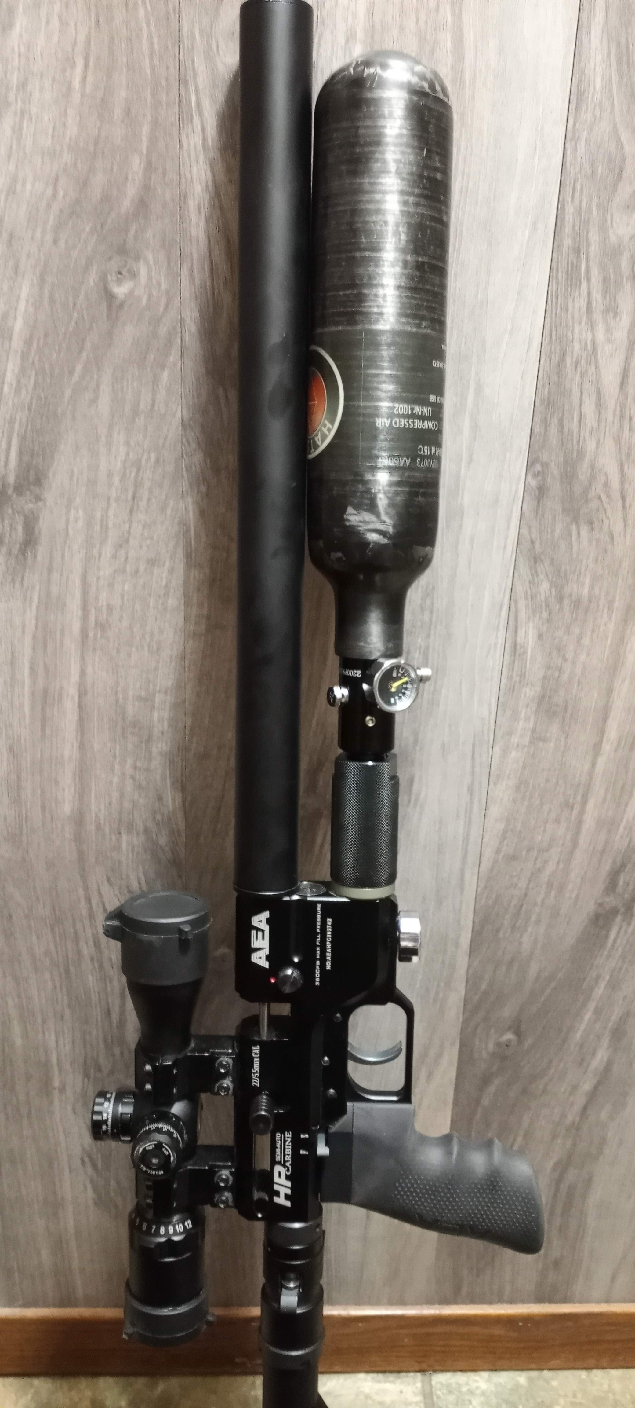

The tank that im using with my 50 caliber gun has a tank thread that is m18x1.5. The regulator that im using is 4500/3000 but it was a generic ebay find and I wanted something more reliable so I ordered a Ninja regulator that says it's for PCP use but the thread is 5/8-18. I'm having a heck of a time finding tanks with the 5/8-18 so will someone please school me on the uses of the two threads. I can't find the same reg with the metric so I figured I'd just buy a tank to match the standard thread.

Just get a tank adapter?
This is a strange adapter. I'm not sure what it's use would be because an adapter fitting the application that I need would be a female/male adapter. That one appears to be female/female.
Not strange at all, its the bridge between the gun (M18*1.5) and the regulator (5/8"-18UNF). The gun is male, the reg is male on both ends.
