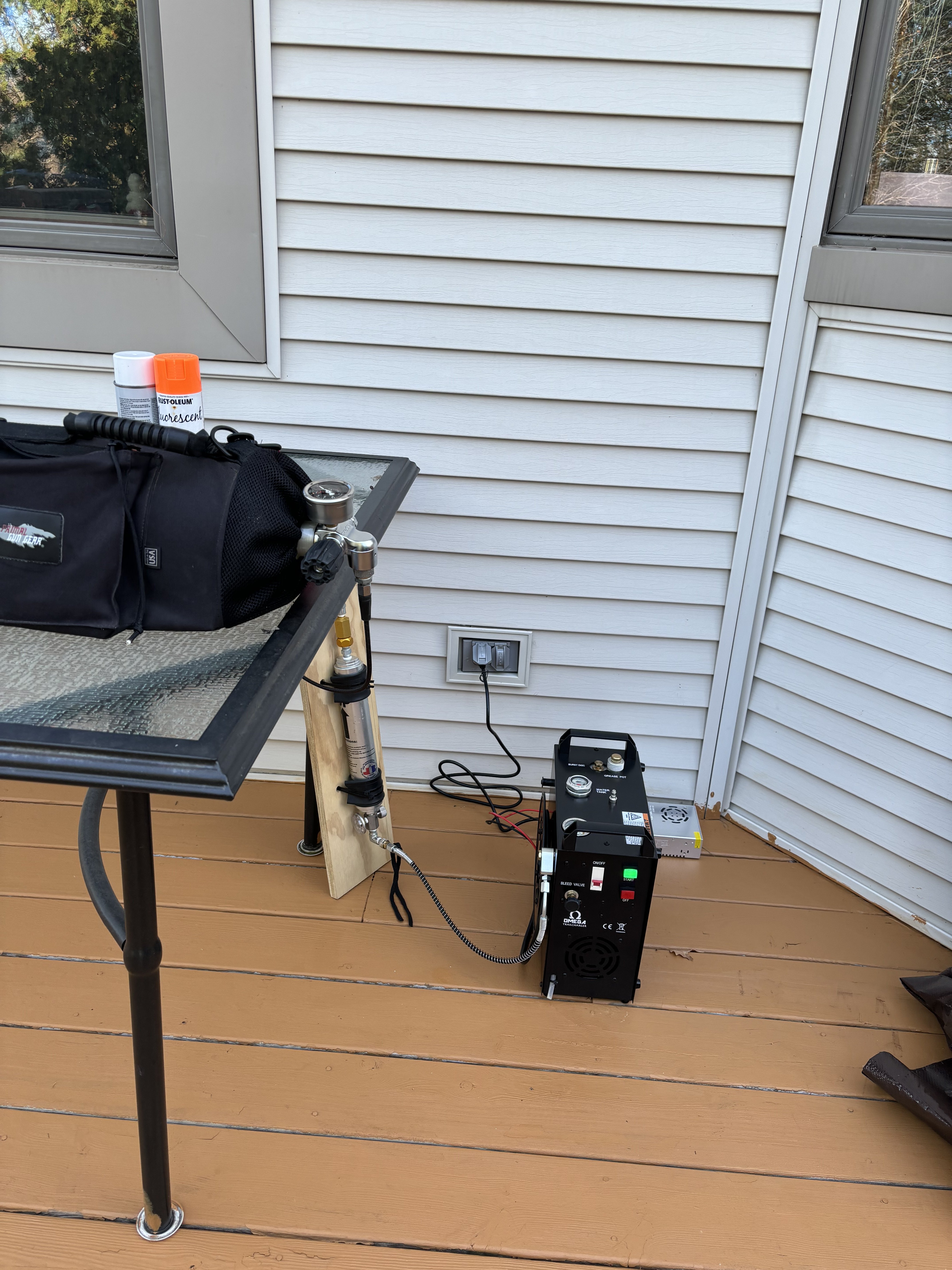

I take the Trail Charger to the range or my friend's house. Haven't tried DC power off of a vehicle yet, always run it on AC. Will fill tanks from 3k to 4.5k. The manual says to run it 30 minutes on, 15 minute cool down, rinse repeat. Very quiet and slow fill pressure, tanks never get hot. Easy to carry around with a sewing machine bag someone on the forums recommended and it works great. Weighs a lot, but with the bag it is manageable. Have been using it for two years now, no issues.
