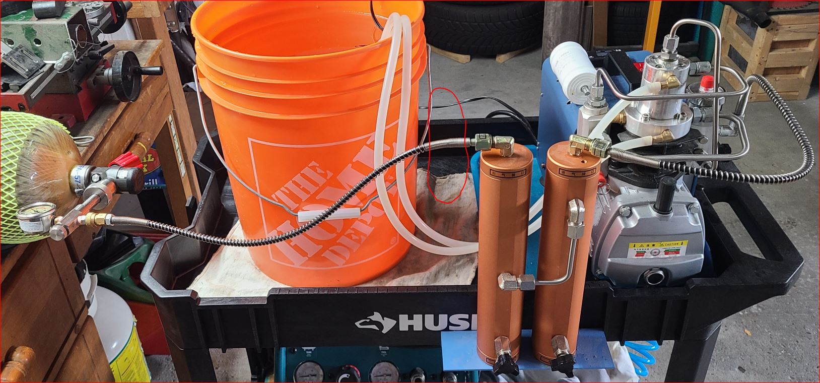

Where did you put the external one way valve inline in your setup? I was tinkering about that but in my setup a logical place would be as I mark it up below, but that would be a difficult fitting thread...
I choose to put one on the input to the fist gold unit (blocking tank pressure from the compressor). My thinking is that I can fill the separators with dry air from the tank before starting the compressor which would stop uncompressed wet air from progressing very far into the seperator/filter. I have no scientific evidence either way.
This way also limits the amount of bleed air/water at the compressor.
