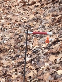

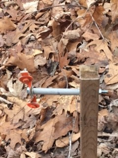

Spinners and gongs. You can buy the NRL22 target package for about $400, comes with a KYL rack, 17 circle gongs and 10 target stands. You could buy individual targets based on your location, like little spinners that screw into tree trunks or big spinners that sit on the ground. It's easier to spot edge hits on spinners without a spotting scope than on gongs, but I would encourage each squad to have a pair of binos. A spotting scope is overkill, especially if you are only going out to 100 yards. I use 10x binos to spot out to 400 yards and they work great. Once you get going, you can mix in some animal silhouettes to make the targets more interesting.
