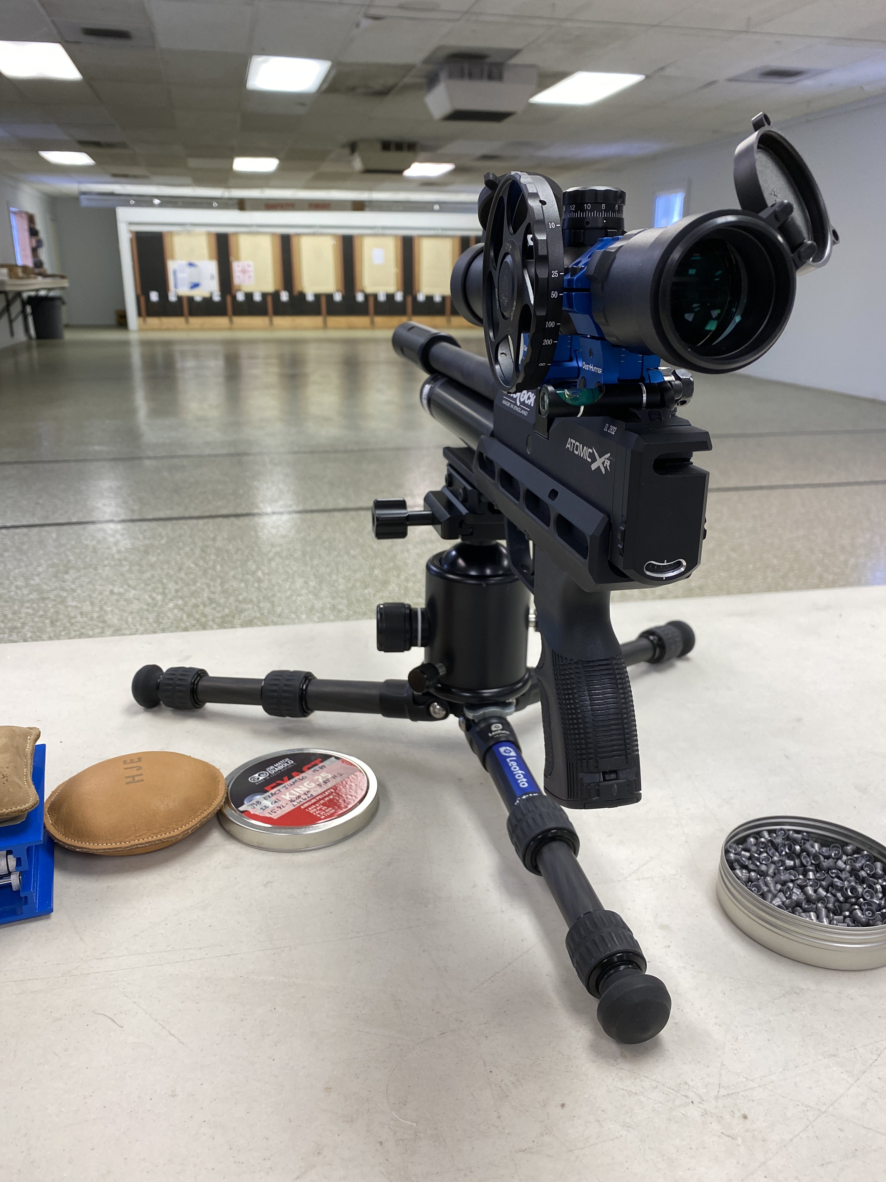

I use a 3-12 power Bug Buster on both my Weihrauch HW44 and my Atomic XR. Granted these are not long eye relief so NRA Bullseye style shooting is out. I shoot pistol off a bench. And I am 79.

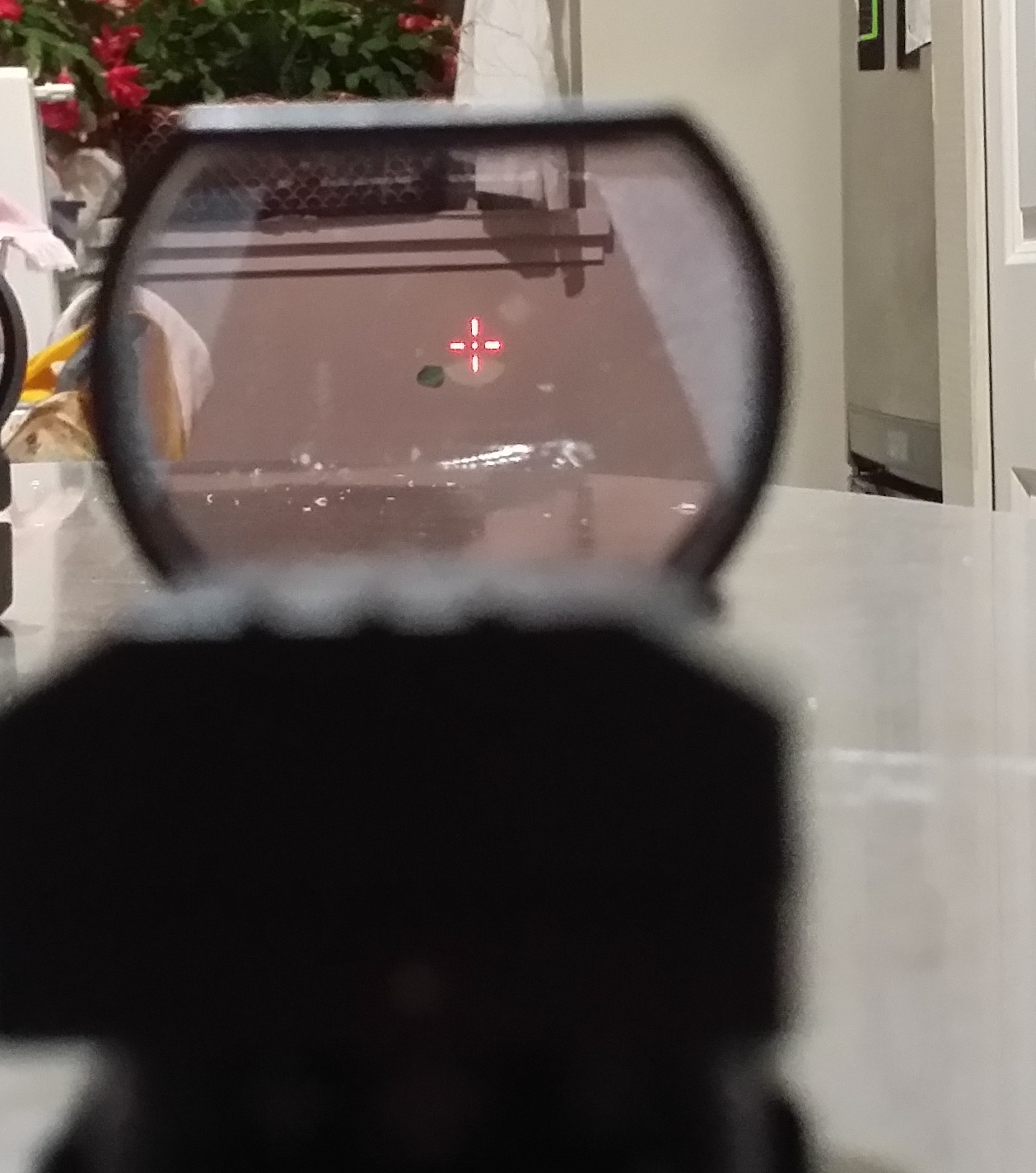

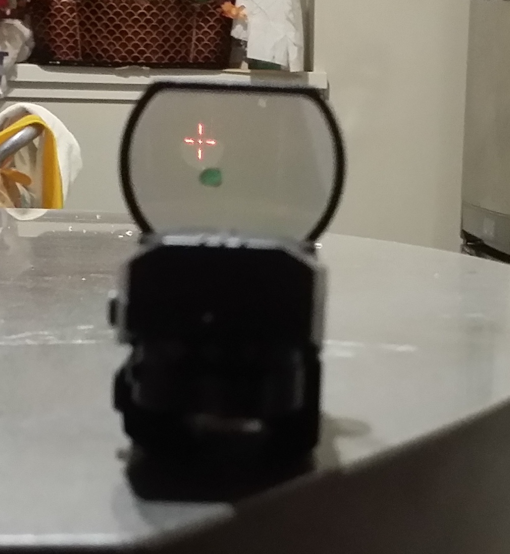

Modified a cheapo red dot and put in a archery 8x magnifier lens and this is the result, its kind a hard to get it on camera but it helps, if i were to do it again, I'll get a red dot that has a side cover as reflection and glare from the sides is bad. Eye relief is not an issue, in fact very good at any distance, the farther the red dot the magnified image is bigger, not overly big but just right.
