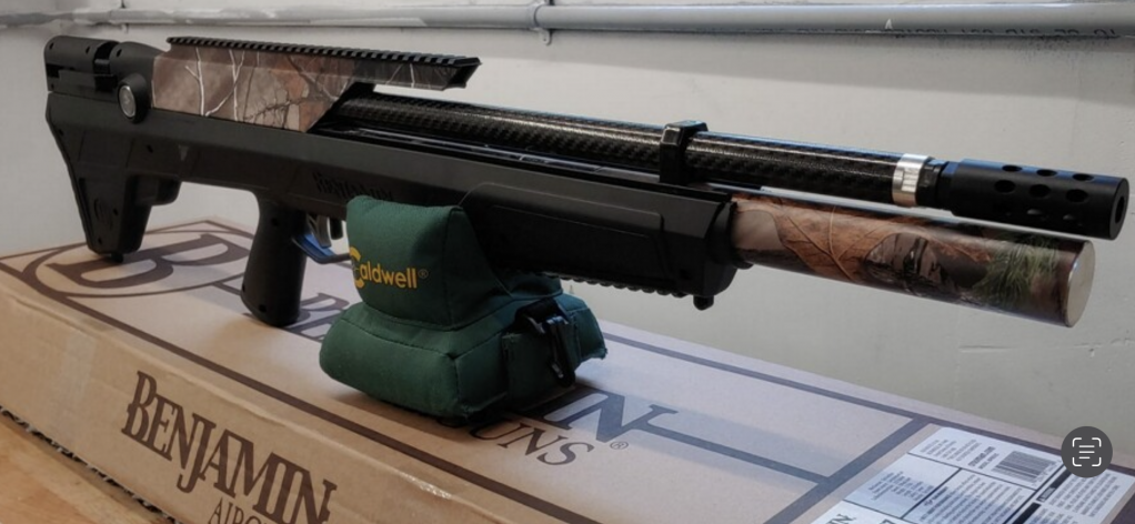

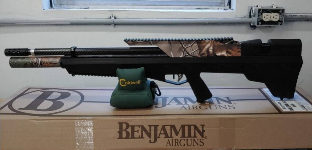

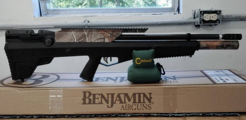

My Taurus Bulldog build by Veradium Air is reaching it’s conclusion. Brian is finishing up the camo on the stock insets and then she’s headed to UPS. A digital snow camo w/painted stock was our 1st choice, but the pattern came in too large and didn’t look appealing at all. The Realtree Xtra is just fine with me. Trust me—there’s more here than meets the eye.
More to come after I have her in my hands….
