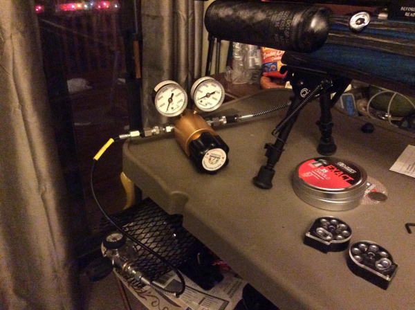

I thought about getting a Huma but read the specs that said it has a DIN connector. All my bottles have SCBA CGA347 connectors and I wasn't sure if I could replace the DIN. I ended up getting the Aqua Environment. I already had a hand tighten CGA347 and put it on the regulator. Also, since I know I will more than likely keep the output pressure at 2700 - 3000 psi I added a bleeder so i don't have to turn the adjustment knob to bleed off the air. All in I paid about $350-360.

What size gauges do you have on your setup? I can’t tell if they are 2” or 4”. If they are 2”, then I would need to buy a couple new gauges or a couple extenders as mine are 4” and don’t look like they would fit next to each other.

Yes it is the 415-6000.

Well, I bought the Aqua Environment valve and a couple 2 1/2” grade A filled gauges. They are all rated at 6000 psi. I am going to leave my fill station intact and add Foster male fittings to both the in and out of the regulator. My hoses are female on each end so I can pop the regulator inline when I want to teather and leave it out for normal use. Once I purchase the 2 male ends and a couple 1/8” to 1/4” adaptors, I will have about $310 into the setup.
